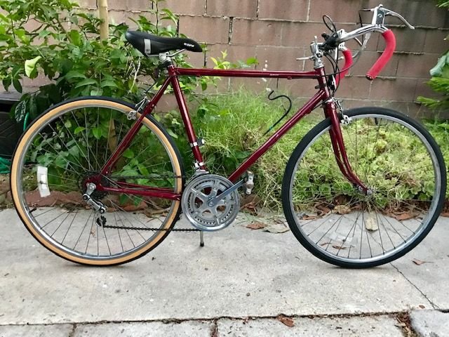

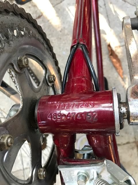

MMMmm..I got an 80's Sears road bike, I guessed it was an FS10, but none of your numbers are near those on my bike, for instance, mine doesn't have any letter codes, but an 8 serial number whose first 3 numbers are "702" followed by a "489" underneath followed by a dot and another 6 numbers... any ideas who would have made this, and dates?

Here it is! I need to descipher this code from my old Sears Free Spirit..

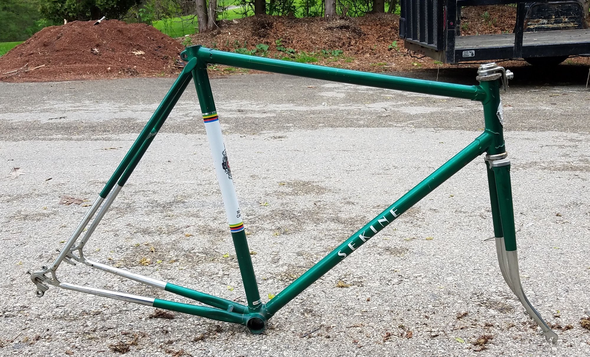

My Sekine SHS frame has a serial starting with X so it should be 1975. Odd thing is there is no space after the letter and number which follows.
Anyway, pics
Anyway, pics
Yes, that should be an SHS frame. All the Sekine models that used the SR Silver crankset had the atypical 70mm BB shell. I'm used to seeing the serial number space between the month indicator and sequential number string. We rarely see Sekine from this period with a longer than five character sequential number string. This plus a place holding zero has leaning me towards a November manufacture. There's bit of disagreement over the Sekine codes, complicated by the facts that there was little model change in the mid-1970s and that the components were consolidated in Japan, instead of being direct shipped from the manufacturers to Canada. Consequenbtly, take the year with a bit of salt. I'd probably just casl it mid-1970s. Thxs for posting.

Originally Posted by 2cam16 View Post
Here you go for the bank, T-Mar:
Fuji S10-S LTD #77L05722
So I'm assuming it's a '78?
Yes, given that it was manufactured in December 1977, I'd assume it to be a 1978 model. Thxs for the contribution.
