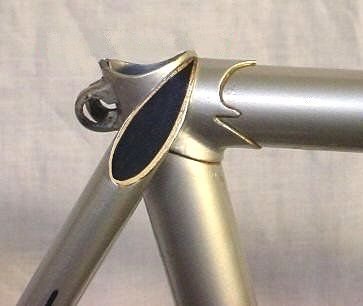

the machine's bottom bracket assembly must be quite the dog's breakfast if one goes by the four or five threads showing on the adjustable cup
Chas. (verktyg) hath writ that this lug design be proprietary with MB - not found in any lug maker's catalogue

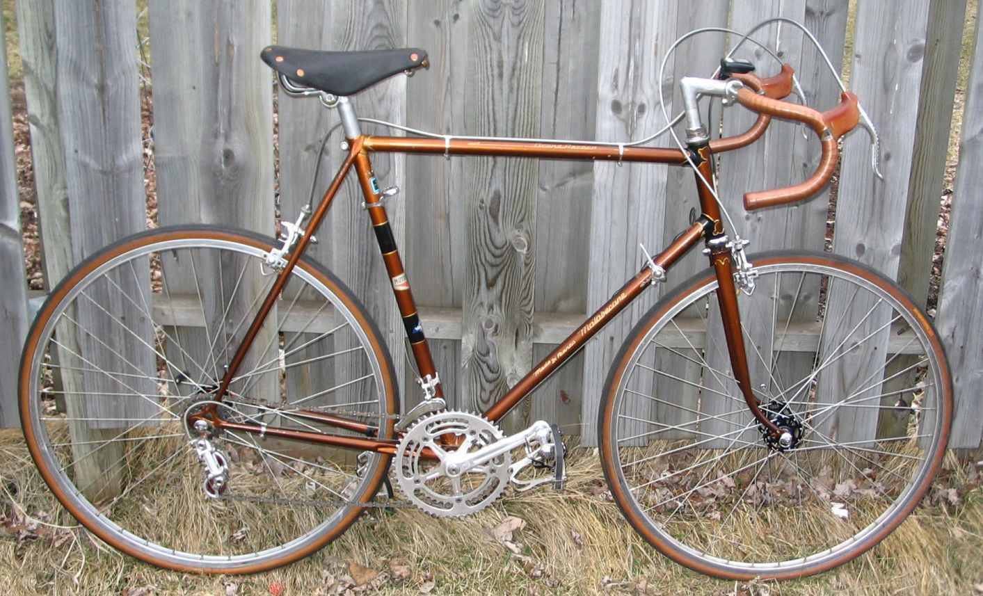

Not sure how you would discern between a Le Champion and GR frame set. My 1972 has different head lugs but still has the semi wrap SS's. Don't know the diameter of the seat post but it is a 531 DB frame set. IIRC it is a metric version of the frame set for Moto.
2008-06-07 15.42.52, on Flickr

Le Champion vs. Grand Record Lugs

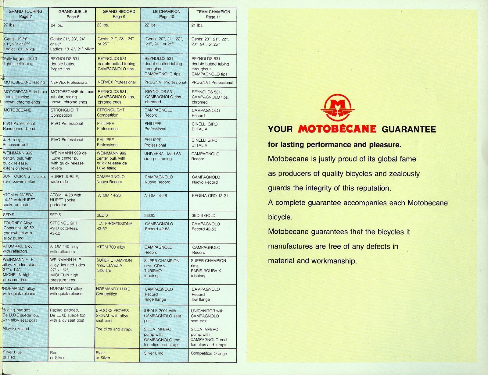

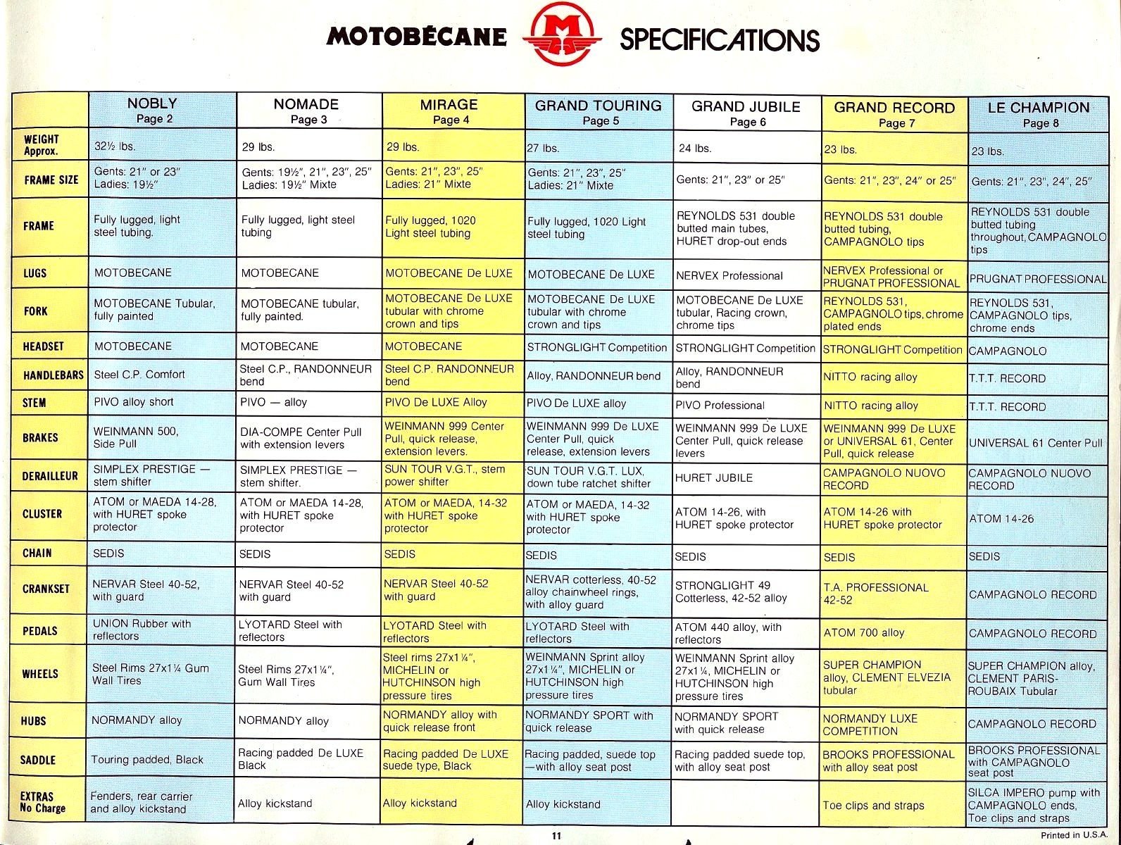

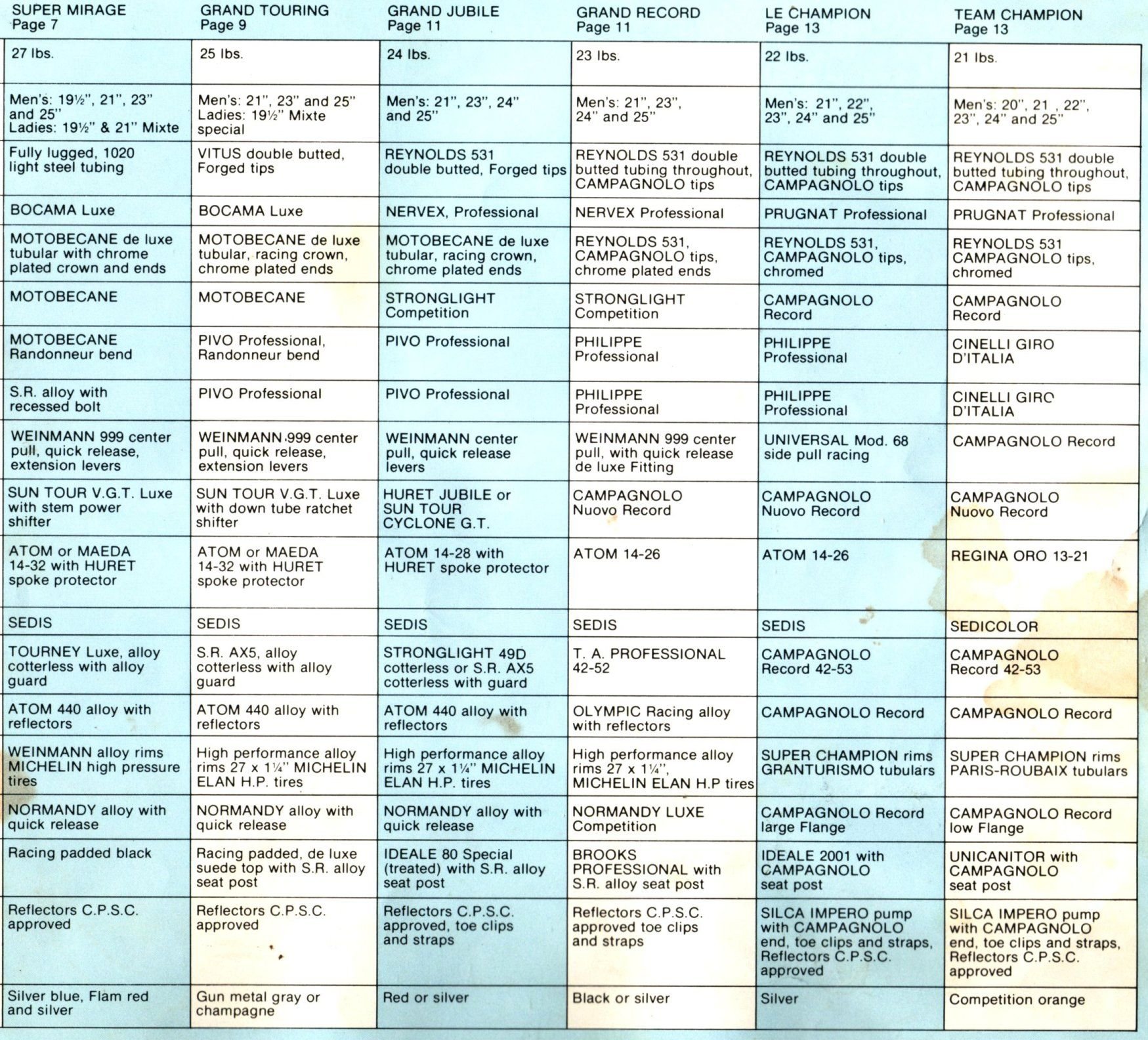

From the beginning to the mid 70's Le Champion frames used long point Prugnat Type S lugs like the ones pictured above.
My 1974-75 Le Champion with those same Prugnat lugs. In 1974, Motobecane seriously upgraded the Le Champion frames. They are the same as the BIC orange 1974-76 Team Champion/Champion Team frames including Fischer? fork crowns.
In 1977 they lowered the frame quality in a lot of ways. They continued the trend until the early 80's. My 1977 Le Champion with Bocama long point lugs.
Grand Records came with proprietary Nervex lugs until the late 70's. The early 70's bikes came in silver and black or yellow and black. They were only 3 main tubes butted Reynolds 531 (3 TUBES RENFORCES); the forks and stays were Motobecane gaspipe tubing. They came with Campy dropouts and fork ends.
Repop sticker from Cyclomondo.

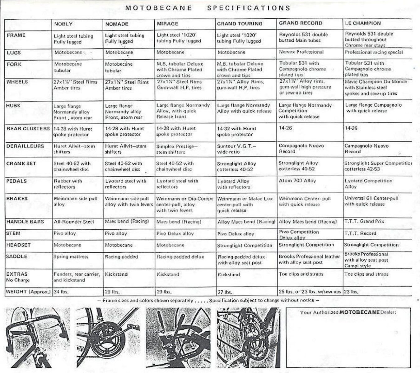

In 1973 Moto did a major upgrade to the Grand Record bikes. The frames became all Reynolds 531 with 1/2 chrome plated "socks" on the forks (the Le Champions had chrome socks on the rear stays in 1972-73). They also introduced the elegant black with red trim color combination but silver and black was still available.
1974 Grand Record catalog page.
Here's a rare early 70's brown and black Grand Record, probably a European model??? Someone has upgraded the components with Campy cranks and DuraAce brakes and hubs.
Here's another rare Grand Record with long point Prugnat lugs instead of Nervex. Probably a 1973 or 74 model. It may have been a Le Champion frame labeled Grand Record at the factory just to fill out an order???

Originally Posted by verktyg
In 1973 Moto did a major upgrade to the Grand Record bikes. The frames became all Reynolds 531...
I don't think so. I believe the only full 531 GRs were in '76 and '77. The Bulgier catalogs also reflect this.
I have a '75, and I can tell the rear stays feel "heavier" than any of my other 531c bikes.
SurferRosa is offline
Old 11-04-19, 06:53 PM
verktyg
verktyg
verktyg's Avatar
Posts: 4,030
Mentioned: 207 Post(s)
Quoted: 1036 Post(s)
Liked 1,238 Times in 654 Posts
Nope: From 1973 on Motobecane Grand Records had all Reynolds 531 frames... well not all Reynolds tubes, the fork steerers, brake bridges and chain stay bridges were made of gas pipe carbon steel!
In 1977-78 they switched to French made Vitus 172 butted tubes on the Grand Records (the tubing cost was less than 1/3rd of 531 with about the same weight and strength).
1970-72 Catalog Spec Sheet
1973 Catalog Spec Sheet
1974 Catalog Spec Sheet
1975 Catalog Spec Sheet
1976 Catalog Spec Sheet
1977 Catalog Spec Sheet
Having built frames and worked on many pro bikes over the past 45 years it's hard to tell what most frames are made of just by feel...
For example, most French, Italian, Dutch and so on PRODUCTION frames made with Reynolds 531 tubing had main tubes with 1.0mm wall thickness in the butted ends and 0.7mm thick in the thinner sections. Schwinn Paramounts were made with those tubes. Even a lot of Pro Team Bikes used that tubing up into the 1980's.
One reason was that the thicker tubes allowed for the use of lower skilled employees because over heating the tubes was less of an issue.
There were several reasons for Pro Team Bikes being made of the thicker tubes: crash survival, resistance to denting by rough handling by the support folks and more importantly, Team bikes were handed down to lesser riders after the end of the race season so the were used for multiple years.
Only the top riders got new bikes every year! After the early 80's, with the likes of high $$$ riders like Greg Lemond, things changed a little.
Used team bikes were also passed down to the young riders on the pro development teams (farm teams).
A lot of Brit frames were made with lighter gauge Reynolds tubing but that was different story.
Reynolds 531c (Competition) was a lighter tubing set. It wasn't introduced under that name until 1982. Prior to that it was called 531SL or 531 Special Light Weight (EXTRA LEGER in French/metric diameter tubes).
The seat and top tubes were butted 0.8mm x 0.5mm and the down tubes were 0.9mm x 0.6mm. The forks and stays were also thinner gauge.
1984 Reynolds Tubing Spec Sheet.
I used some 531SL tubing back in the mid 70's and it was noticeably lighter than the standard 1.0mm x 0.9mm tubing but then I was working with the stuff.
My 1972 Le Champion was made with the lighter gauge 531 main tubes but it was the top of the line model. It takes a 26.6mm seatpost rather than the standard 26.4mm posts used on the 1.0mm x .07mm metric tube production bikes.
verktyg
Chas. ;-)
I missed this the first time. Probably important to remember, Astra - arguably a "Motobecane", they made them for Beacon, if I recall? - also had these. This Grand Luxe wasn't available when this thread started, so I couldn't link it and was too lazy to hunt for pics: https://www.ebay.com/itm/184039779862
