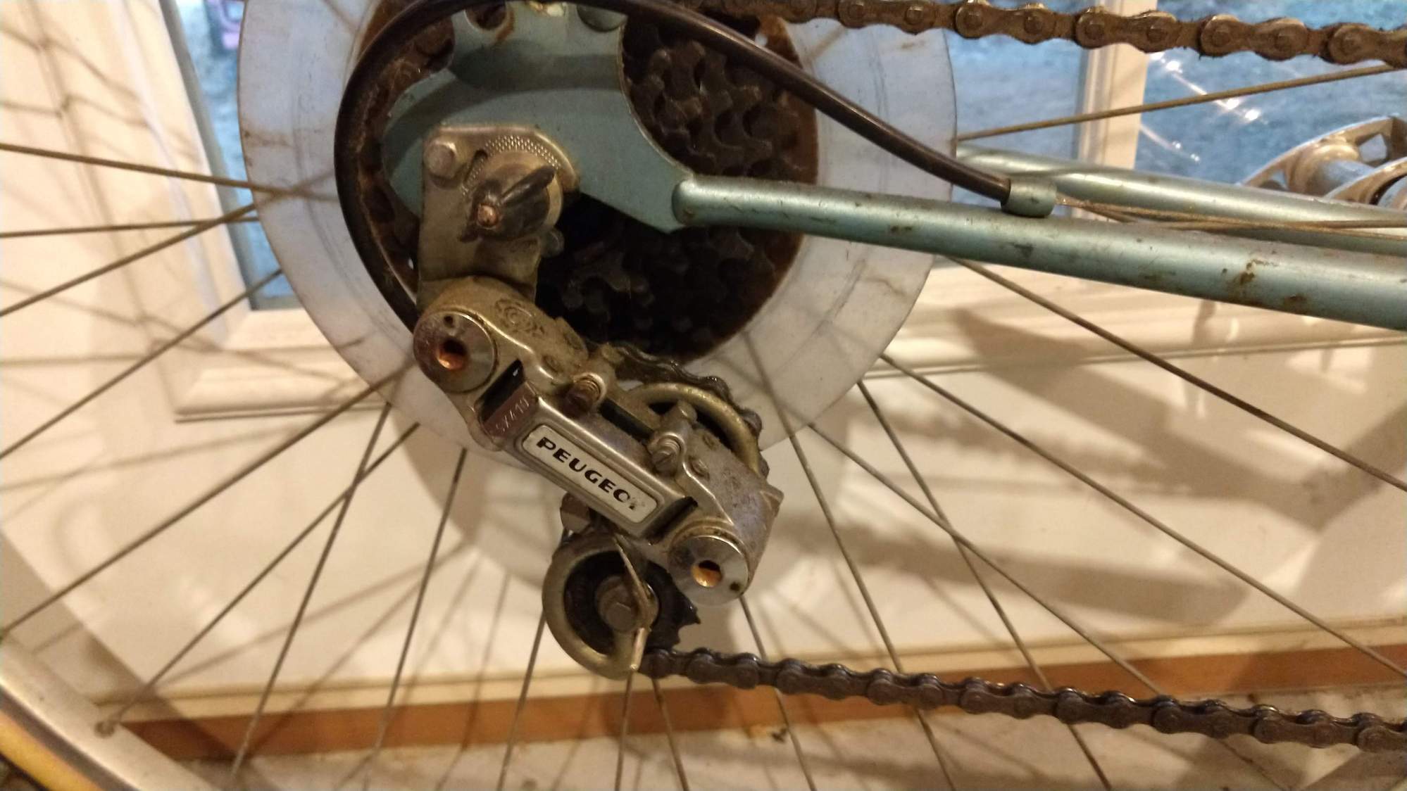

It seems to have an Atom "compact" 6-speed freewheel (it appears to use the 5.0mm sprocket spacing) that turns with some drag, but it's free. The rear frame spacing is 120mm, and the hub OLD is 124mm. Would you guess this freewheel is French-threaded, or is it likely to be British-threaded?

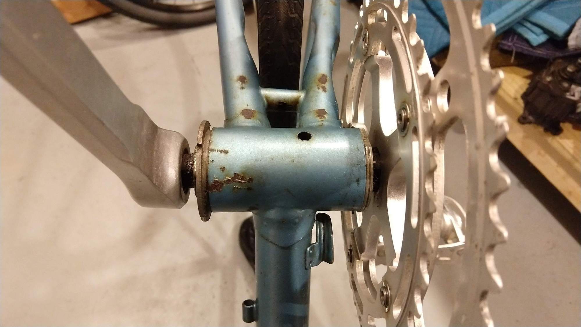

There is no serial number on the bottom bracket shell, but dropout seems to have one stamped there. It starts with "B1" and has a total of eight numbers, which I think confirms a 1981 model, yes? The seat tube measures 23.5" center-to-top, which appears to be their 60cm model. I would normally think this would be too large for me, but it seems to work.

That SX410 derailleur (and the step up 610) is actually pretty damn solid. But the teeth on the pulleys can be very brittle and break. Exercise caution when removing and reinstalling the chain, any sideways torque will break a tooth.
Also be aware, you need to be careful with your shift cable selection. The holes for the cable end on Simplex shifters is unusually small. But on the plus side, there's a super cheap $9 kit with all the brake and shift cables and housings you'll need and it's the correct side on one end for Simplex levers, and it's under $10 on Amazon. More info here: https://www.bikeforums.net/19631678-post10.html

This is what I would expect, too (a serial number on the shell), but it's definitely not there (even after cleaning all the grime off). Just a lone, un-centered, drain hole.
I don't disagree with this potentially being a PBN10.
Yeah, the derailleur seems stout. Thank you for the warning on the pulley wheels and the shifter cables.

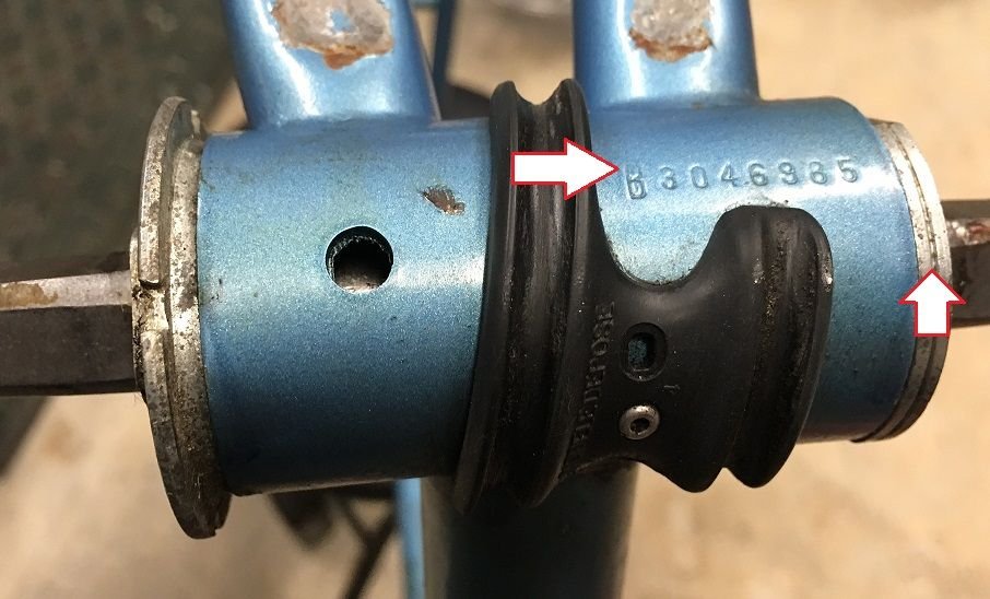

Attaching an example of a 1983 P10S I restored for a coworker a few years ago. This one used the graphics that started after '82, after the checkerboard design on yours. Anyway, two points about this.
1) Sideways arrow points to the serial format. Notice similarity to yours. This bike frame I'm showing was popped out in 304 aka '3' year (1983) and '04' month (April).
2) Upwards arrow, you see that line through the side of the fixed cup? Yours has same. Every cup I've ever removed with that line around the rim is Swiss-thread. A lot of people screw up, a British/ISO thread cup WILL screw in, but WILL NOT seat flush or stay in correctly. I've had people fight/argue this point with me on the forum but I can point to threads where others confirmed it was the case on their own bikes after being told otherwise.

Interestingly, your '83 model has a B + 7 numbers. My presumably '81 model has a B + 8 numbers. Yours is 3 04 + serial number 6985. Mine is 1 02 + serial number 48441. I know the numbering on these Peugeots is inconsistent at best. Maybe different models or frame materials (PBN10, PX10; or Carbolite 103 vs Vitus 181 vs Reynolds, etc.) had different serial number formats. Perhaps they figured they'd build more of the less expensive models.
It's always pretty consistent one way or another, not as gibberish as systems other French companies like Motobecane used. Most commonly through the Peugeot '80s bikes it's [Letter][3-digit#][4-6 digit#] where the letter can be anything but very commonly B for earlier years I've seen and Y for latter years, 3-digit is YMM for Year and Month frame was made, and the latter 4-6 trailing is the sequence of manufacture/frame# of that YMM. Location of the stamping was random maybe depending on whether cable guide existed or not, and on many of the '80s bikes you'd find a white piece of paper with the model name, size in cm, and serial number taped to the top of the chainstay, sometimes it ended up on the BB shell. It's always nice when those are still around.

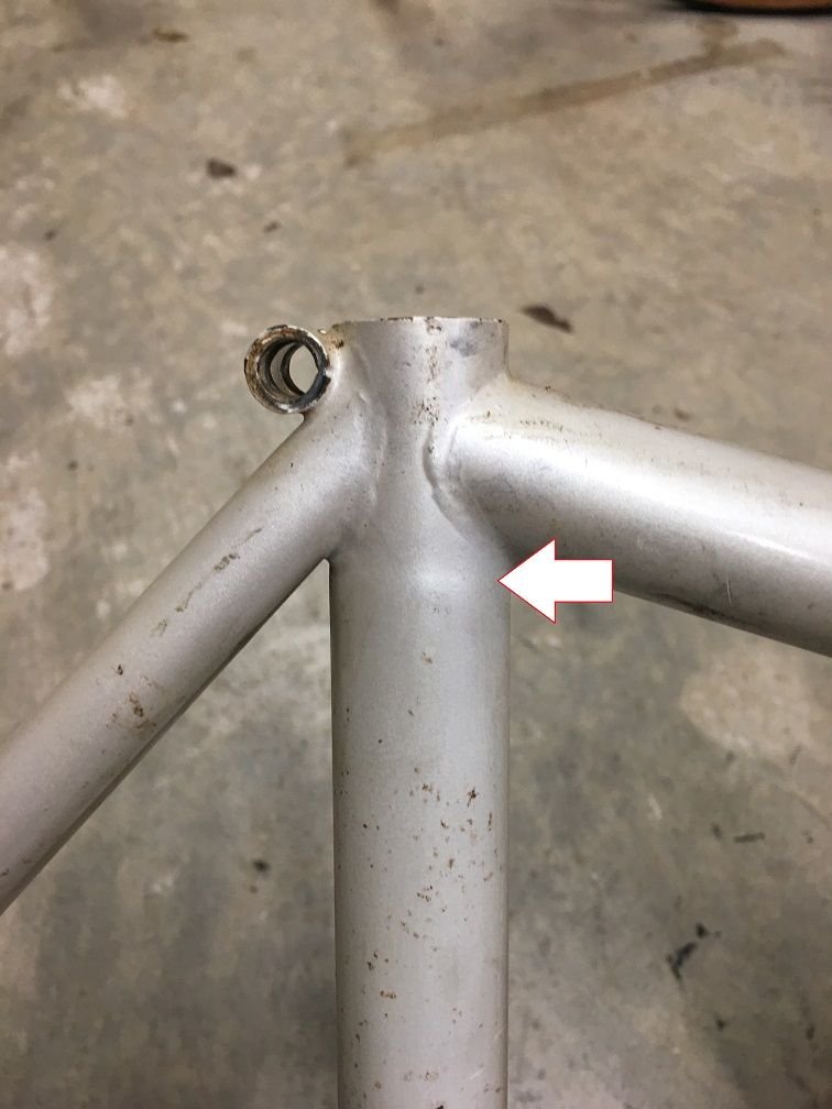

No shim per say, the seat tube in vicinity of post clamp and juncture with top tube measures 26.4mm; below clamp area seat tube measures 28.4mm. this seems to jive with Jody Lee's observation of straight walled Carbolite 103 tube thickness of 1.2mm, as noted on his site.
https://peugeotcoursepb12.wordpress....-assessment-3/

Thanks for the measurement on that. My seat tube is a consistent 28.2/28.3mm (depending on where around the circumference I measure the diameter). Your observations are consistent with the comment from @francophile regarding a "necking" of the seat tube up near the clamp. As far as I can get my caliper up against the lug there, I can't get less than 28.2mm. And that does explain my 25.8mm seat post. 28.2 - 2*1.2 = 25.8 on the nose.

Here's what I'm referencing on a lugless frame, where it's easier to see.
This reduction is present on many (all?) of their Carbolite frames, although I can't necessarily see it on the '81 P8 "Sport" variant in my shop at the moment a friend wanted me to work on, but maybe I'm not looking close enough (it had a steel seatpost similar to what the U08 Mixtes have).
The tubing walls on this example appear slightly thinner above the reduction than below. This is on one of the Tourmalets in my shop for rebuild right now, I think it's an '86.
Hopefully it's clear.

Yes, I can see the taper there. I'm pretty sure mine doesn't have it...that, or it does and the wall thickness really shrinks because I definitely have a 25.8mm seatpost in it!
In other news, I looked some more at the frame and where the tire clearance bulge in the seat stays are positioned. It really seems like the basic frame dimensions are such that the axle should be shoved all the way back in the dropouts (without a derailleur claw) because, in this position, the brake tracks fall just at the trailing edge of the bulges and the meat of the tire, the widest part of the casing, lies pretty much centered. With this position, I can pretty easily fit a 32mm tire. "Okay," I thought to myself, "maybe I can just have a derailleur hanger tab tacked or brazed to the bottom of the dropout tine, so I don't have to use the claw."
The obvious next step, for a rookie like myself, was to further examine my Simplex SX410 derailleur and see how the main knuckle mounted to the claw. I then committed what is apparently an irreversible sin in Simplex derailleur parlance -- I touched that mounting bolt that also indexes the spring to the body. As soon as I twisted it slightly, I heard and felt that spring unravel. "Crap". I fiddled with it some, but it's clear that I'm not getting that back together without some more research on The Trick to doing that. My mission was to see if I could just unbolt this claw and bolt the derailleur up to a different hanger...in that case, I would have considered having a Simplex hanger brazed on and would direct mount this to that. Oh well, more research needed on that.
All that to say, if I do indeed eventually braze a derailleur hanger on this thing, it would likely be a...Shimano style hanger with the B-tension screw tab. For now, it has a cheap and heavy and old Shimano TY-something on there that I keep in my parts bin for situations like this. I need something to move the chain, and this'll do for now.

Yes you just committed the cardinal sin. There is no reason for most people to ever touch that front hex bolt.
In fact, on some derailleurs like the Simplex Criterium, they put red plugs in the hole to prevent people from doing what you did. You always use the bolt or hex opening hidden on the back/wheel side of the dropout to remove the derailleur.
Basically you just stripped a piece internally which is required to hold the derailleur tension in place. Read this thread. https://www.bikeforums.net/classic-v...0-problem.html
Chances are you rounded off the flats on the mounting bolt. It's also possible (but unlikely) you snapped the spring. Good luck!! It can be fixed. You'll be taking off your chain and removing the RD totally.

Yeah, everything was already off the bike. The spring doesn't appear to be snapped, but it also doesn't seem to "catch" into place to reassemble it. I'll check the internets (thank you for that one link) and see what I can do to get it going again.
The front derailleur had already been replaced with a cheap Shimano, so I may just try to find a nice vintage-looking pair of derailleurs, like older 105, 600EX, RSX, etc., and call it a day.

Pop out the pivot bolt. Look at this pic and notice the "flats" on either side of the nipple at the end of the "Prestige" bolt: https://c3.staticflickr.com/9/8561/2...6545f42e_b.jpg
Make sure of three things: (1) The edges of that flat aren't rounded, (2) the washer it interacts with aren't rounded and (3) take the bolt and its corresponding washer and insert one into the other, it shouldn't be able to spin at all, the flats should lock it into place.
