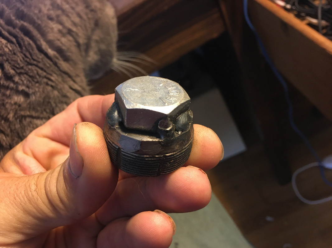

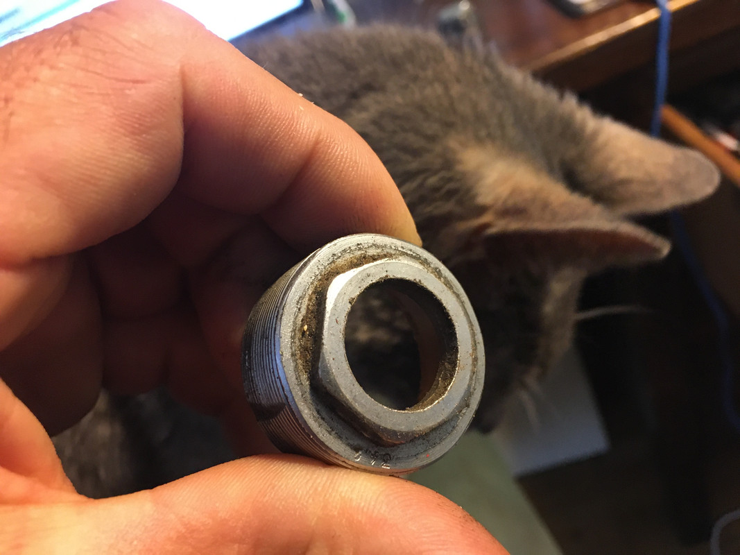

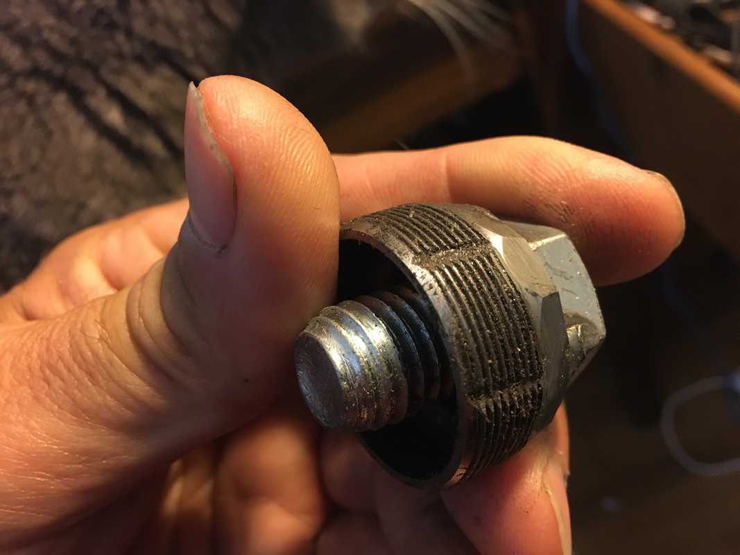

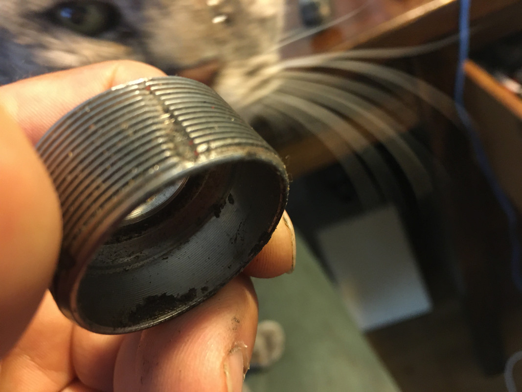

The Raleigh BB shell steel is not very hard, the BB Cups cut the threads just fine. I made 6 groves in the cups, paying particular attention to keeping the cutting edge perpendicular to the threads like a proper tap.
Fixed cup side, I ground off the flange so it can screw in and out further,
And a bolt that I welded to it so I can spin it in and out with a drill repeatedly,
Adjustable cup,
Adjustable cup already had a big hex on it so no need to weld a bolt to it,
I rarely use these, I'll gladly tune up the "cutting edges" and mail them to you to use if you like, but you have to return them!!!!
