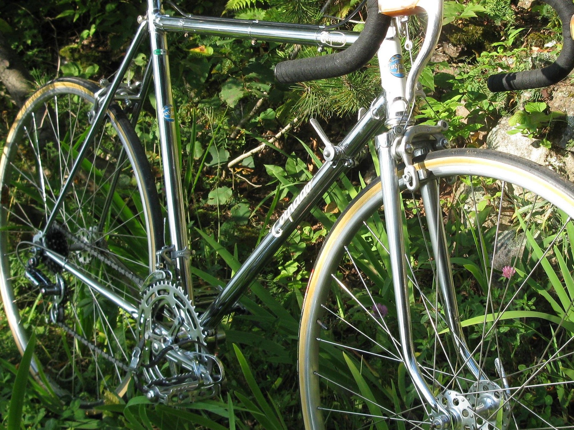

Kind of got seduced by a very original `50`s racer that was lurking in Italy, figured it was time to an older vintage bike to the collection so went ahead and picked up this 1953 Torpado Gran Sport. Bike was very original, you could tell from the same rock hard grease on all the internals that it had been in a hot shed for most of the last 60 years. Condition was good and bad - parts were all there, campy gran sport, magistroni cranks, universal 51 brakes, campy hubs with nisi rims, ambrosio champion forged stem and bars. Alas the paint was no good - rock hard and chipped in some place, flakey and off with your fingernail in others, plus the chrome was very pitted and rusty. Plan was to fully strip, re-chrome, paint and assemble with as many original parts as possible - alas the seat post and seat were shot (replaced with campy 2 bolt and period brooks b17), the rims were splitting between the eyes so good period nisis rims were sourced and re-laced with new spokes and veloflex tubs, plus new consumerbles such as bar tape, hoods, wires, pads.
Frame was stripped back to bare metel and polished before chroming - nice little columbus stamps on the steel under the paint, decided to keep the rear quarter and the forks chrome, with chromed agrati lugs on show as per original.

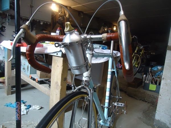

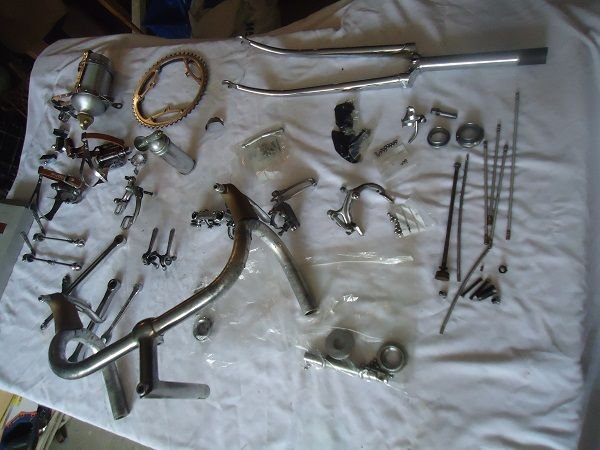

As arrived - kind of bought it for the original bottle hanger...
As finished:

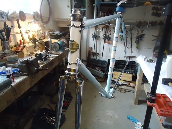

Painted frame - I painted it with 2k, stripes are paint, tried to mask and paint the torpado logo but went very wrong and went for decals instead.
Parts all cleaned and ready for assembly:

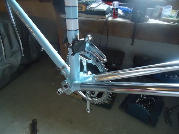

Bottom bracket went in nicely:
Forks and headset took 2 goes to get a good fit - don`t ask...

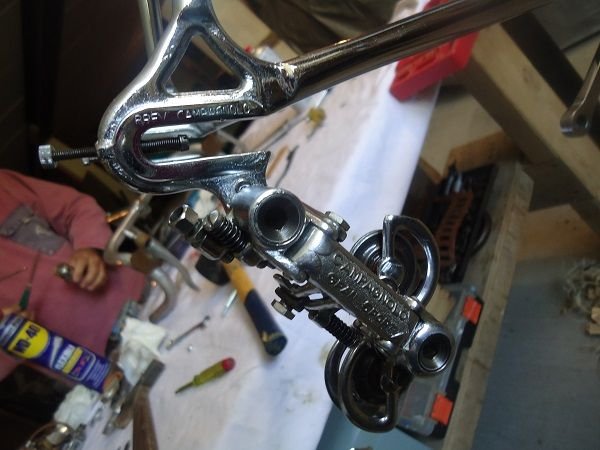

Front derailier and cranks go on:
Gran sport derailier was a joy to work with:

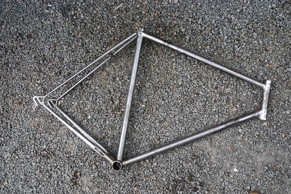

Out of sequence bare frame pic:
Polishing up the lugs:

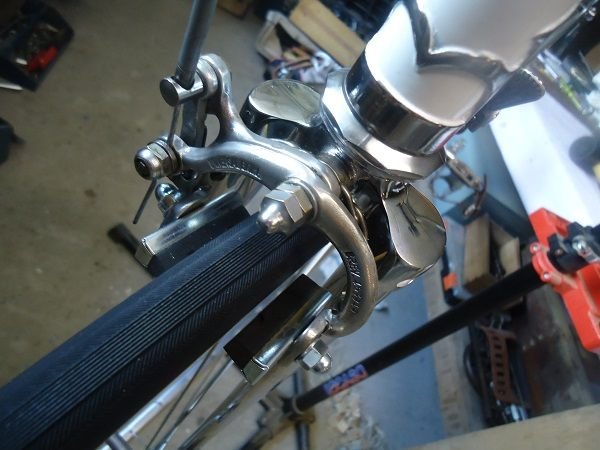

Universal 51 brakes, side pull with the release levers - really good but pads are too hard:

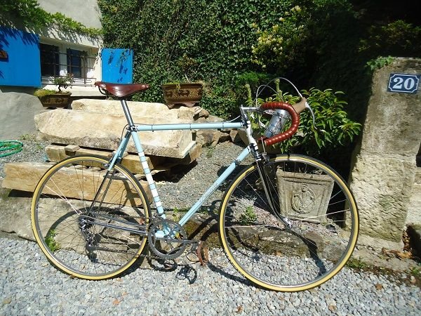

Finished:
Nice...
Test ride - very itchy torpado wool top...
The ride is first class, very smooth, not twitchy, brake pads are hard and will need replacing (although they are new) as the brakes don`t really do anything, campy gran sport is just a joy. ***Word of warning - 2k paint takes an age to harden, still softer than I would like after 3 months*** I`ll weight it and let you know, feels around 10 kilo, 22.5Ibs.

Who painted it so beautifully?
What's it ride like? Long wheelbase?
What's the little port in the bb shell?

The Rampinelli bottle holder is a great item and quite valuable.
Find meself wondering why you chose to assemble the chainset with the fixed bottom bracket cup on the non-drive side.

I took on the painting myself - my regular painter didn`t want to tackle the seat stripes - can`t blame him really, masking those was almost a days work... paint is Torpado`s Celeste - not as minty as Bianchi`s but with a little pearl the same, came out really well in the end.
Can`t rememebr the wheelbase but its very stable at speed and great at downhills, would have preferred a longer stem but changing the original was not an option.
Little port is for grease - there`s also one in the steerer tube, seem to have misplaced the 2 chrome screw caps for them...

BB shell just wanted to go on that way round, adjustable shell wasn`t liking the offside thread so went with what worked.

Just replying to Juvela - can`t seen to get the "quote" reply to work today...
i too was immediately struck by the absence of eyelets. in my recollection the trend for eyelet removal and of manufacturers producing road end sets without eyelets tends to begin around 1974.
afaik Campag did not offer the 1010 ends set without eyelets at this time. many other forum members are far more knowledgeable on Campag than meself so perhaps they con contribute some information on this topic.
if they were removed by Torresini during or prior to the manufacturing process there might be some trace on the edges. otoh the ends would have had to have been polished prior to plating...
there is a currently active forum thread concerning the identity of a 1960's era Italian frame whose 1010 ends set also exhibits no eyelets. it is not in original finish and has no chrome which makes the eyelet question rather grey:
https://www.bikeforums.net/classic-v...rer-frame.html
is there a model marking on the Magistroni chainset? L. Senior perhaps? found it interesting that the fixed cup shows a smooth flat face. on the higher model sets from the maker the fixed cup is more 3D, exhibiting a groove and often writing. is the adjustable cup the pin hole type or is it the raised hex type? the spindle ends appear to be hollow. me guess would be that the spindle is not hollow all the way through and the hollowness goes in about fifteen or twenty mm at each end. what is the marking on the spindle's centre section? does it read L. Senior for example? were you able to reuse the beautiful high quality wedgebolts or was it necessary to fit ordinary modern replacements? vintage Italian ones can be most handsome with their high degree of polish, bored heads and false acorns with colour coordinated inserts. this is a challenging item for restorers to get correct. chainset is not shown clearly in any of the images; wondering if it is one which employs Y-adaptors.
here is the "show us your Torpado" thread [all Torresini products are welcome, regardless of how badged, according to the host]:
https://www.bikeforums.net/classic-v...r-torpado.html
Torresini history note -
forum member T-Mar recently posted that Agrati-Garelli purchased Torresini in 1983. this made me wonder what, if anything, they did with it. Agrati seemed to discontinue the manufacture of cycle fittings ca. 1983-85. Agrati-Garelli continued on with their motorbike business.
The crankset is Torpado marked, thin cranks with center relief, 3 spider arms each joining another thin twin arm leading to the chainring - typical of most I`ve seen on early torpados - there`s one on ebay i think.
BB cup is the simple version with the holes in it for adjustment, bb is solid with wholes at the end, marked "C" which I assumed was just for campagnolo - new I should have taken more pics...
Re-used one original cotterpins, the other was seized real bad, LBS had to rreally work on it to remove it as I just didn`t want to hit it that hard.
