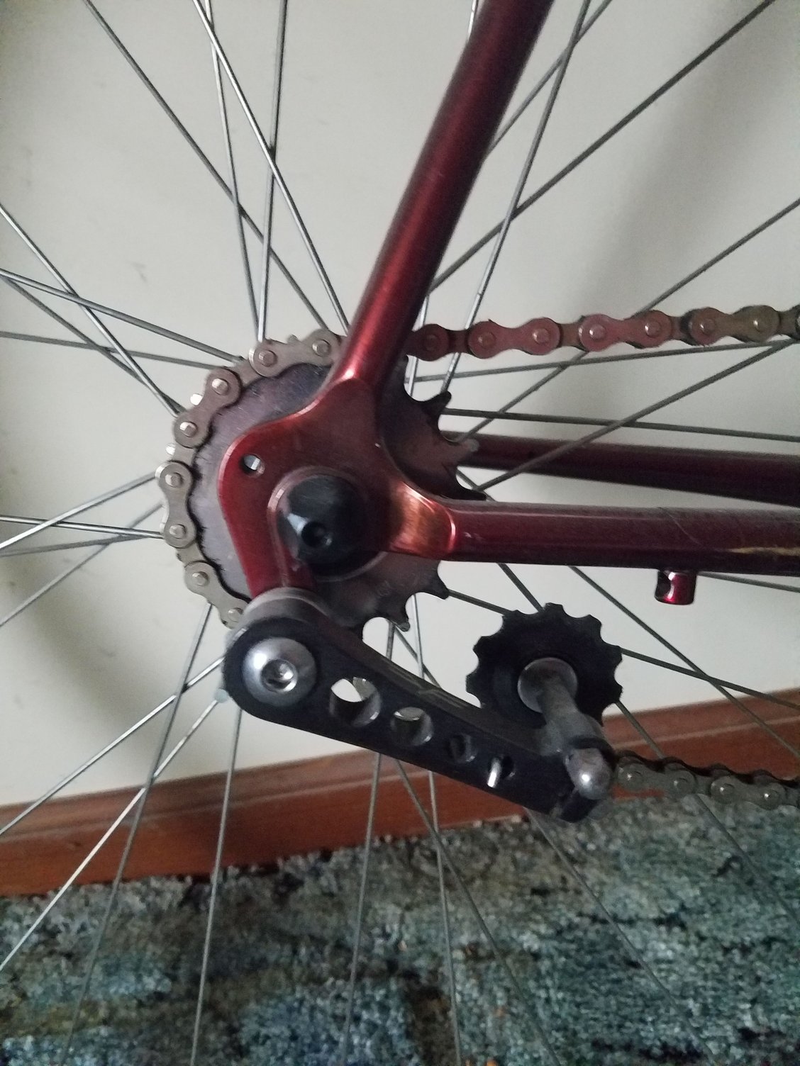

Myself, I have a few single speed bikes. A couple of them have the horizontal dropouts but another is a conversion with vertical dropouts. I use this tensioner from Bike Nashbar. It works great.
