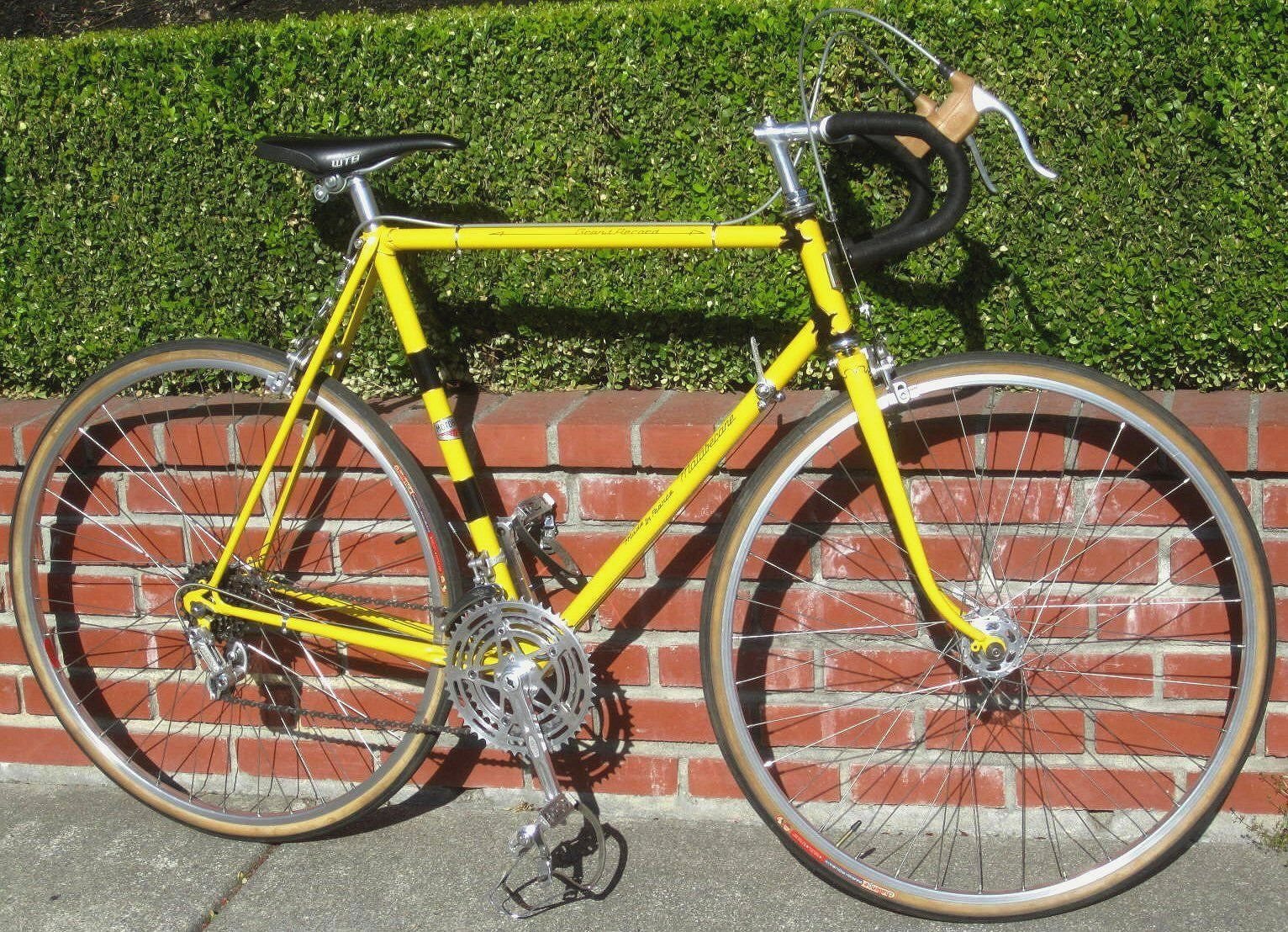

Mystery Frame - 54cm
I bought this frame several years ago and built it up for my lovely wife, but she didn't like it, so over time it shed parts for one project or another. I'm never going to use it, so am moving it along. I found this frame on eBay and built it up for my wife as a five-speed around-town bike. She didn't like it, so it's been hanging in the basement for probably two or three years. Parts slowly disappear from it for other projects.
  • I have no idea of the builder.
  • The bottom bracket is French threaded, while the steerer is British threaded.
  • Campy 1060 dropouts, don't recall the fork ends, eyelets front and rear
  • Plated head tube lugs, fork crown and fork socks (doesn't look like chrome to me, but perhaps)
  • Dimensions (CTC, where meaningful):
    • seat tube - 54.5cm
    • top tube - 56cm
    • chainstay - 41cm
    • wheelbase - 101cm
    • bottom bracket drop - 6.5cm
    • standover - 82.5cm/32.5in with 27mm Veloflex Vlaaderen tubulars.
Here's a Flickr album which documents the frame's various stages of my stewardship. It comes with:
  • Pletscher rack (note the extra bridge above the brake bridge)
  • Tange Levin CD headset
  • Shimano downtube cable guide
  • Anpi seatpost (Spanish Campy clone)
How about $80 + shipping? PayPal f/f to skip.montanaro@gmail.com.
Here's its current state:

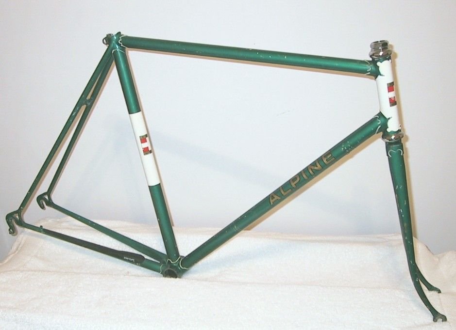

Dropouts made me think of Stella.
Sugino Mighty chainset seen in flickr images made me think of a MICMO product.
Doubt rack bridge OEM.
Builder finished shell very nicely.
Joinery of stays to dropouts rules out a number of French marques. Stella might be a possibility. Fork crown is Vagner DL.
Have never seen Stella employ this lug pattern however...

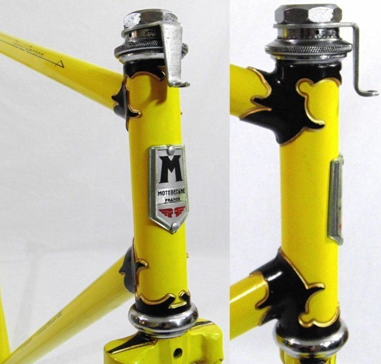

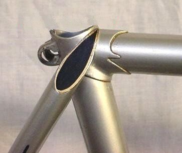

"void" on seat binder ear is a notch to accept the tooth of on a binder head. does not appear original to lug.
one check you have not as yet mentioned is head tube interior to see if there is any evidence of headplate fastener holes being filled in.
ends -
dropouts are Campag Racing Nr. 1060. left is Nr. 1061, right is Nr. 1062.
fork ends are from Campag Record set Nr. 1010 and are part Nr. 2.
lug pattern -
this is a custom proprietary design done by NERVEX for Motobecane as has been explained on the forum by member verktyg more than once. a pattern not shown in any NERVEX materials and not sold to others.
here it is seen on a 1973 model MB Grand Record frame -
seat lug and seat stay cap detail on same model -
identification thoughts -
cannot recall seeing Campag verticals on a Motobecane but perhaps other readers will know of one...
possible frame may be a Motobecane model produced for a different market...
another way for this combination to occur is if frame was a hobbyist/low volume maker project using bits harvested from a dead MB frame.

My bumblebee Moto Grand Record pictured above is a 1970-71 with 3 main tubes Reynolds 531 and gaspipe forks and rear stays - the same as used on lower priced models. I got it as a bare frame and assembled it mostly to catalog spec.
The cheap forks and stays give the same ride and handling as entry level bike boom tuyau de gaz French bikes which is a little disappointing. I like a little more agresive handling.
I was expecting it to ride like my 1974Grand Jubile which has Reynolds main tubes with light gauge "Motobecane forks and stays". The "bee" is the only bike that I own that I feel comfortable riding no hands!

Definitely a Moto connection or at least an influence. Moto didn't start using chrome until after about 1971-72 but they didn't do chrome lugs.
Two guesses: it was a special built Motobecane cyclotouriste frame for some influential customer??? Or someone modified a lower priced Moto frame with Campy vertical dropouts and chrome plating plus the rack mount in the rear.
Before juvela mentioned the proprietary Moto Nervex lugs, my first thought was the frame looked a lot like an Alpine frame that I had. It was built in the UK by Tom Board???
I sold it for $75 a few years back for the same reason smontanaro is selling his frame. It should make someone a nice project and the price is right. BUY IT!

Frame screams Moto: lugs and seat stay caps... but, 25.8mm seatpost screams "gaspipe" tubing?
Why the mixed threads on the fork and BB? Is the fork a replacement?
Thanks for the response. The frame is spoken for.
In packing it up, I noticed one other distinctive bit I should have noticed before. The steerer tube has neither a flat (French) nor a slot (pretty much the rest of the world). This suggests replacement fork to me. (Would a purchased replacement fork have had a slot or a flat? What about just a steerer tube?) Still, there's the bit about the plating on the head tube lugs and the fork socks being a match. If this started out life as a Motobecane, it would seem it was extensively reworked at some point.
We will have to rely on the buyer's investigative prowess (and probably some paint stripping) to shine any more light on the possible origins of the frame.
