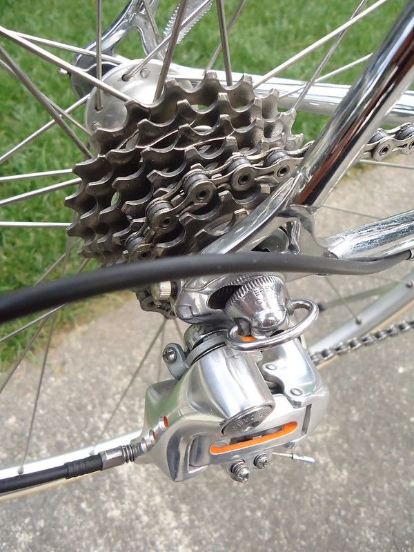

Originally Posted by Wileyone View Post
I have a TNT 8 speed Ti Cassette nos just haven't found the right bike to put it on yet.
As far as chains go the KMC SL ones are light and last for quite awhile. They are not Ti though.
Do your TNT cogs look similar to these?
The Davidson I converted to 8 speed Ergopower has been wearing these titanium cogs since the early days. I found them on Ebay and the seller wasn't sure of the maker, only that they were "aftermarket Canadian" and Campy-compatible (they're notched for Exadrive hubs). They are light as hell and very well-finished, with milled ramps and variable-diameter drillings.
Can't say much about durability because they grace my zero bike which hasn't turned a wheel for 4 years now...
deux jambes : I chose the 8 speed version of the chain you described above for this build. Nice and strong, pretty light and very, very quiet.
