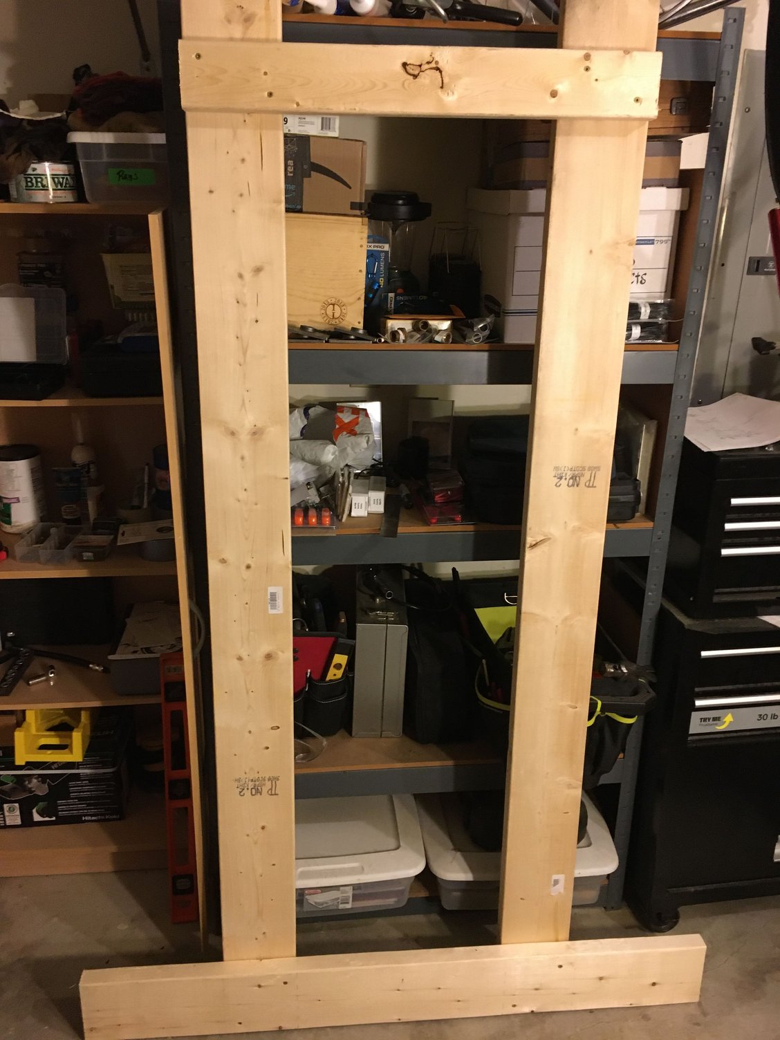

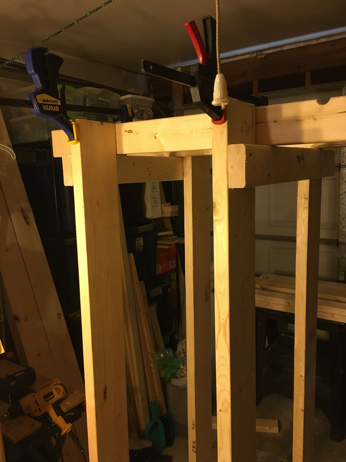

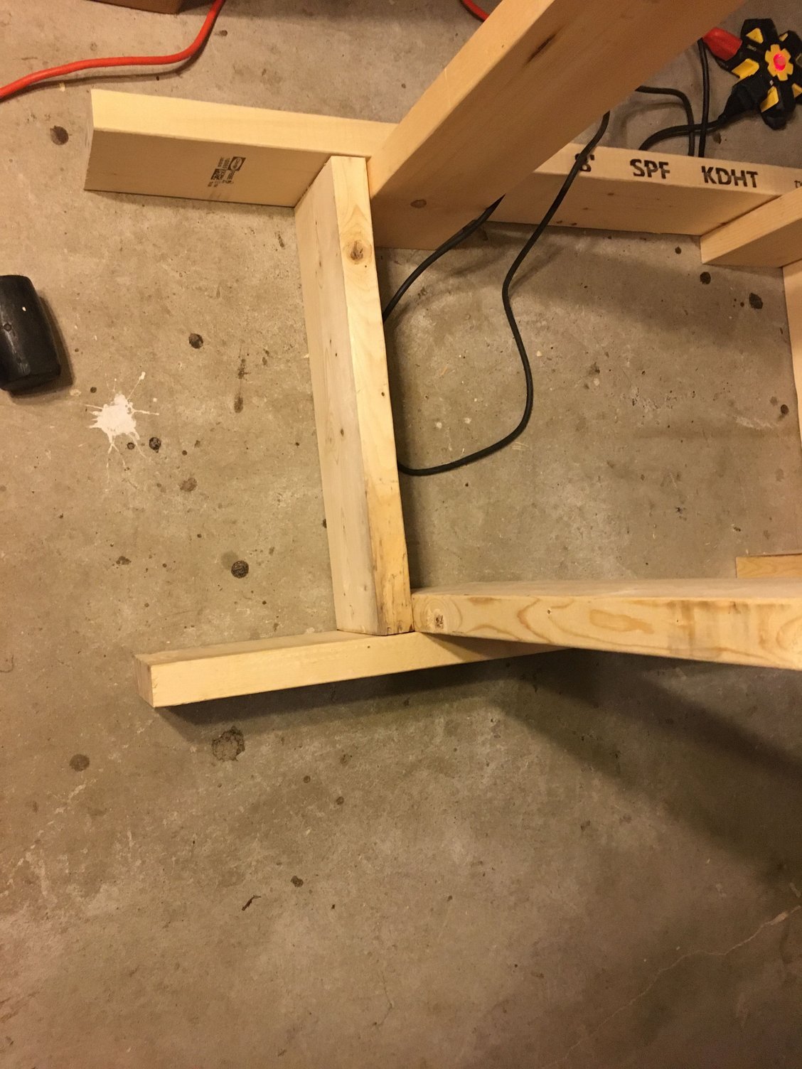

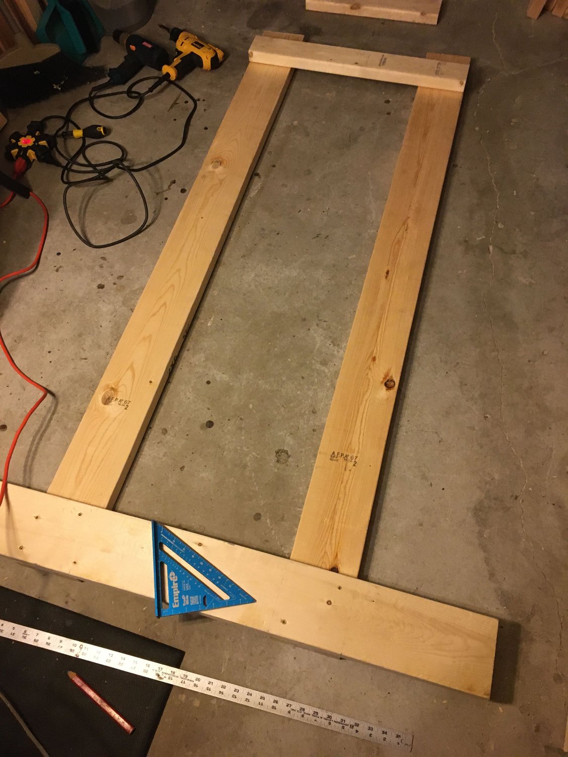

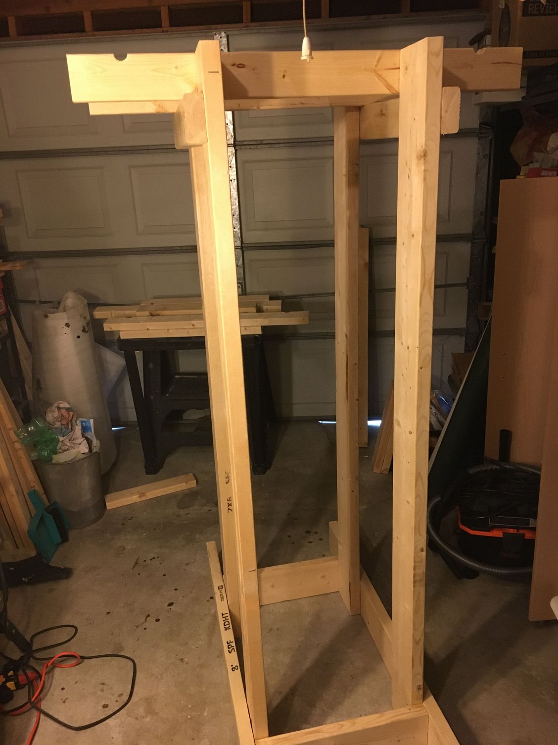

A few folks said they wanted to see what it might look like. About $115 total.
Building uprights
Upright
Notches for top tubes
Upper bike crossbar
Bottom structure

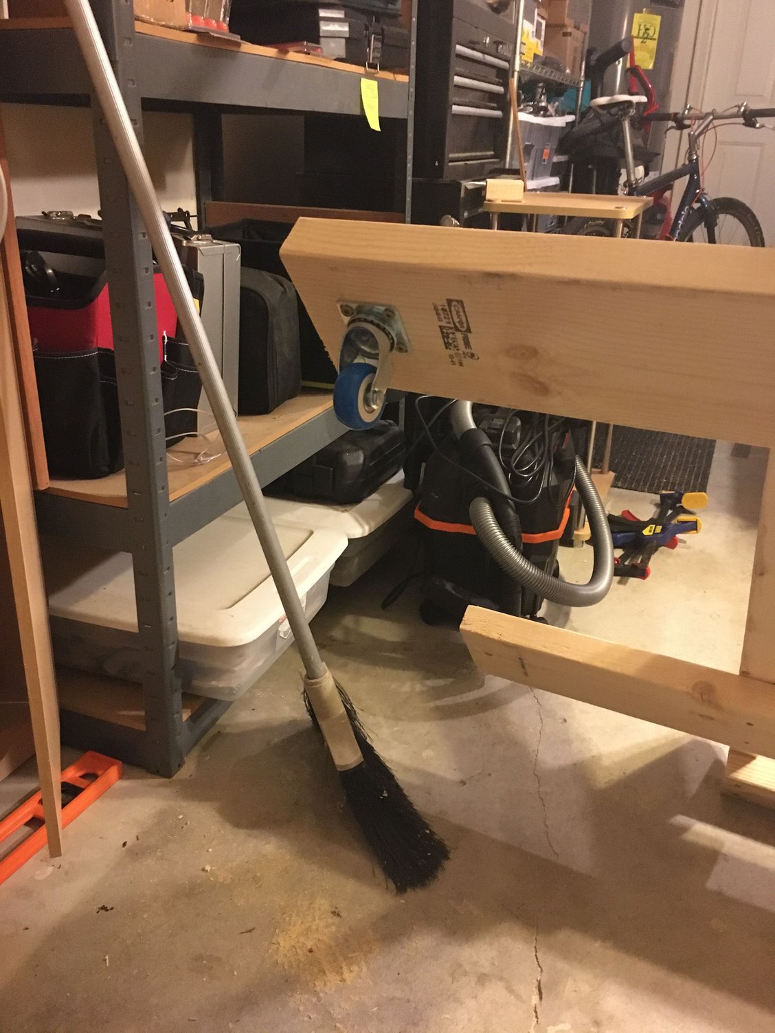

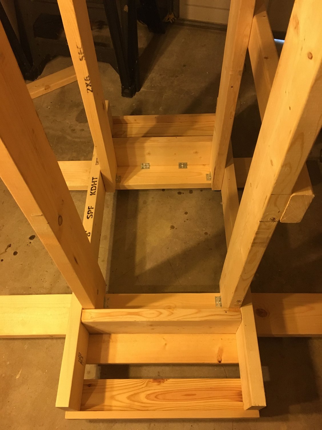

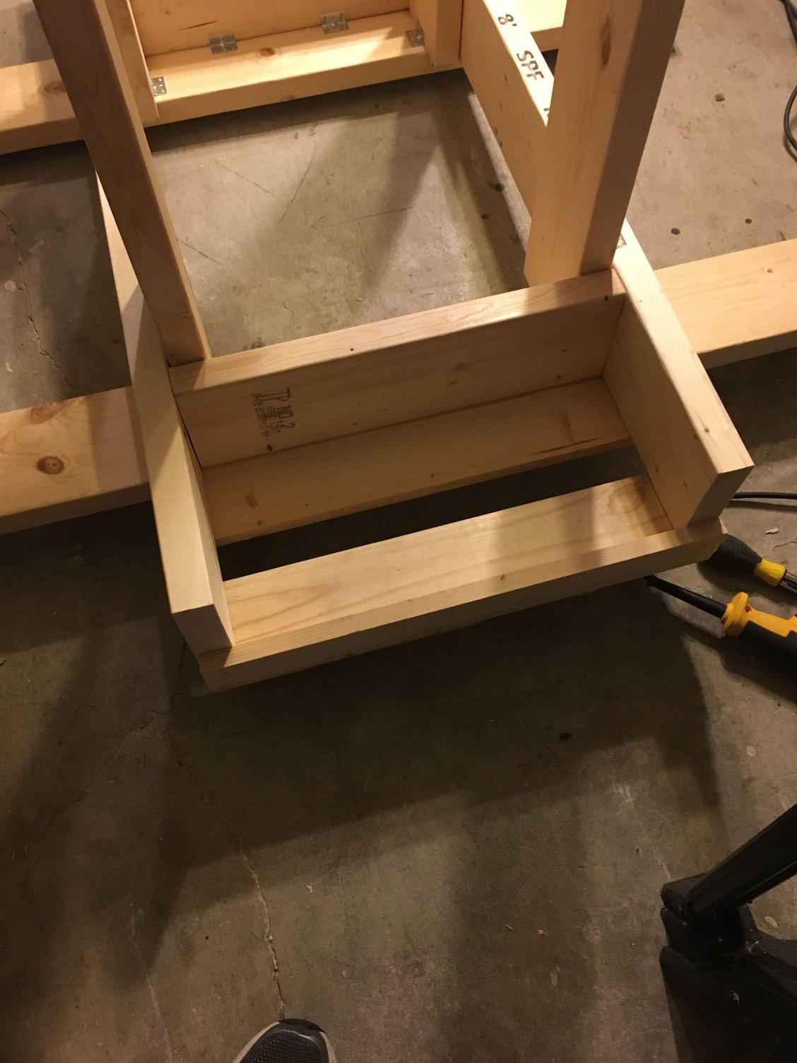

Part II
Basic structure
Base for the 12 wheels
Wheels
Area for shoe storage
Brace for bottom layer bikes
Outer wheels for stability
Shoe rack

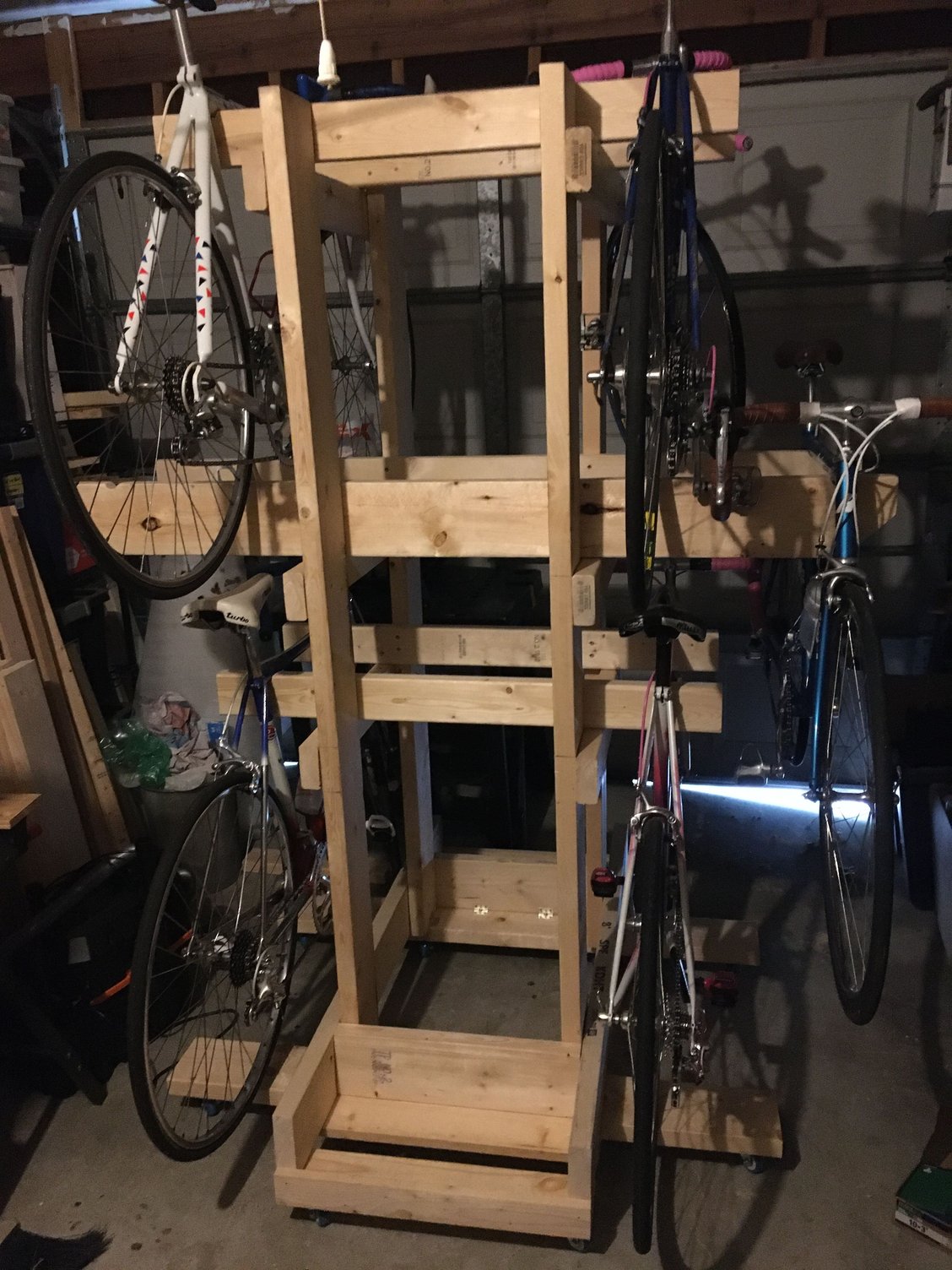

Part III

That's a beauty of a storage unit.
I just finished a rack from 2X4s. But just a simple rectangular floor unit in the garage. 9 bikes, 8' wide. I also hang many from the ceiling with pulley systems.

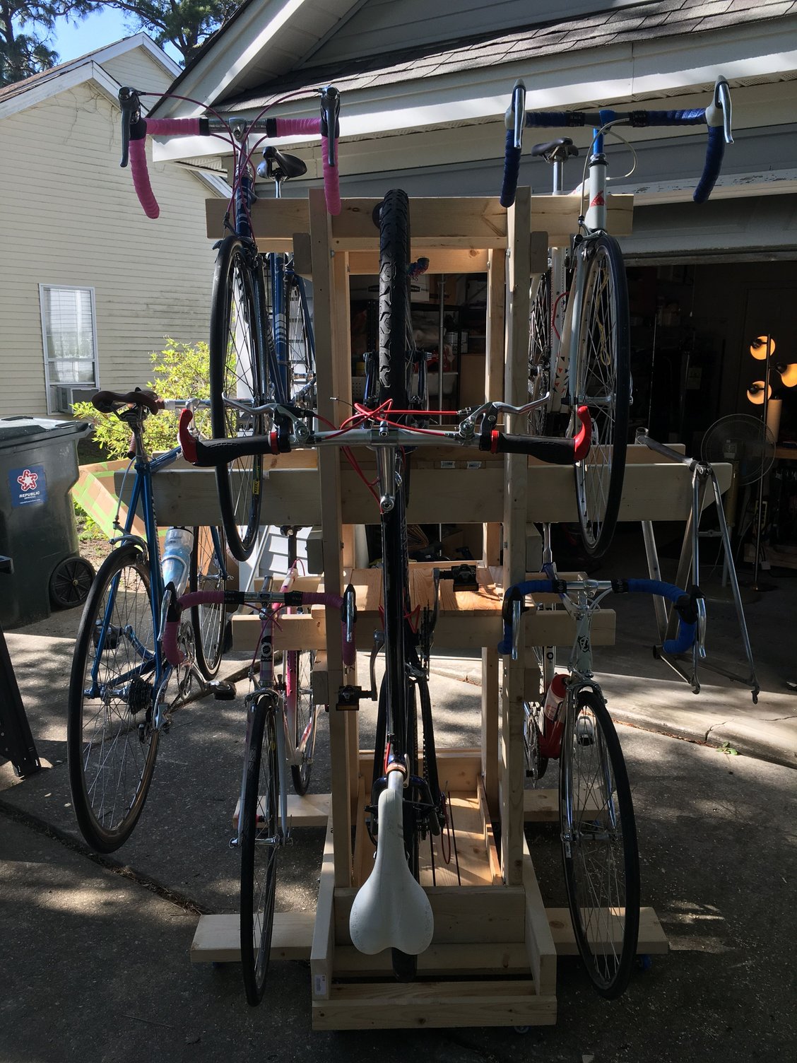

My garage is such a small space that I needed something movable and somewhat compact. It is my gym, workshop, storage unit, happy place.
It now also holds my repair stand, truing stand, winter trainer and pump. We'll see what else I can put on it!

That is quite the statue of a bike rack, good original thinking!
Can you roll it back into the garage with the bikes on it?
I could if I fixed the raised garage lip where a satanic Sweet gum sent its tendrils.
It is
86" tall including the height of the saddles on the top row.
68" wide including the handlebars on each side sticking out
64" deep, NOT including the mountain bike saddle sticking out, but including the wheels of the bikes on the middle row.
Interior space is roughly 20 inches wide.
