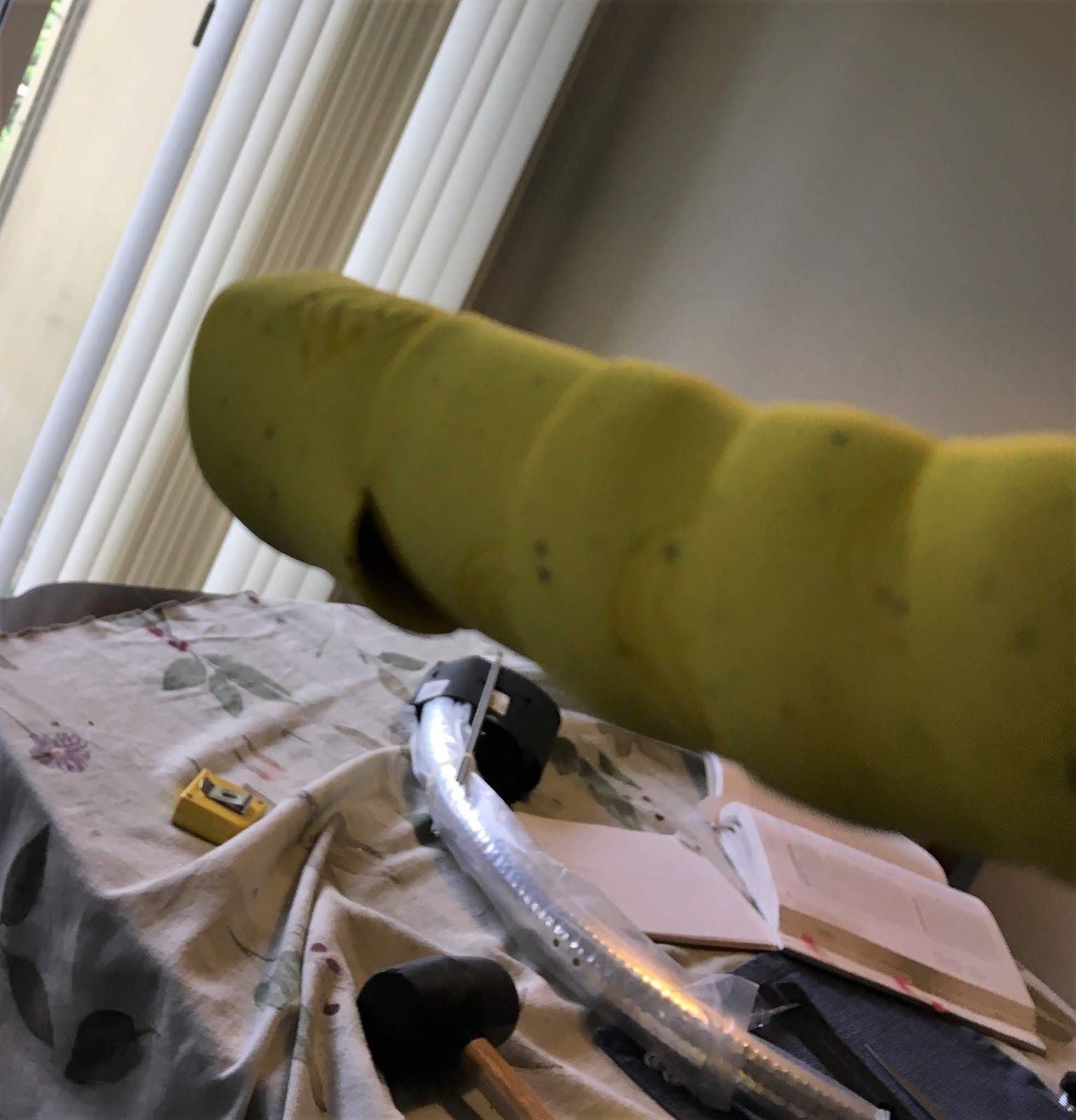

f**k, f**k, f**k, f**k, f**k...

Ah, bummer! Bitten in the arse by that overlap.

Second attempt wasn't much better (maybe 1/2-inch further). Maybe this is why Giro d'Italia bars with their short reach and drop are popular? This is a Campione del Mondo bar.

Just cut the last 1.5" from the bar ends and you're sorted!
I love CdM bars, but yeah, that deep drop is enough to realllllly stretch the limits of some tapes (Velox/Cateye is notoriously short for anything other than GdI bars, I swear).
On the plus side, your wrap job is consistent and clean

What tape is that? I only ask because Newbaums is usually quite generous with the length.

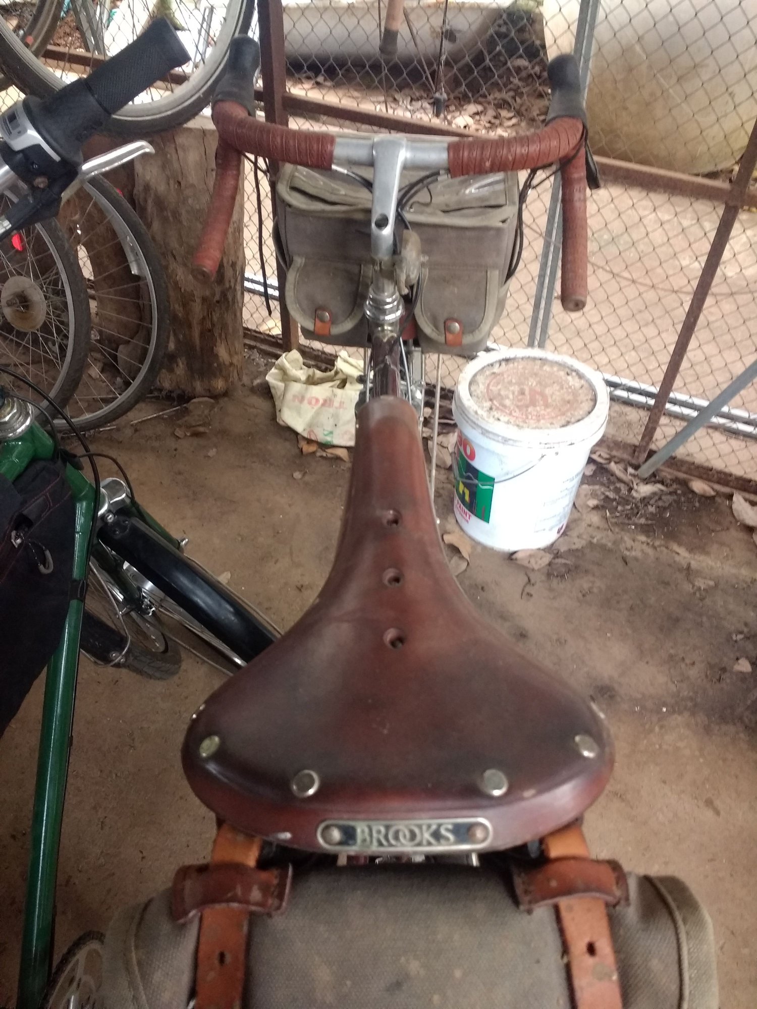

I love this leather tape, got it from a BF member a while back. Works nice with my Brooks flyer.

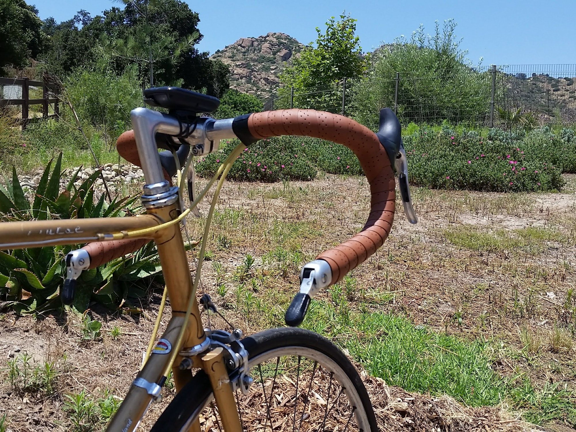

Bar wrapping is an acquired taste. I used to hate it, now it is a labor of love, and adds either the finishing touch, or freshens up a older bike's feel and look. I like Brooks leather wrap, though it is pricey. I found a Chinese product, Kingou, on Ebay for 1/4 the cost of Brooks. Its synthetic, wraps easily, provides just the right amount of "cush", and doesn't seem to darken or stain like the Brooks does. I've always wrapped end to top, mostly because I use bar ends, and don't want to deal with cables and removing the shifters. I've tried Fisik on a couple of modern bikes, like the look, wraps easily, but could use a little more "cush". I like the overlap pointing out, so the edges lay down and don't lift with use,
Brooks leather on '73 Super Course. This is right afrer application. Now, shows patina of sweat stains, hand oils, and 3000 miles, but is holding up well.

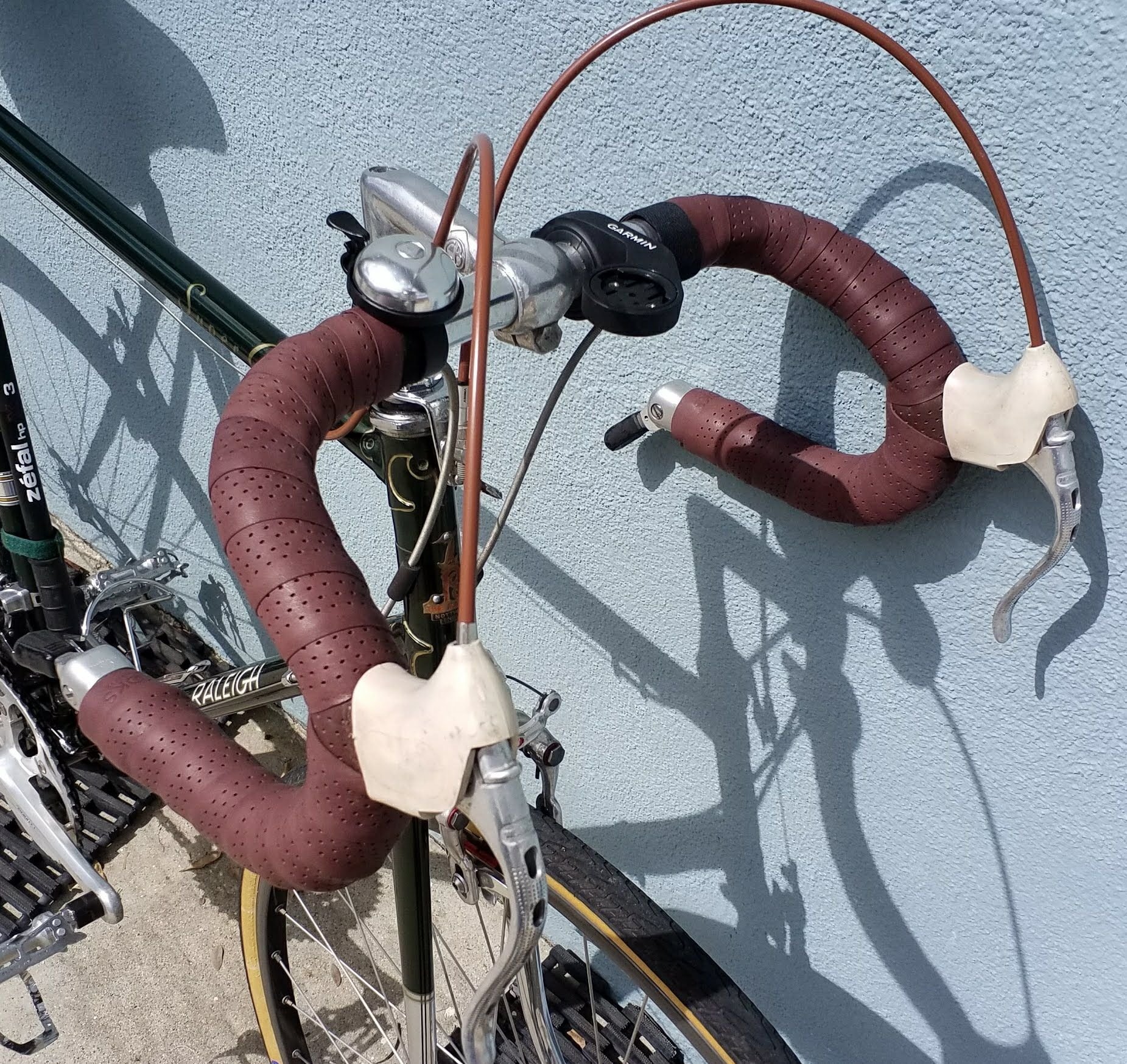

'78 Super Course with Kingou synthetic. Nice feel, doesn't seem to stain, and 1/4 cost of real leather. I have it on two bikes, both with honey color Brooks saddles.

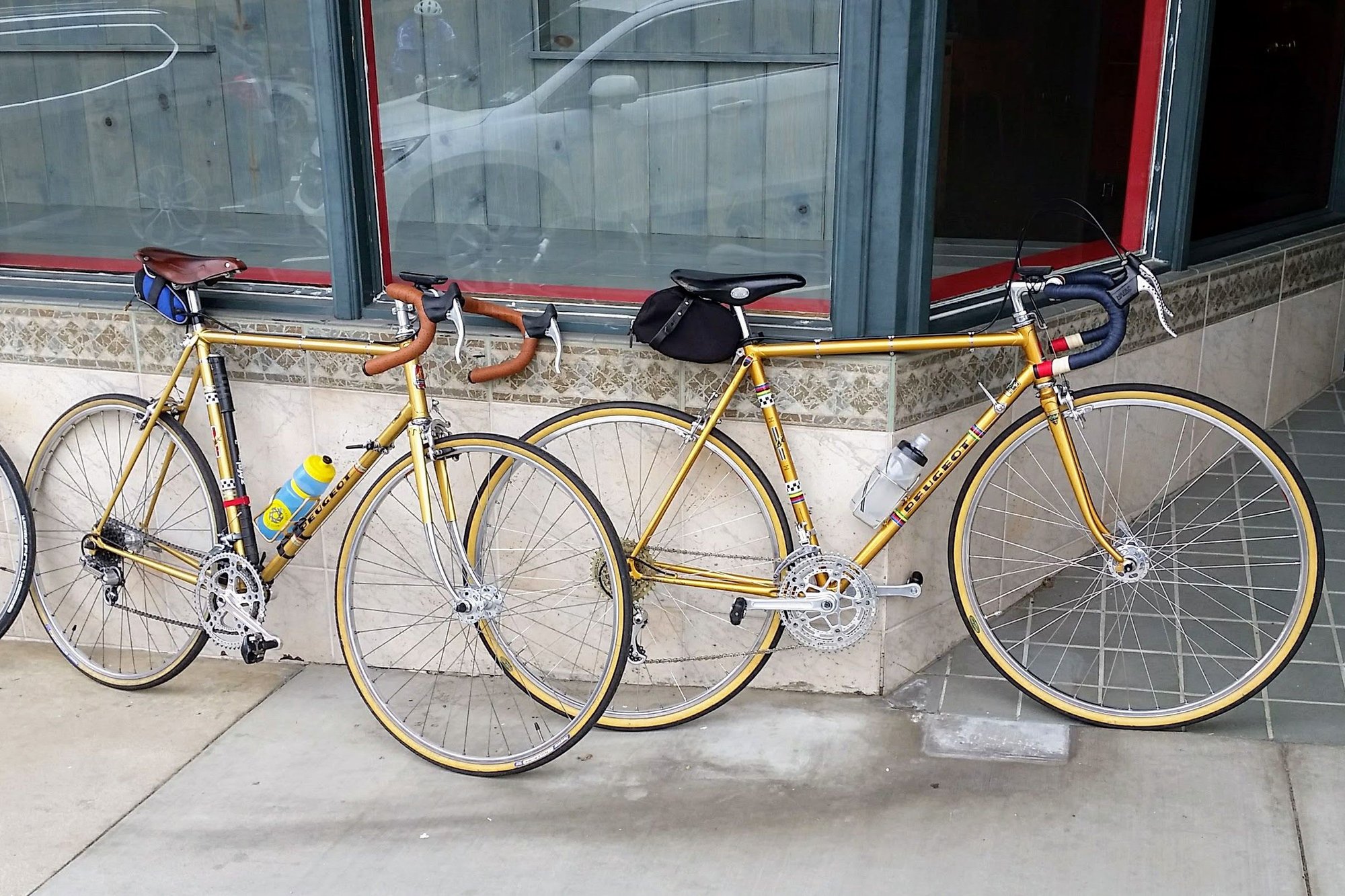

My Peogeot on the left with the Kingou synthetic, a friend's on the right with tricolor cloth wrap.

@Slightspeed, how durable and reusable is the Kingou tape? I see Amazon is selling it, and it comes with some nice looking plugs.
Brooks leather tape is nice, but it's not as nice as my Nashbar leather tape, now out of production. I have had it for years and even moved it from bike to bike. I'd love to find it again.
I bought some Brooks Cambium synthetic tape and am waiting to try it. It gets bad reviews for being inflexible thus hard to install.

I've rewrapped the two bikes I have the Kingou wrap more than twice, to change or move brake levers. It seems to go back on quite easily. It does have a light adhesive strip on the back, about 1/4" wide. Also I have wrapped over brake and/or shifter cables, and the flexibility is great for that too. I got the Peugeot last August so it has been about a year, where the Brooks has the patina of three years and over 3,000 miles of use. I don't have a recent close-up of the Brooks, but it has held up well, but darkened considerably. I didn't like the feel of the Brooks, when I wrapped it on a spare bar to test it, so I left the old thin black foam tape on the Raleigh, and wrapped over it. The Brooks looks a little fat on the bike, but feels better to me. Never tried the Brooks Cambium.
