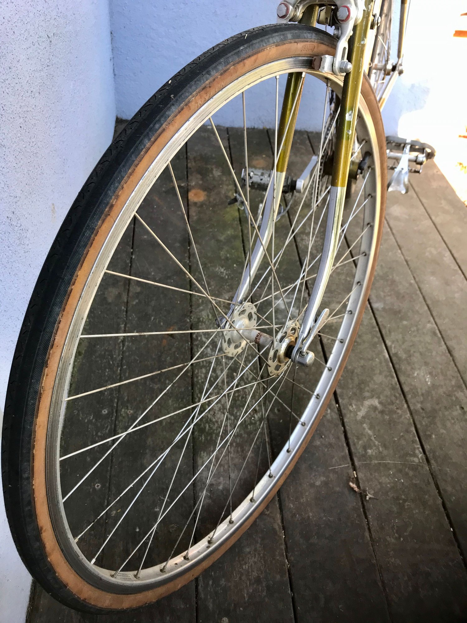

The wheels are Weinmann concave built on Normandy Luxe Competition hubs. Again, it all needs a good polish. I’ve used the bike a lot.

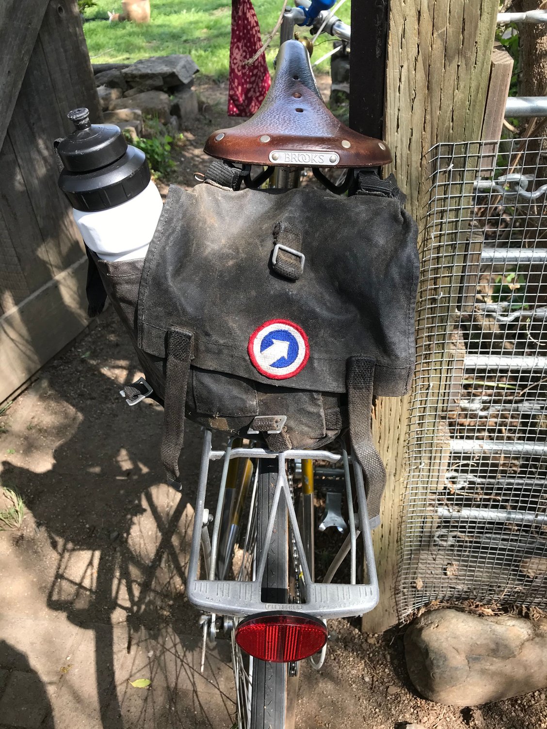

Waxed German military bread bag repurposed for use on seat or handlebars.

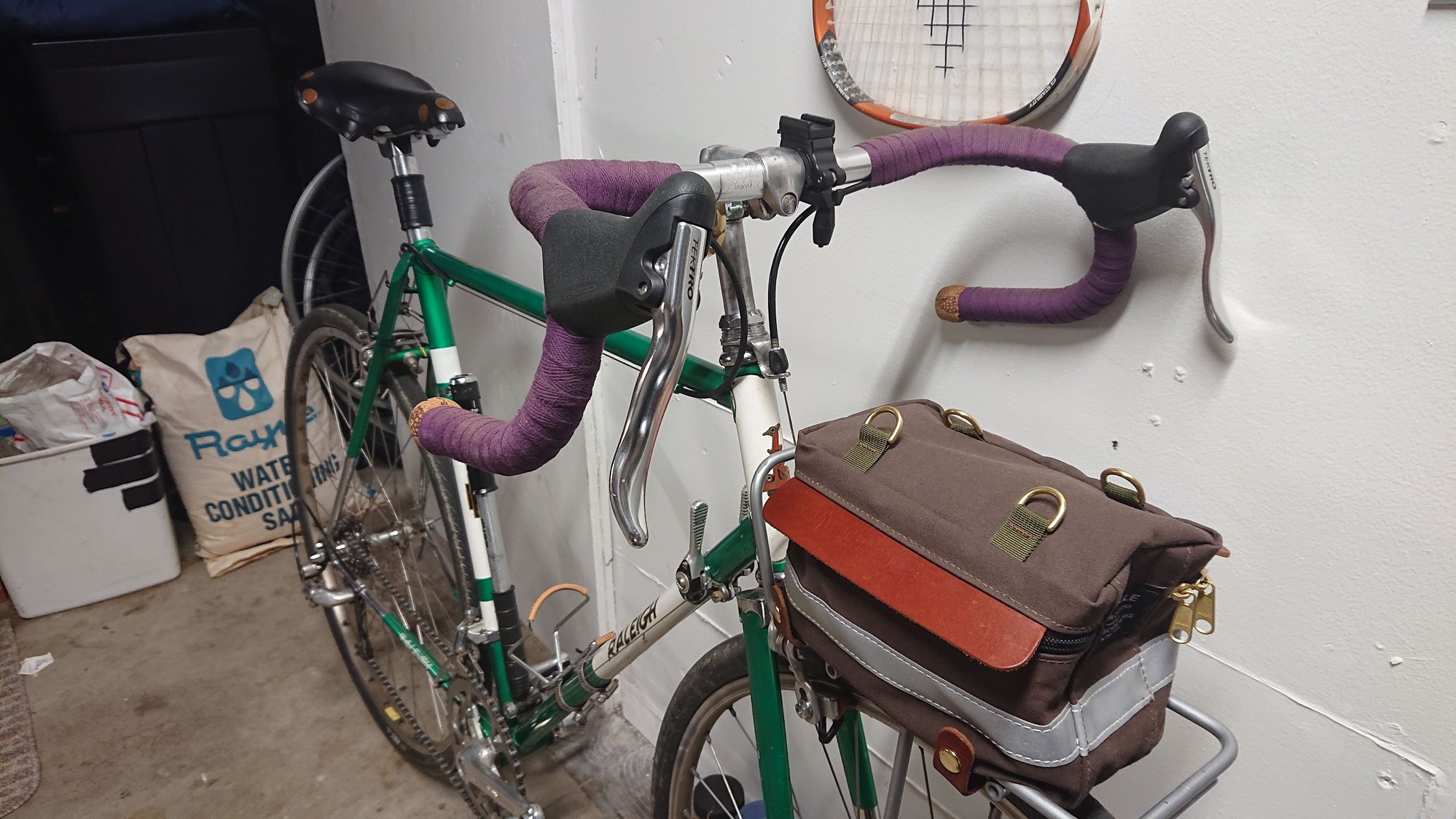

It's finally done, for real this time. Or, possibly, until the next. The only things left to do would be to swap out the 122.5mm spindle for a 127mm, and to trade my long cage for a short. I'm hoping a short cage will make friction shifting more precise with my 8speed cassette.
I will flesh out my thoughts on the bike and the build in the morning with an edit on this post, but, for now, all that needs to be said is that they really do ride well.
edit: I originally put this together as a north-road townie 1x6. Or was it 1x8? Anyways, as fun as it was in that configuration, the geometry of this bike basically requires more weight on the front wheel. It's just a bit too squirrel-y otherwise. Drop bars is the obvious choice, and, combined with a small front load makes for a worry free ride. Not too twitchy, not too leaden, just right. In the future I may install a rear rack and take it for some short tours.

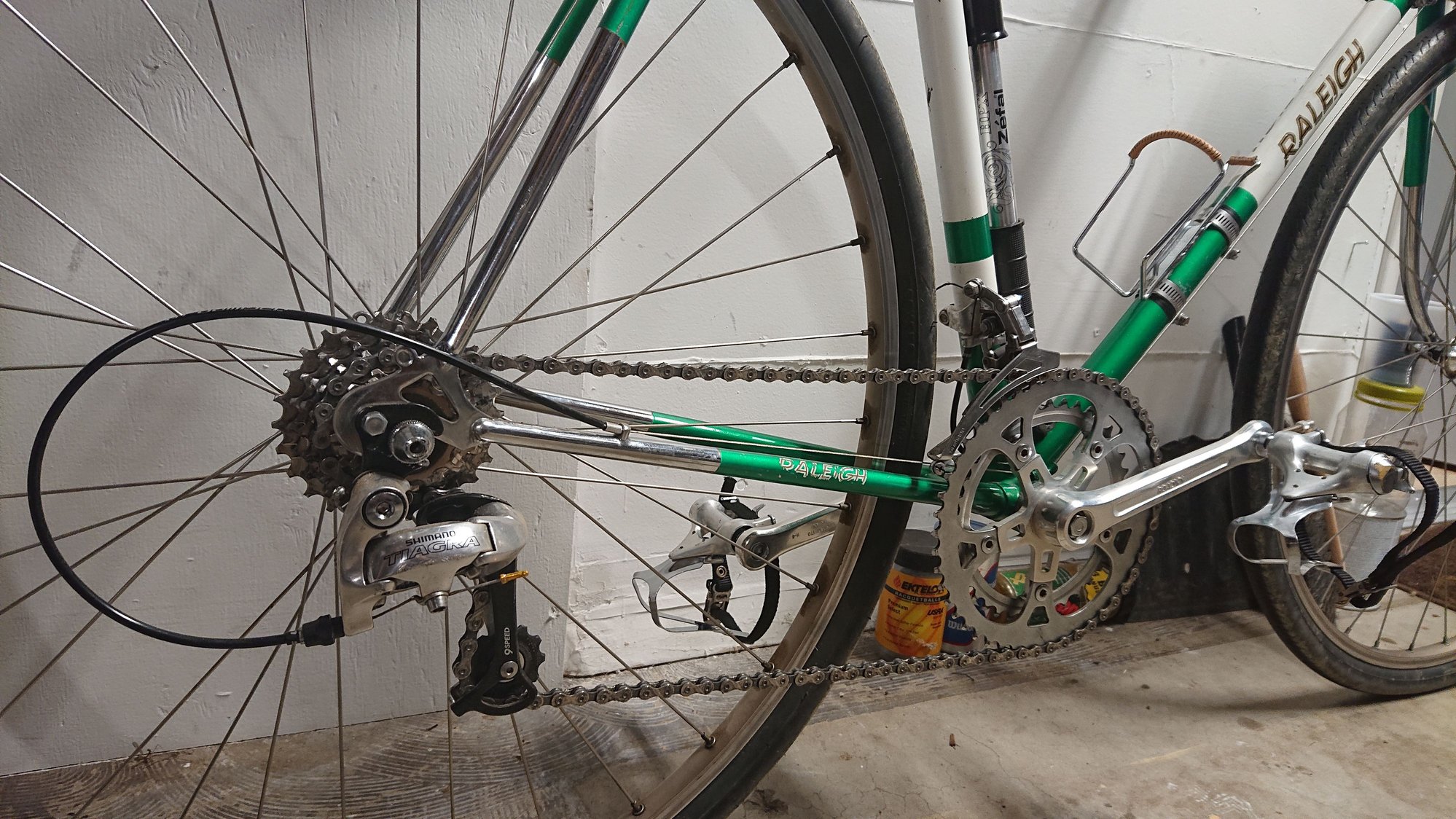

It's currently sporting 48-38/12-28 gearing which is just about perfect for San Diego. Most of the time I'm in the middle of the cassette and swapping between front rings depending on if it's uphill or downhill.
Tires...the tires are okay. Cheap Forte 700x35 tires that actually measure out to a hair wider than 30mm. Heavy, not supple, but still ride alright simply because they have some width to them and can be run at a lower PSI. I cannot wait to run them into the ground and swap them out for Conti 4seasons in 700x32/35 and really enjoy the feel of the bike.
The inner tube wrapped around the seat post and the little wire tubing hanging on the seat stays are for strapping a big saddle bag. That bag, plus the mini up front, is more than enough for some upcoming longer rides (as soon as I deal with some ingrown hairs on my sit bones )
All in all, great bike. At some point I'd like to take it into a good shop to have the frame/fork straightened- the fork is slightly off and my expertise at cold setting the rear dropouts to 130mm left something to be desired. For the moment it doesn't matter.

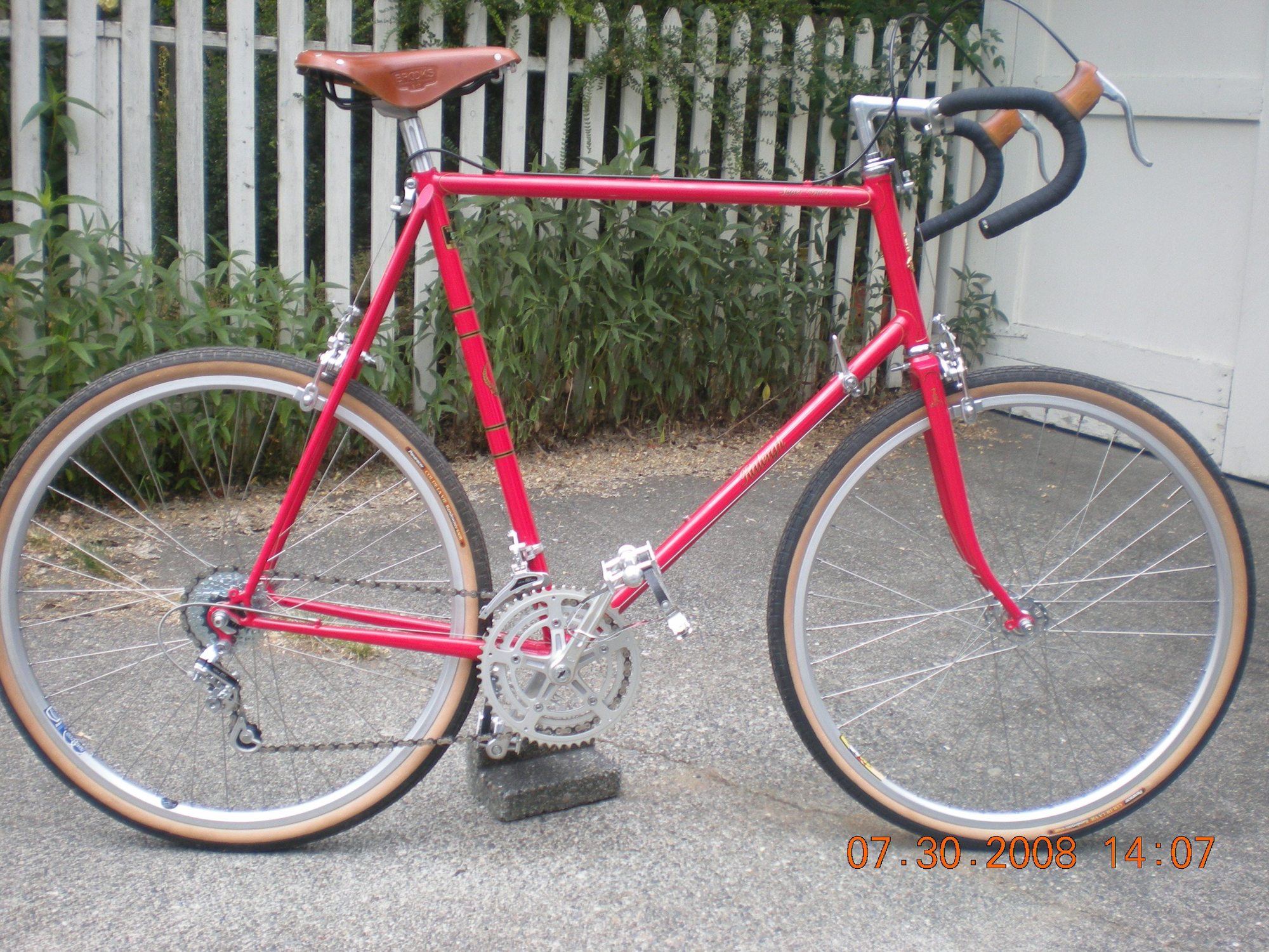

This thread is now 10 years old, there are some fine examples of SC's. The one pictured below is one of my favorites, it inspired me to dig mine out which I've had for almost 20 years and restore it to its original glory...

That was for sale (maybe still is?) and it was tempting. But, at the end of the day, it is such a terrific example of a well preserved original, it did not fit my needs. I would love to have an early 70's green SC, but I want to put 700c wheels on it and I would need to change out the cranks to work for me. I would not feel good about stripping that one down.
