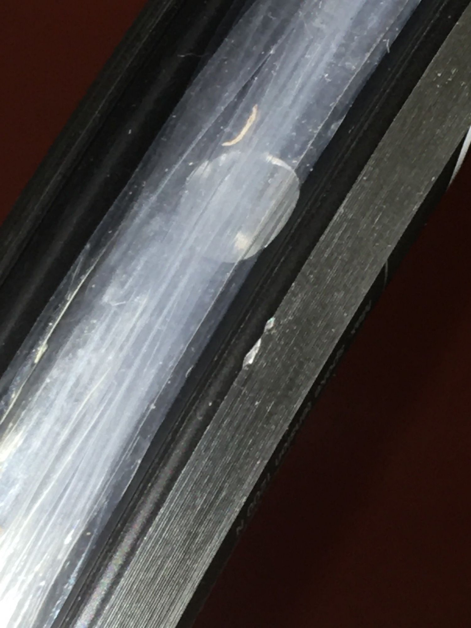

Would you consider this a defect for a brand new alloy rim or are these to be expected? I am specifically wondering about the machined braking surface because while rather cosmetic, it seems that only on one side the aluminum was brittle as it is "chewed" both from the inside and outside.

If you bought the rim from a commercial enterprise as "new", I'd suggest that you return it or ask for an adjustment. Part of the reason you pay a lot of dough for new stuff is that the aesthetics are terrific. This rim was ill-used. If you bought it via ebay, well, with ebay you takes your chances. Up to you whether to return it. Can't see the pic very well: is the rim tape all torn up?:
If the rim is not out of round, it's probably ok for use, but you'd need a new rim strip.

If unused, definitely a defect. If used, you need to check your pads for embedded debris.

This was sold as new and it’s rim only, no signs of use and the “tape” is just cling wrap I put aside to snap the pictures. It’s rims only for fresh wheel build.
i just wanted to know if it is not something like “usual” aluminium extrusion process defects if someone had a chance to see many more new rims than I do. Basically no problem with return but don’t want to be surprised to receive the same again just week later. 😬

Thanks, Unused and new, just put aside the cling wrap and found couple of spots but this one particularly uneven. The wrap was not torn in that place and nothing damaged on the packaging. So I really think this came out like so from the factory.

My experience is that new rims aren't marred like that. But rims can get marred like that pretty quickly in use. Your call, but the rims (if round) would probably be functionally fine in use.

No, the blemish is on the machined brake track, which is a process after the extrusion. It looks like shipping or storage damage to me, perhaps jostling against something hard enough to leave those marks.
In any case, I would consider it a cosmetic, not a structural issue. It's your call if you want to return it.

As Johnny D says, likely damage from storage or due to careless handling. An aluminum rim is much softer than many building materials like stone or bricks or steel, so it is possible that the rim got dropped or placed somewhere and that caused the little damaged spots.
(a) There is 100% no problem with riding that rim...
(b)...but it should not have been sold as 'new' at full price, but rather as a 'scratch'n'dent' or blemished item with some percentage off MSRP. But if this rim is going on a bike meant for riding and not just for looking at, then just build it up and ride - such scratches are very common from regular riding. If I went to the LBS to buy a rim this afternoon I would expect to have that amount of damage by the time I got home just from the rim being in the trunk of my car. I might notice the damage as I laced the wheel, but it wouldn't stop me for one second from riding with it.

I used to worry about things like this, but no longer...it is not structural and only cosmetic...if it bothers you return it...if this were my wheel, I would ride it and not think twice about it.

I think this is some manufacture / handling error. send em back.

There were too concerns I had despite it would take more hits when ridden later for sure:
1) Since there's the inner side of the same rim brake surface "filed off" as well, I was concerned whether for some reason this already did not happen during machining the brake surfaces due to the particular rim being brittle.
2) There were minor scratches on the black anodized surfaces - probably from spokes shipped together in the same parcel. I would never bother for those, but combined with the dent one feels like that's not what was paid for.
