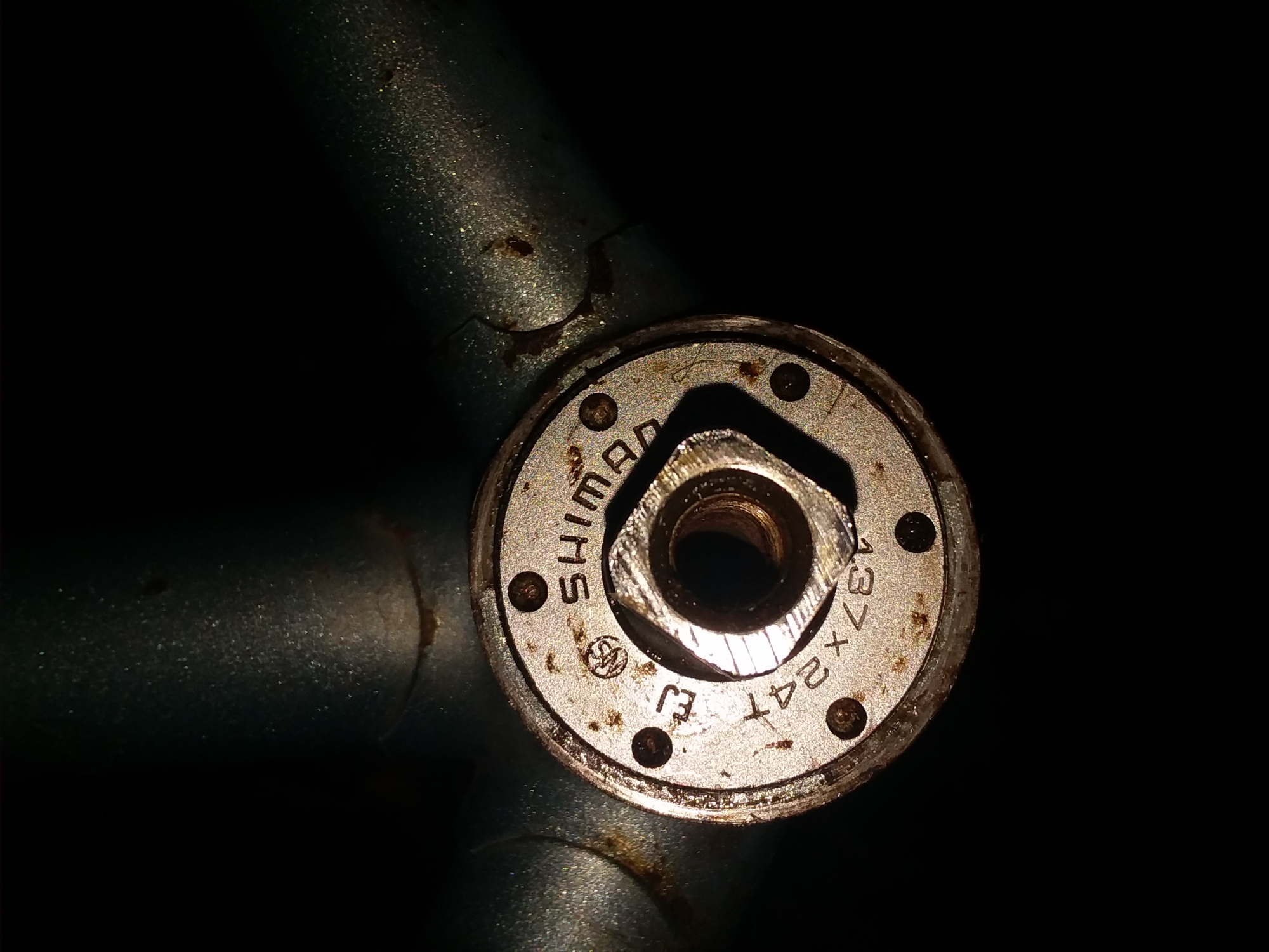

A much simpler approach will be to buy a new bottom bracket off ebay that is the same length as your current one.
I have used these on a few bikes- they are cheap but have been perfectly fine. One is on a bike of mine, two are on bikes my kids use, and I have used a couple for refurbish bikes that I then sell. They https://www.ebay.com/itm/Bike-Bottom...0deec771c8b2f7
Or this is a perfectly fine solution too- https://www.ebay.com/itm/Tange-Ln-39...FH4MpzAc8nw7-g
Cartridge bottom brackets are easy to install and remove(that driveside of old cup n cone BBs can be brutal!).
Some dislike 'new' tech such as cartridge BBs, but they have been around for decades. Hardly new. I dont like throwing out good working stuff, but some things are worth $15 to simplify.
Can you tell from this what size I need to order? Or what do I measure when I pull it out?
Edit: looks like that's the same standard size as those links you posted. I just need to measure the length of the spindle, right?

Update: I pulled out the bottom bracket. Glad I did. Real dirty in there. Even some mud and the spindle was half coated in silt. The bike was half submerged for a couple days in a flood and apparently some mud somehow got in the bottom bracket.
I liked the $15 new bb idea, but this one is so cool looking and solid I'm leaning toward cleaning and repacking it.
once it's cleaned, check for pitting on the spindle race and cup races. Mr. Jones can guide you through the process.
