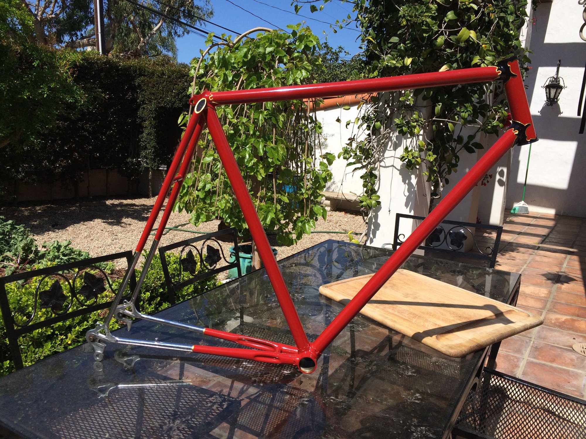

You can read my earlier posts detailing how to paint with Rustoleum enamel . I have done quite a few repaints using it and for the money it can't be beat. Just be sure to be careful and after painting don't hang the hardware on it for a couple months to let it dry . Store it somewhere hot while you are waiting . like the attic.
if you are going to all the trouble of painting the bike you would be crazy not to pull the bottom bracket, fork/stem, and seat post. If any of those is frozen and won't come off your bike is basically toast and no point painting it.
I just finished rehabbing an 85 Bianchi and the grease on the bottom bracket bearings was so hard I had to chip it off with a screw driver. Same with the stem. After cleaning and renewing the grease everything works beautifully.

Pretty sure he used Rustoleum. That is what I used also. $13.00 total for paint and primer FTW. $20.00 for brushes which are not single use. The key is prep and wait time of at least a week to dry between coats. Colors of course are limited. I've got some safety red that is waiting for a project.

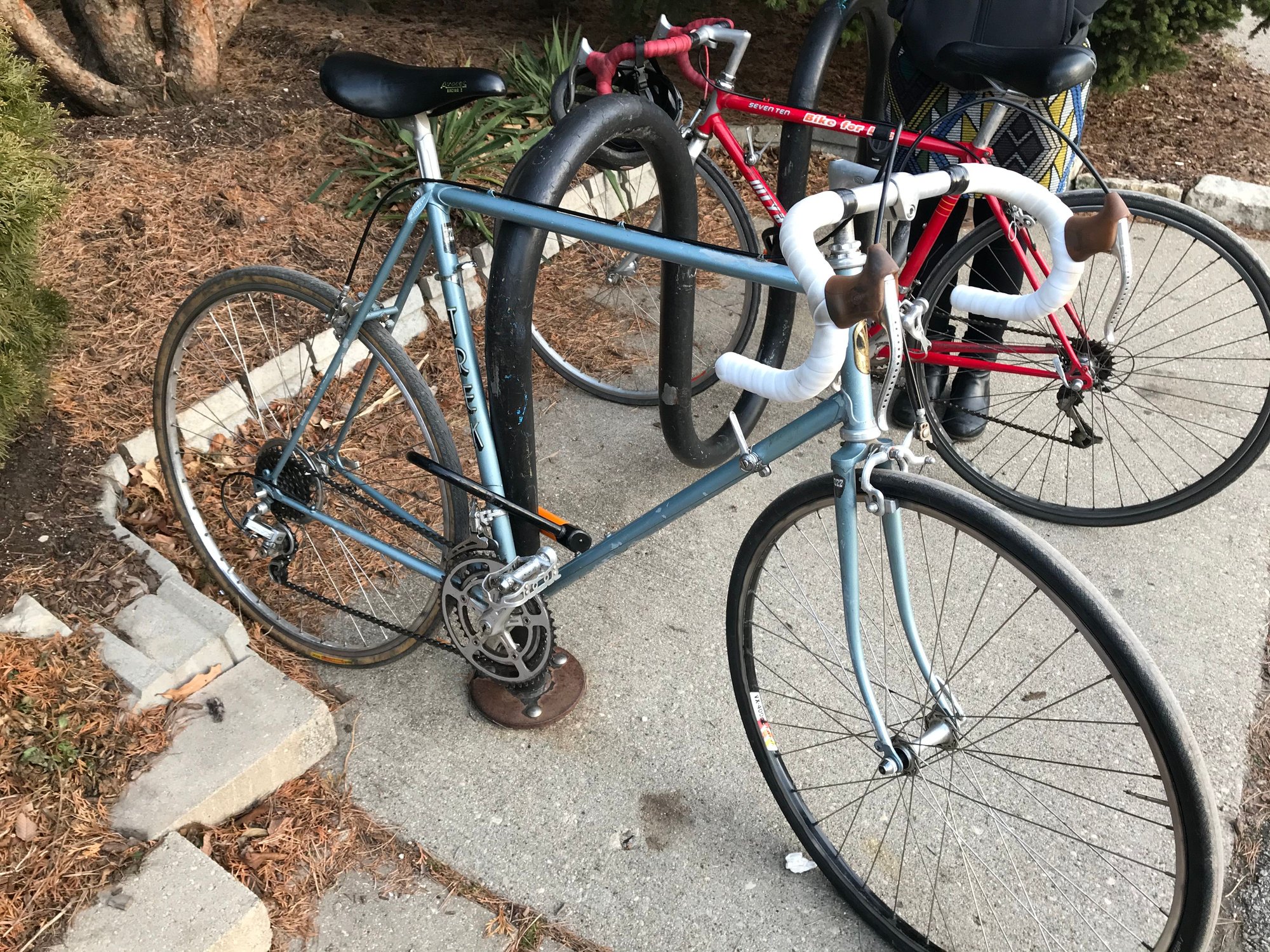

Well, as long as we're posting our Ice Blue's...
1979 514
It's been touched up with some brushed on flat blue paint by the PO.
Chr0m0ly is offline
