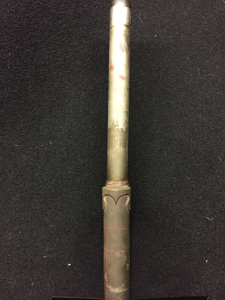

francophile dam good eye my friend. I rode the bike and thought it didn't feel as stable as the wheelbase and fork rake would indicate. I removed the fork last night and to my eye it looks like it is bent slightly back form the fork crown. Perhaps a front end impact of some sort. The fork blades are even, but it seems bent back right at the crown. The fork seems solid and I think it is worth trying to straighten, the lord knows I am not going to find a replacement. This photo is taken from the non drive side.

It depends how the builder of the frame preferred to set the blades in the crown though. The blade may be aligned with the centerline or rear edge of the fork - resulting in the blade's taper appearing to angle backwards before the curvature forward. Peugeots and Motobecanes were often built like this, and it's not out of the question for some English builders.
Before trying to tweak the blades, start by putting a pair of dropout alignment adjusters in the front dropouts. It's not a guarantee to determine whether the fork is bent or not, but it'll help indicate whether there is some sort of alignment problem up front.

cudak888 Good point. I have an old Peugeot that appeared at first to have a bent fork, but after looking at several similar bikes I realized that is just how the fork looks. I will check the front dropouts with an alignment tool.
