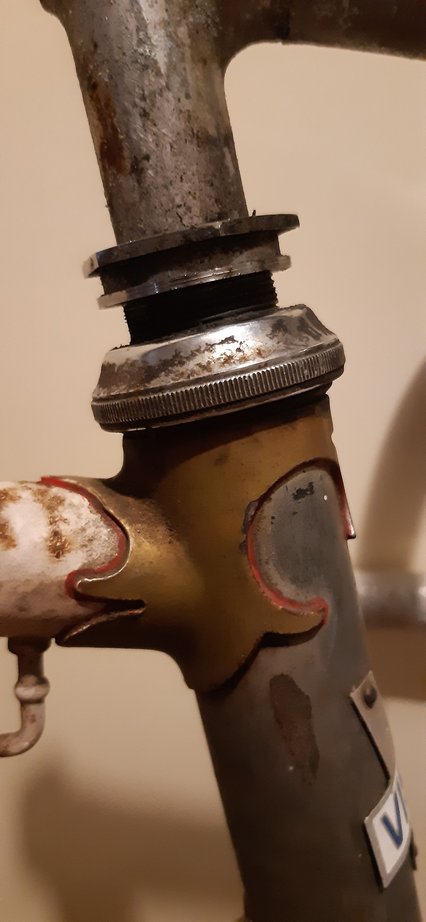

The TWF marque was created by two brothers, name of Woit, in Flanderland, 1946. The T and the F are their respective initials.
Firm produced headsets, bottom bracket assemblies and chainsets.
In Britain, Ron Kitching was a stockist in the 1950's and 1960's. Headsets shown in 1963 & 1970 editions of the Everything Cycling handbook.
Historique : WOIT Fonderie des Métaux non Ferreux - Herstal - Liège - Wallonie
Member Munny discusses the bottom bracket spindles here -
https://veloretrocourse.proboards.com...0688/quote/624
As a native Dutch speaker expect you will have no difficulty in searching for additional information in Flemish.
These three images courtesy of Munny illustrate one pattern of headset, different from yours -
Munny gives additional information on the company and their products in this BF posting -
https://www.bikeforums.net/20158383-post536.html
It does not look like a TWF headset.
it does not have the teeth like the others I've seen.

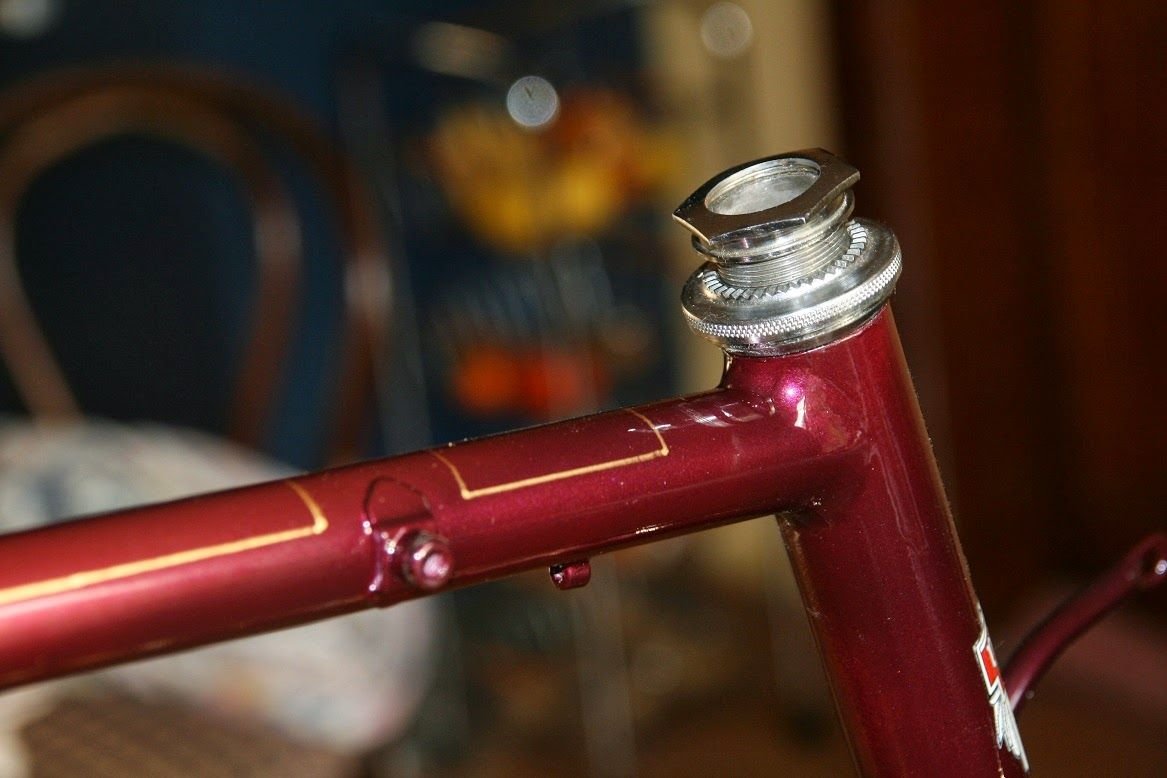

Someone is selling a very similar frameset on MP
WOW!
Terrific find - what a match.
MP highly dangerous for me.
When I visit can be lost for hours.
Sun can rise or set, as the case may be...
Thanks very much.
juvela is offline
Old 03-22-20, 03:34 PM
  #58
Locomotief
Locomotief's Avatar
Posts: 131
Quoted: 42 Post(s)
Liked 21 Times in 14 Posts
thats an exact copy... but better.

Contacted the seller if he knew anything about the frame. Only thing he knows is that his frame is never been used.
I think you should get it
