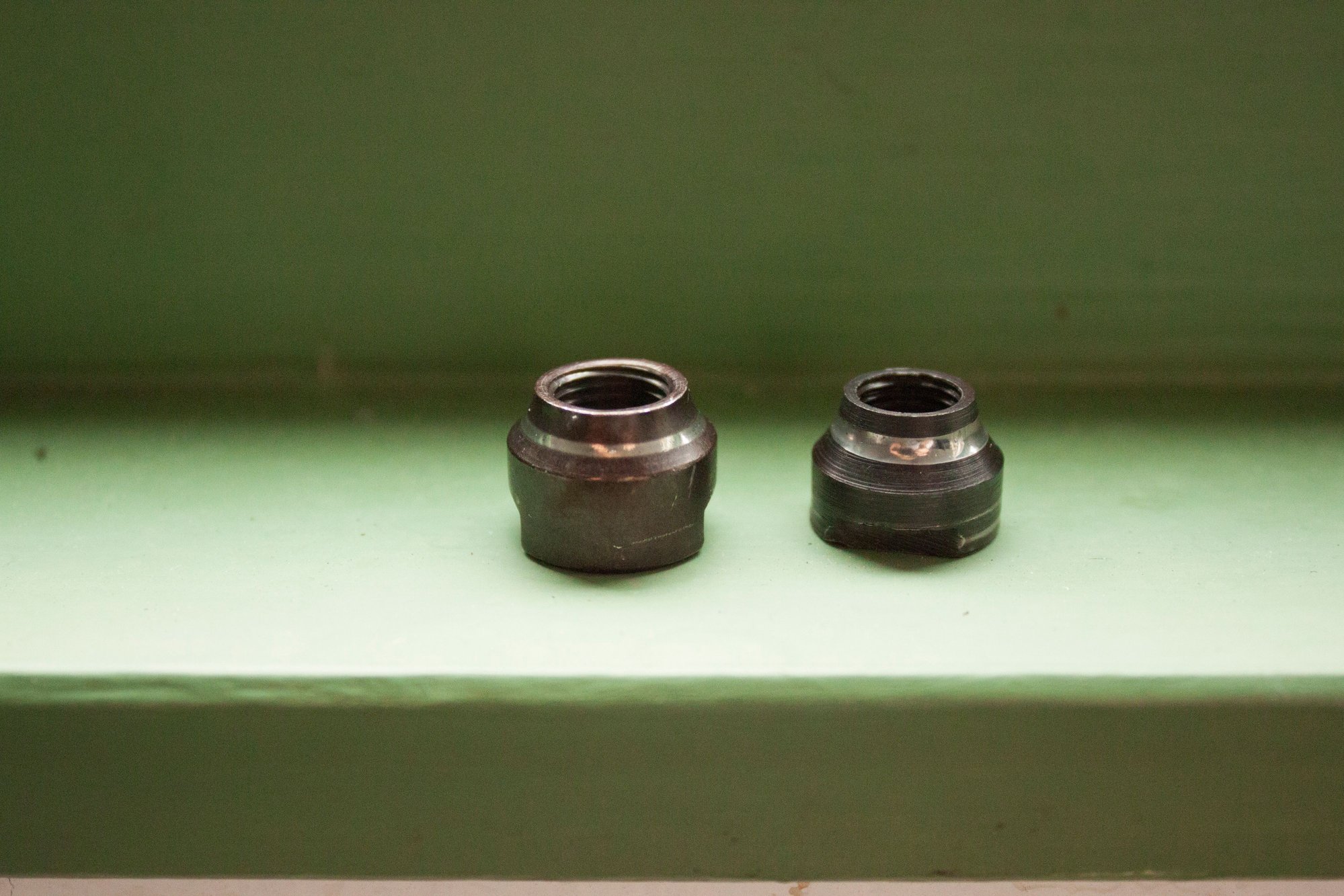

I am running Wheel Mfg CN-R086 cones in a Pellisier front hub as an experiment. Those hubs are basically the same as Normandy high flange hubs. The curvature of the bearing surface does not match the one of the original cones but so far they seem to work fine. The bearing surface is also much smaller than that of the original cones. Anyway, I took the hub apart today to see how things are doing and took some pictures. It's been around 300-350km since I installed them. One of the cones has developed a slight groove more or less in the middle of the bearing surface which is as it suppopsed to be. I am thinking about ordering another set of Wheel Mfg cones for another French wheelset, also a pair of rear ones.
To be continued...

I would say that looks healthy. Thanks for the data!
And if the diameter and length are correct, it's no accident.

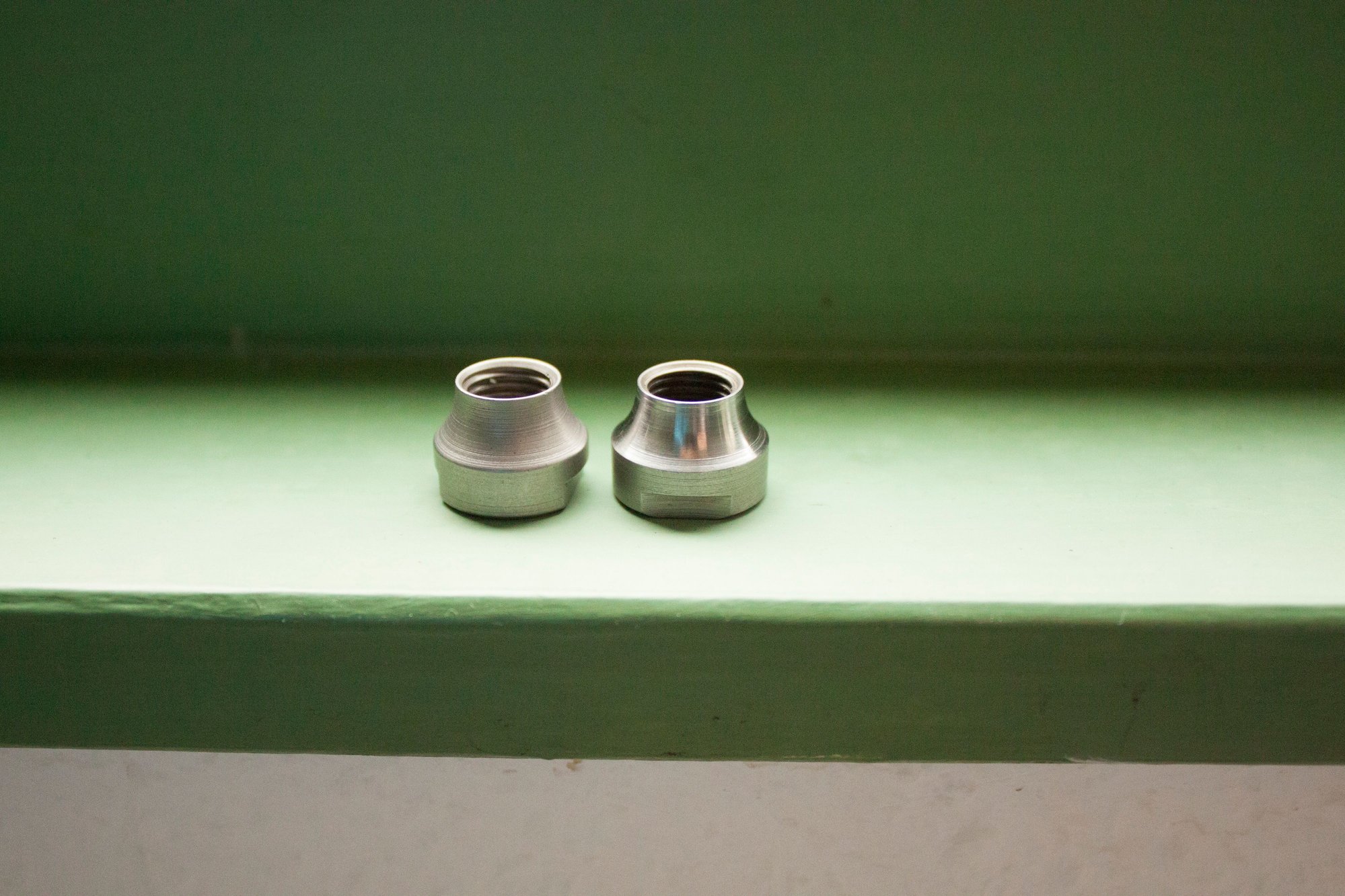

I realized today that the second wheelset I need cones for came with non-original cones. Both front and rear ones have their bearing paths more or less in the middle, so it's good news! The front cone measures approximately 11.7mm in length and 15.7mm in diameter. The rear one is about 13mm long and 17mm in diameter.
I found an almost identical pair of cones for the rear in my parts bin which are 13.6mm long and 17mm in diameter. I just have to figure out where I got them from. If I am not mistaken I got them about 3 years ago from a bike store when I needed a replacement solid axle for a bike I don't have anymore. I am wodering if they are Weldtite cones. Anyway, the ones I've got look very similar to Wheel Manfacturing CN-R081 cones, so my guess is that those ones should work as well.

Great info. Thanks for sharing. Normandy hubs were the most common hub out there for many years. Bike shops usually had a big pile of replacement cones in a drawer, but those days are gone.

No problem, I just thought that this info might be useful for those who look for replacement cones for Normandy hubs. Whenever I overhaul those for the first time I almost always find pitted cones, especially on front hubs.

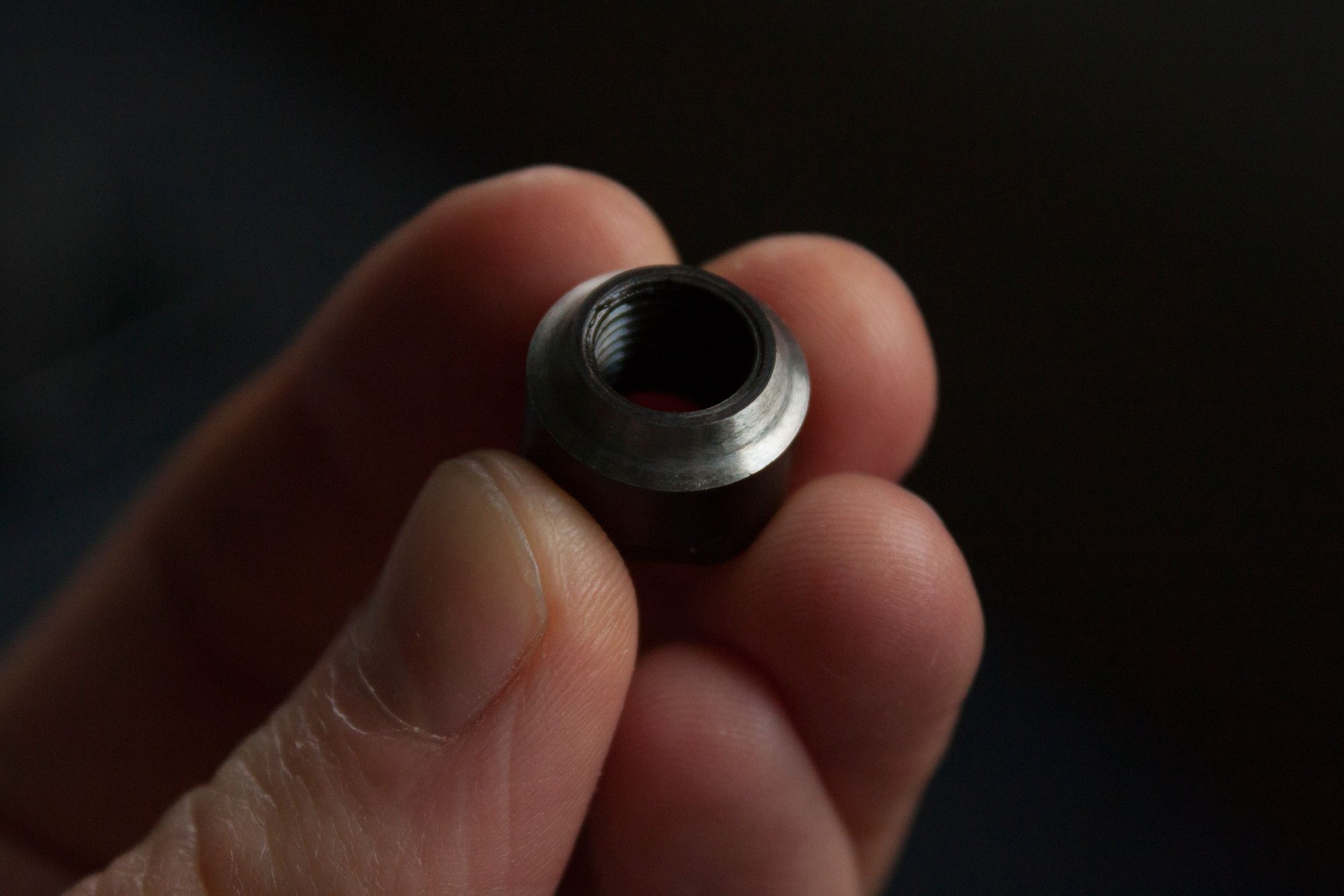

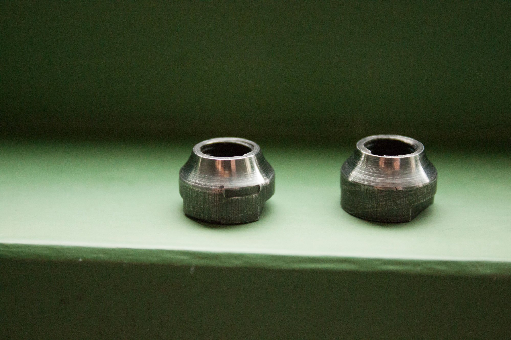

So, I have ordered some front axles in order to see if I can find other replacment cones for Normandy hubs. This one comes with cones almost identical to the ones I found in the front hub (see my post above). They are probably a little wee longer. I think those axles/cones are identical to the ones from Cyclus, those are even named Maillard, so supposedly they are meant for French hubs. Not sure about the quality, but what I didn't like is quite rough bearing surfaces.
After reading this article on how to repair pitted cones, I went ahead and decided to polish the cones I've got. A hand drill and some pieces of sanding paper wrapped around an extra axle and here is the result. The cones look much better after polishing.
Polished cone on the right compared to the original one on the left
What I did next is trying to repair some old pitted cones that I have. It took me much more time to do that even though that the cones were not pitted that badly. In the end, I figured out that using a needle file is the quickest way to remove the material and get to the actual pitting and after the pitting was gone I switched back to sanding paper. The end result seems quite promising. The cones look maybe a bit rough in the pictures but in reality they are quite smooth where the balls are supposed to be. I'll be testing both pairs of cones to see how they behave.
All the pitting is gone
