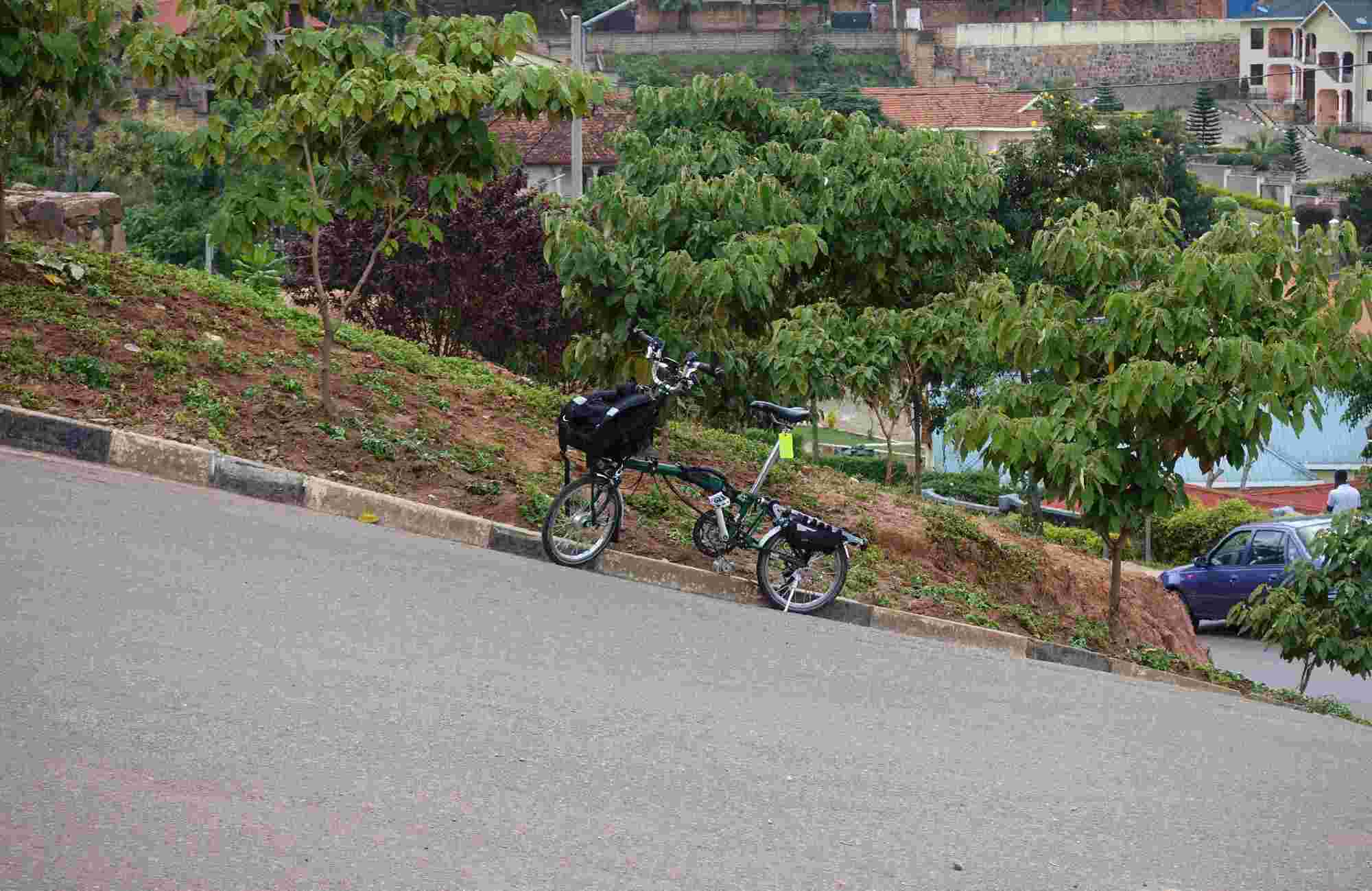

I borrowed the photo from another thread and it shows the type of vicinity where I work every once in a while. For this, I built up really low gears and the lowest one now gives 1.06m of development. It is useful for transient periods such as steep turns. My guess is that your 33% is just such a transient. For prolonged rides straight up such a gear is not really useful, as you begin to roll back during the half-turn of pedals, before you manage to complete that very half-turn. My next lowest gear yields 1.30m and, in my memory, is already useful for prolonged straight rides up. When you enter the hiccups, it takes less effort to walk and you are faster walking. I hope this helps in providing you with a boundary.
In-between the coffee place and bank
