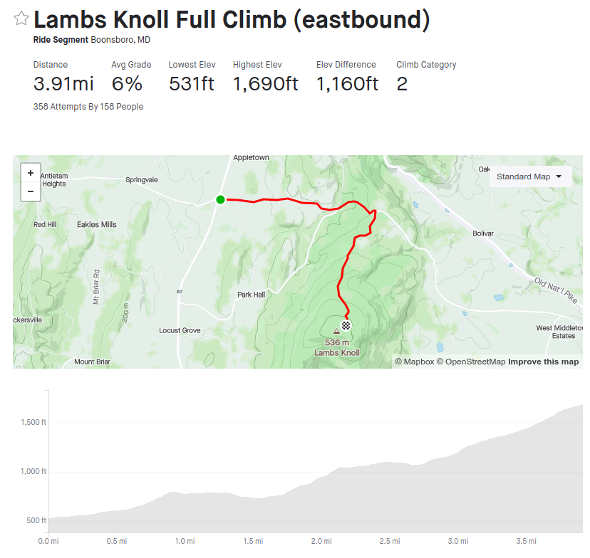

For "significant grades", I'm thinking about a local climb called Lamb's Knoll. The grade hits 18-19% in a few sections and it's just impossible to keep an adequate cadence without good gearing. The total elevation for the climb is about 1000 feet. 1000 feet is pretty typical around here for "low mountain" climbs.
I need gearing for a climb like this:

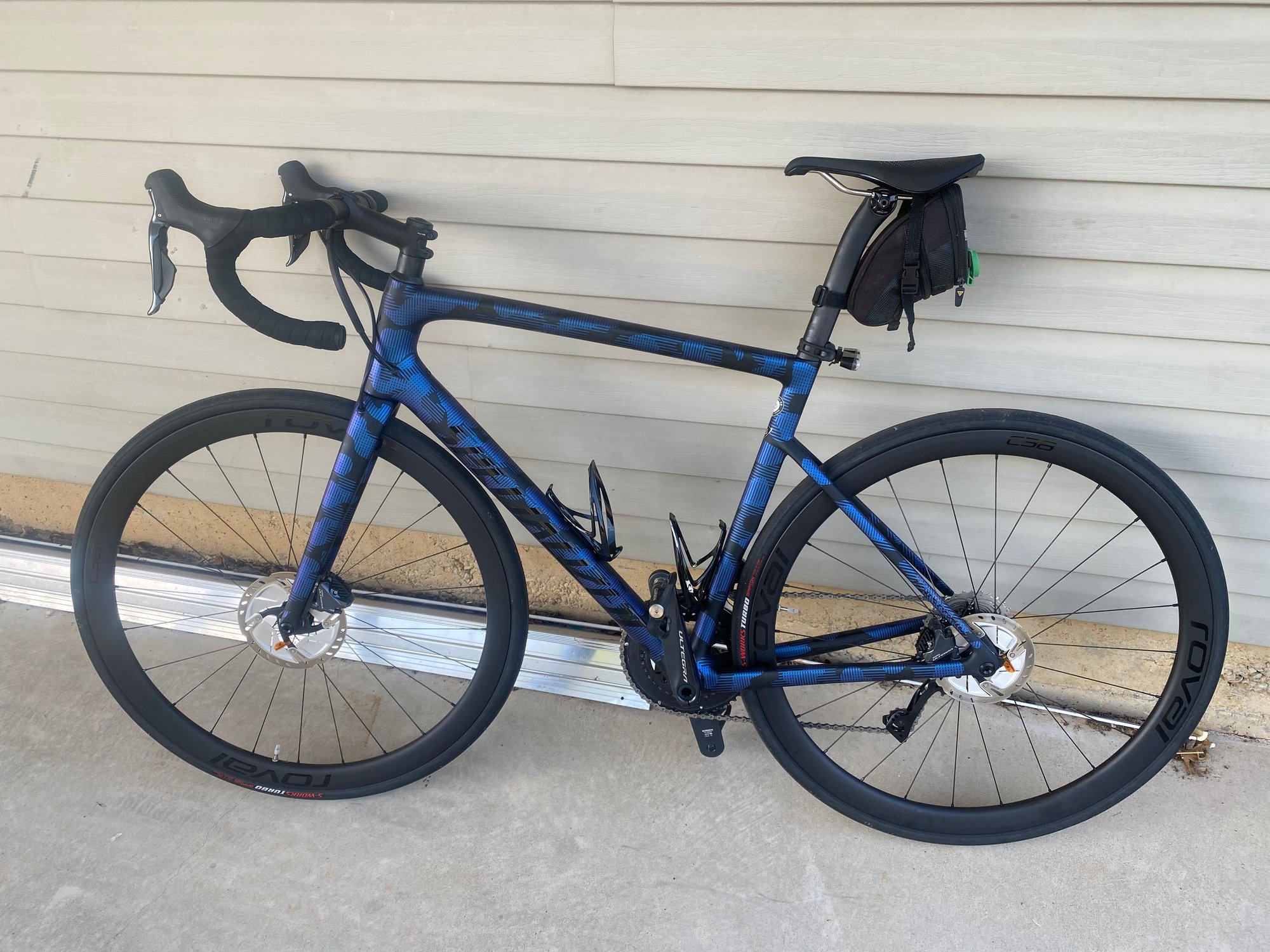

I ended up pulling the trigger on this bike. It's a Specialized Tarmac Expert Disc. The shop had no problem swapping out the 11-30 for the 11-34. I went on my first long ride with the new bike yesterday and I have to say I love it. I'm still getting a little used to the Di2 shifting, which seems to operate slightly differently than mechanical when shifting to a larger cassette or smaller chainring. I'm sure it will be second nature soon enough.
