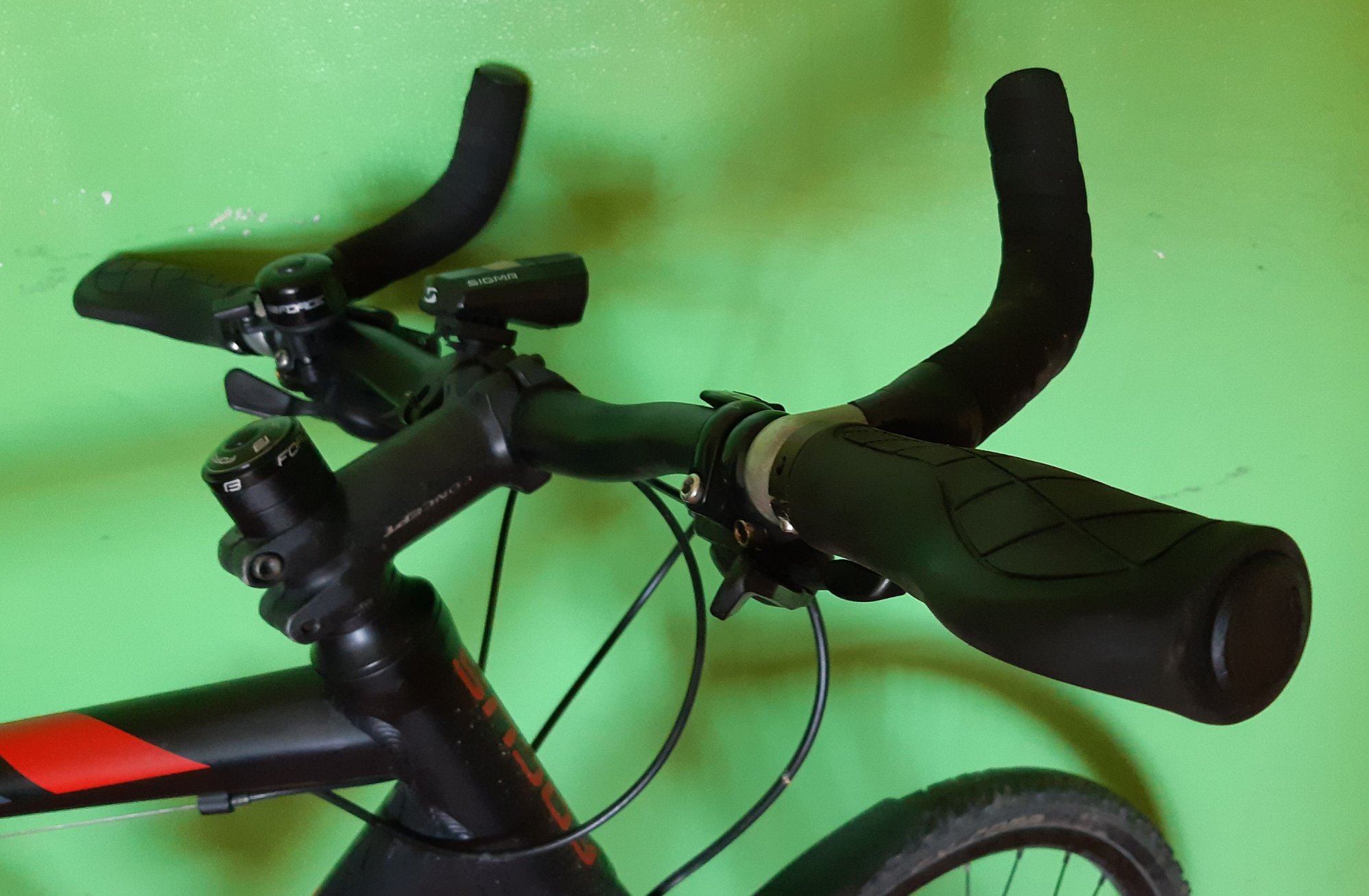

Another option:
Gives four different hand positions: grips, grips/barends, barends (low), barends (high). First two allow access to brakes and shifters (release only for the second one); third is pretty close to position on the hoods of drop bars; fourth allows for bent elbows to go lower.
