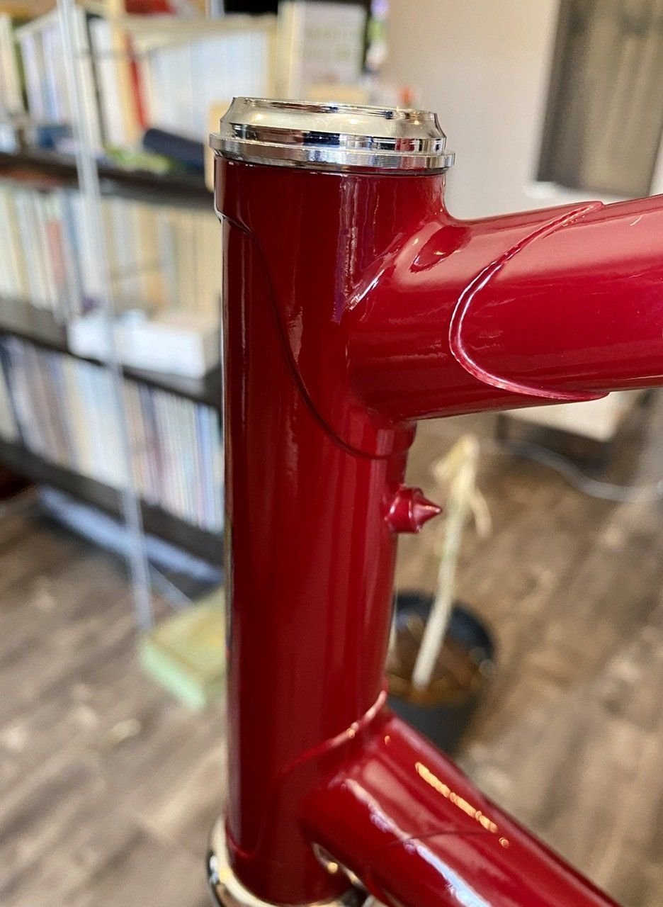

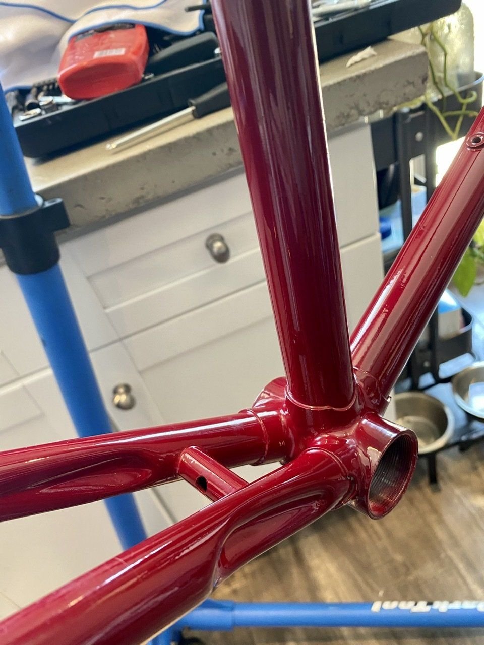

Started the rebuild process on this. So far everything cleaned up and came apart very nicely​​​​. Unfortunately the original 3S bottom bracket was pooched so the search for the symmetrical 127 equivalent will begin.
Really amazed with how well the paint came up.

Is this the 60 or the 57, a little hard to tell somehow. Really looks like a 58 haha. As you saw in my other post, I'm also building one of these up and its the 57. Now, I am 5'"11 and I typically ride a 58, but some frames I really want only came in 22.5, so this is going to sort of me by testing ground as to whether when I drop money for those frames I go for the 22.5 or up to the 60.
Yours looks equally as immaculate as mine. This paint. holds up so well. Did you use a polishing compound on the chrome and metal bits? What polish/wax did you use on the frame?

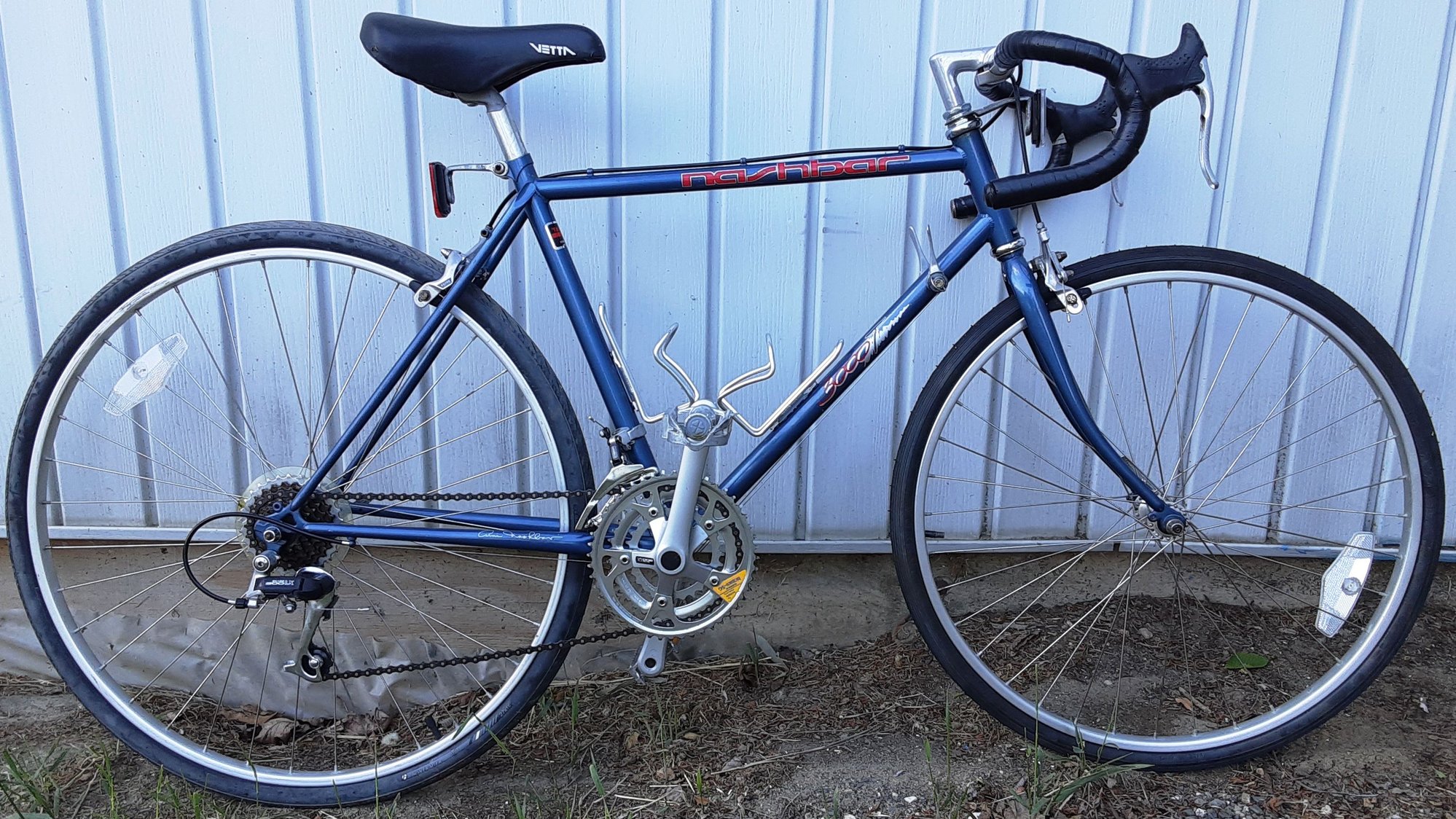

Here's mine. I like how different this burgundy shows up under varying light.

I used mothers polish and finished with turtle wax. I cant take too much credit as even with a wet paper towel the paint started coming out nicely.
I am 6'2" and I've set my lower limit at 59cm, but even then with a longer stem and seatpost. You may be alright with the 22.5cm if you can get a taller stem in the end.

That is good to know. I was able to dig up a 122.5mm UN70 bottom bracket from a box of parts which would have been the 3N equivalent. I may put a spacer on the drive side and see if that works ok. I'll keep you updated with how the chainline works out.
Narhay is offline
The FC-B124 crank inner chainring bolt heads barely do not clear the chainstay with a 122.5mm UN70 bottom bracket. I also managed to crack the thin aluminum flange on it during install so that probably didn't help.

Wrapped this one up just now. New panaracers arrived and I was able to find a UN55 BB locally.
