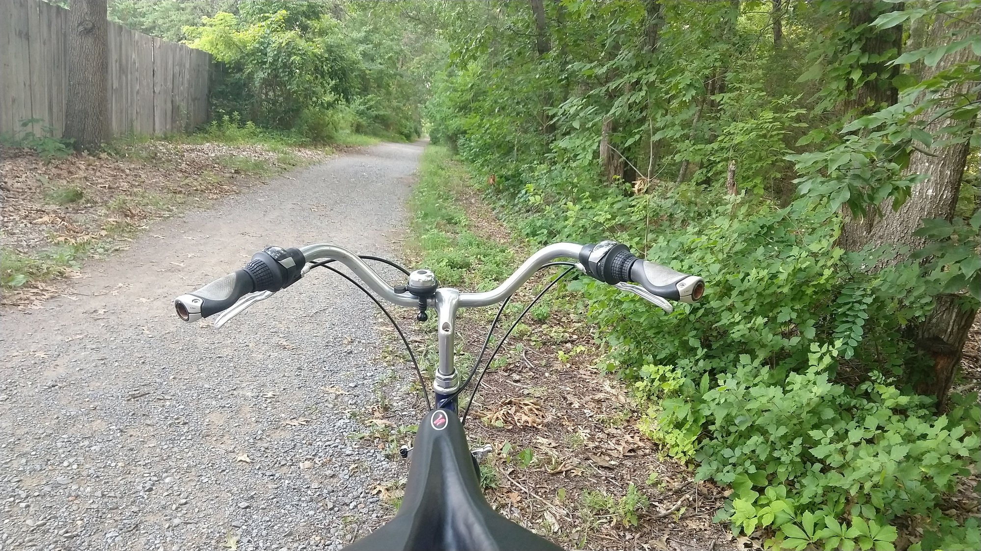

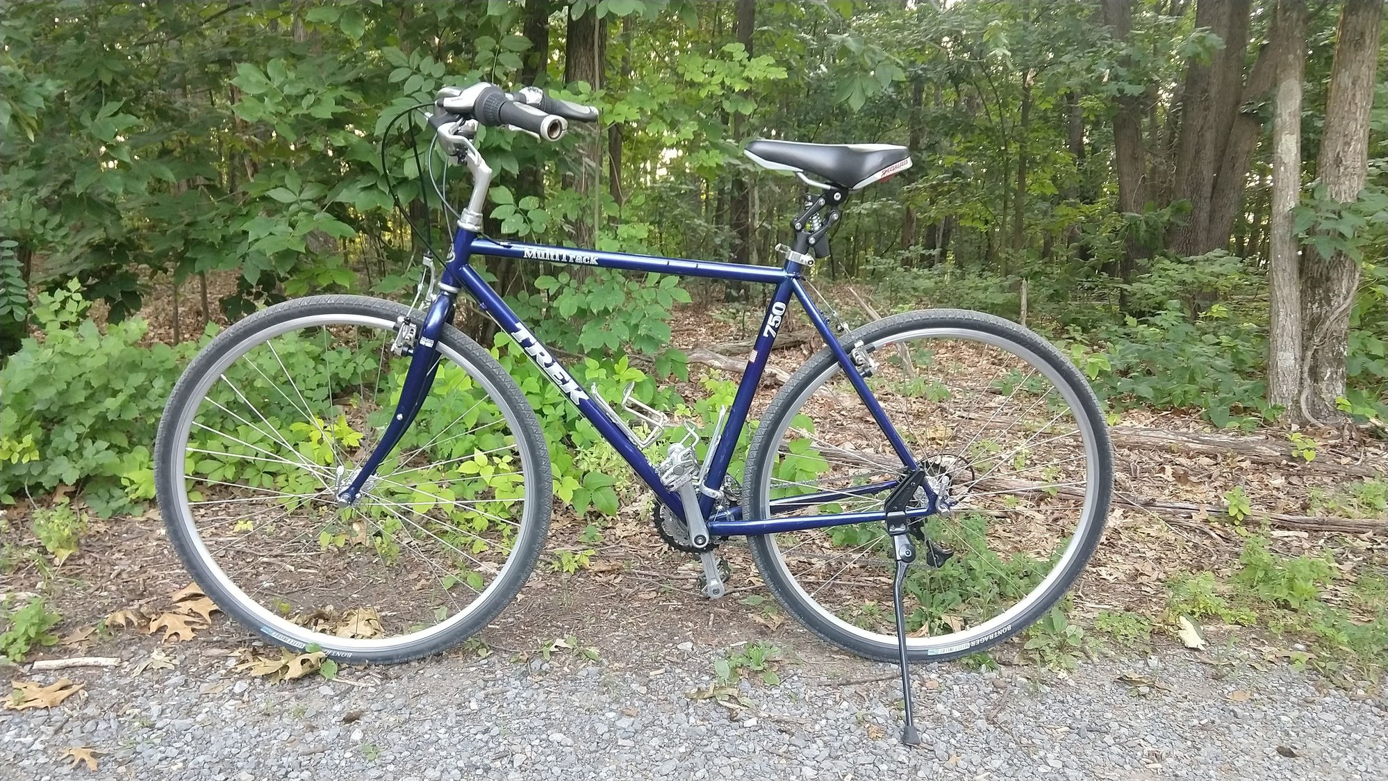

Old 06-24-20, 01:13 PM
  #452
leftthread
leftthread's Avatar
Join Date: Aug 2006
Location: Land of Cheese
Posts: 1,079
Quoted: 111 Post(s)
Liked 213 Times in 105 Posts
Any thoughts on adding Jones H bars to a 750?
leftthread is offline
I've put sonoma osprey bars on on my 730, very comfortable.
whewdoggie is offline

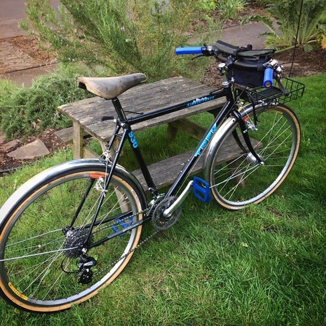

I have a 750 running Nitto Albatross bars on a tall Nitto Technomic stem - see pic.
BUT I also recently built up a Trek 930 which is the similar era MTB cousin to the 750, also US made, also lugged True Temper tubing - as a 650b conversion using the Tektro CR 720 cantilevers and I slapped a Jones bar on it and it's a hoot.
Pic included.
So if you want to try one on a 750 I say go for it!
mtmann is offline
Interesting -- so the 720 cantilevers had enough adjustment to reach the 584mm wheels? I presume the 930 originally came with 559s. That's a 12.5mm difference in the rim brake track radius...but cool that the 720s had enough adjustment. I'm running the CR 520s on my 750. These Tektro cantilevers are darn good brakes (with better pads).
hokiefyd is offline
Yes, The Tektro CR 720 cantilevers have developed a reputation among those who do 26" to 650b conversions so I thought I'd give them a try. I don't think there's any real merit in 650b over 26" for a cantilever mtb frame, but I had a set of 650b quick release wheels from a bike I wrecked, and a Trek 930 frame I got super cheap so decided to give it a try. The Tektros look great, don't cost much, and perform surprisingly well. I had read at least one comment complaining about the stock pads so I swapped them out for salmon Koolstop pads before I even took the bike out. I've ridden it on single track and braking performance is superb - like the bike was designed for those brakes.
mtmann is offline
Old 07-06-20, 12:51 PM
  #459
hokiefyd
hokiefyd's Avatar
Join Date: Feb 2017
Posts: 4,141
Bikes: More bikes than riders
Quoted: 1446 Post(s)
Liked 762 Times in 570 Posts
I will say the pads that came with my 520s (probably the same ones) were not great. I swapped those for a set of the Avid 20R pads that used to come with their Single Digit series brakes. I find these pads to be very good in nearly all conditions. I used them mostly because I had them. If I didn't, I probably would have bought the Kool-Stops like you did.
hokiefyd is offline

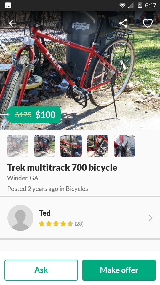

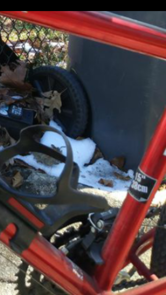

Old 07-16-20, 04:28 PM
  #466
ja1124
Join Date: Dec 2017
Location: Sautee Nacoochee, Ga.
Posts: 44
Bikes: 1993 Giant Rincon, 1993 Trek MultiTrack 720, 1977 Raleigh Super Course, Giant Innova, 1995 Trek MultiTrack 700 (stolen from my possession but still mine!)
Quoted: 18 Post(s)
Liked 12 Times in 8 Posts
15" Multitrack 700 found on Offer Up
I had this in my watch list (because one never knows when one will meet that short special someone who will become one's riding companion). Price just reduced.
ja1124 is offline
