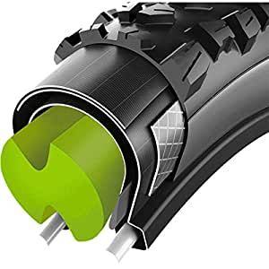

I have a relative that is a very big guy, about 6'7" tall (literally) and I'm guessing is well north of 250 lbs. He's what I'll call a "simple guy" in that he's an adult that still lives at home (he's not capable of living on his own) and his very well-used and old mountain bike is his only form of transportation. As you can probably imagine, a guy that big is always dealing with flat tires when using regular tubes. Being an avid cyclist myself, I'm always trying to find ways to help him out but at the same time not make his life too complicated. For example, I run tubeless tires on my road and mountain bike, but I know there's no way he'd be able to run tubeless. He'd get way too frustrated trying to setup the tubeless system, not to mention his bike is way too old to even support tubeless tires to begin with.
I considered getting him solid tires to eliminate flats, but I can only imagine there's a handful of issues with solid tires... of which comfort is probably the first.
In researching ways to prevent flats, I ran across the Armour Tannus No-Flat Bicycle Tire Insert which certainly looks interesting. It clearly protects the tube a bit more, but is a bit pricy and I'm not sure if it would be too big of a hassle to install to even consider. Do any of you have experience with something like the Armour insert or something similar? I see there are also various types of thorn-proof tire inserts which might be a cheaper alternative... but only if they work and aren't too difficult to install.

The Vittoria Air Liner looks like a simple solution for him, but dang... what an over-priced piece of foam! Makes me wonder if I can just buy one of those foam pool toys from WalMart and stuff it in a tire for way less money!
I get the feeling you think this replaces the tube to support the tire, but it does not. Rather, it's interior armor against casing and rim damage for use along with tubeless
