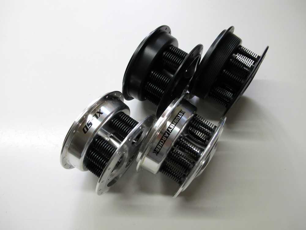

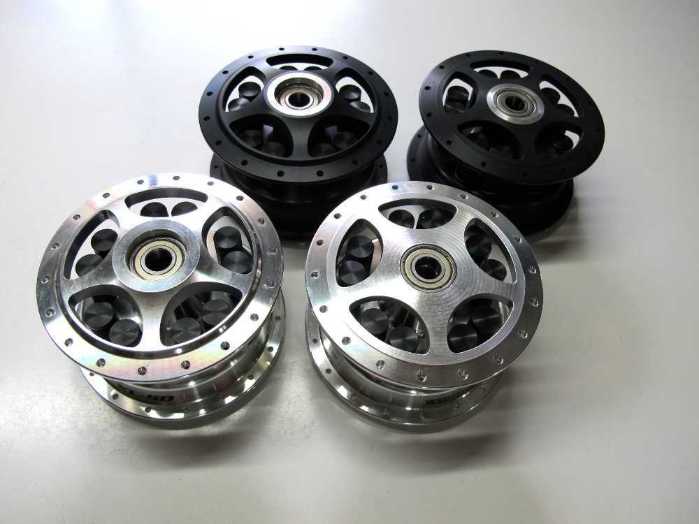

While I am waiting for the weekend before I can work on the bike some more and take another shot at the rear fork I was looking back at something I came across a few years ago; hydraulic drum brakes.
There is a small company in Taiwan that makes the Pavolution Keeper, essentially a slot in piston for Sturmey Archer drum brakes to offer lighter braking.
Originally designed for trikes and velomobiles where lots of people prefer drum brakes over disc brakes in mountainous terrain. Anthrotech in Germany offers a modified Magura piston for their trikes as well.
Though often they use customized drum brakes with ribbed cooling bodies which are virtually impossible to overheat from GinkGo-Veloteile.
I don't suspect it is necessary and they seem hard to come by but my engineering heart does flutter a bit over the thought of something as silly as this.

GinkGo Veloteile air-cooled drum brakes 90mm top view
GinkGo Veloteile air-cooled drum brakes 90mm side view

Me, I'm planning on building a new front wheel around a XL-FDD 90mm dynamo hub because I like running lights all the time. The XL-FD (non-dynamo) is only slightly cheaper but does look a bit sleeker.
What do you plan on using for the new rim? The old 650A size is hard to come by nowadays but maybe you will have better luck with 650B wheels in France? 700C should work too but will limit your tyre size.
