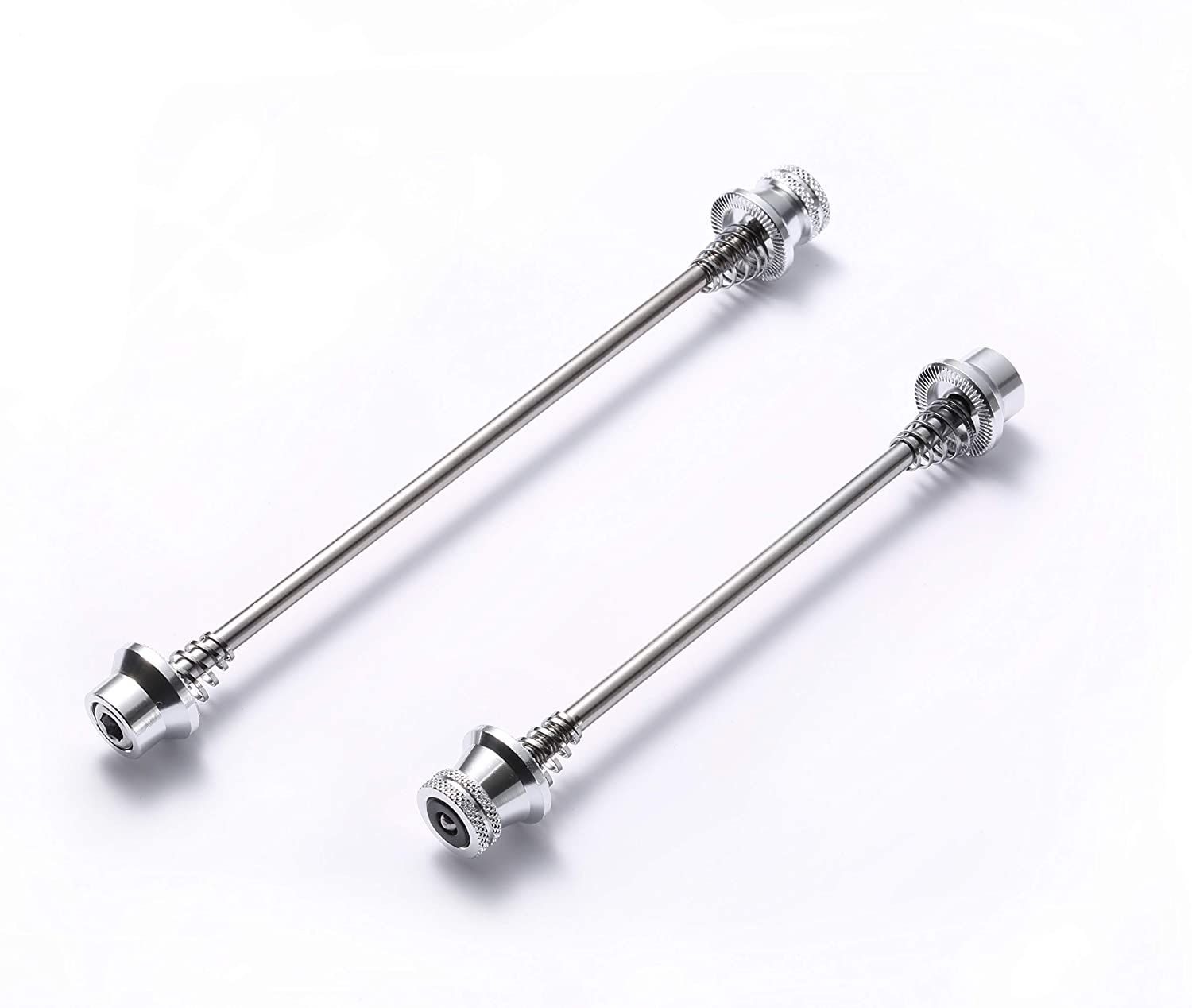

My favorite skewers are Paul Components or DT Swiss RWS but if I was looking to save money Shimano is fine and really anything in the right width that is an internal cam is going to be better. Our good friend Sheldon Brown explains everything quite well here
I like Salsa and Phil Wood, they make some great parts and frames and such (I know a bunch of their stuff) but when it comes to QR skewers they make crap. pretty crap but crap.
Nice thing with Paul skewers is they are probably in stock and if they run out they can make more easily without the COVID delays in Asia. I mean in addition to them being fantastic levers, having some different colors and working extremely well.

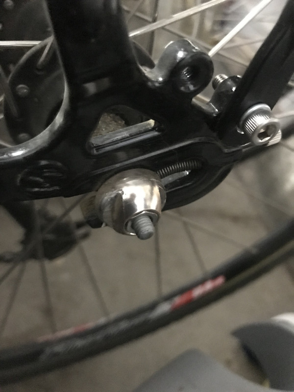

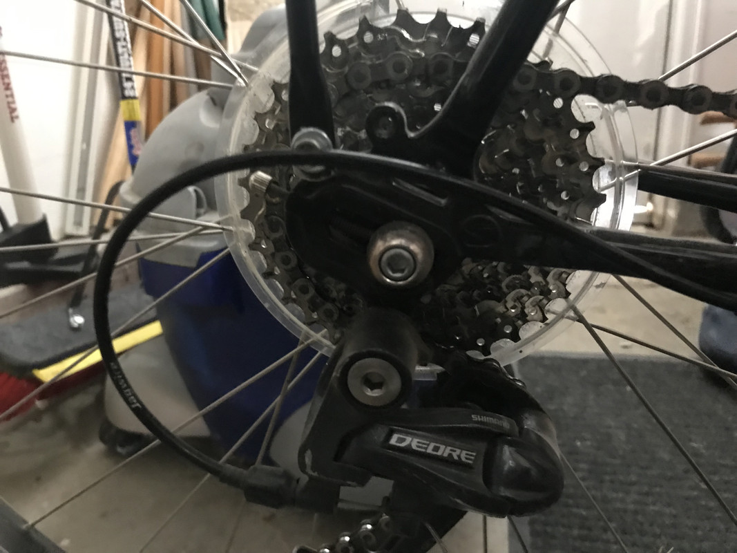

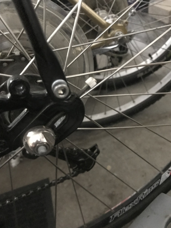

There is a hex bolt head where one might expect to find a quick release lever. If you get an all-steel one, you can really crank the thing down hard, which I suspect is what the previous owner was doing, if I am guessing correctly from your description.
You're exactly right. I should have examined it more closely but I wasn't riding when I noticed it. I just looked down and happened to see it in the garage and thought "that's not right!"
@veganbikes, thanks for the links. I will check those out as soon as I post this message.
Here's what I have. Thanks again to everyone. Perhaps others will learn from my ignorance.
I saw this at first and thought the lever had snapped off.
Now I see that nothing is broken and that's a nut with flat sides for a wrench to grip.
And a 5mm wrench fits in here nicely. Mystery solved!
