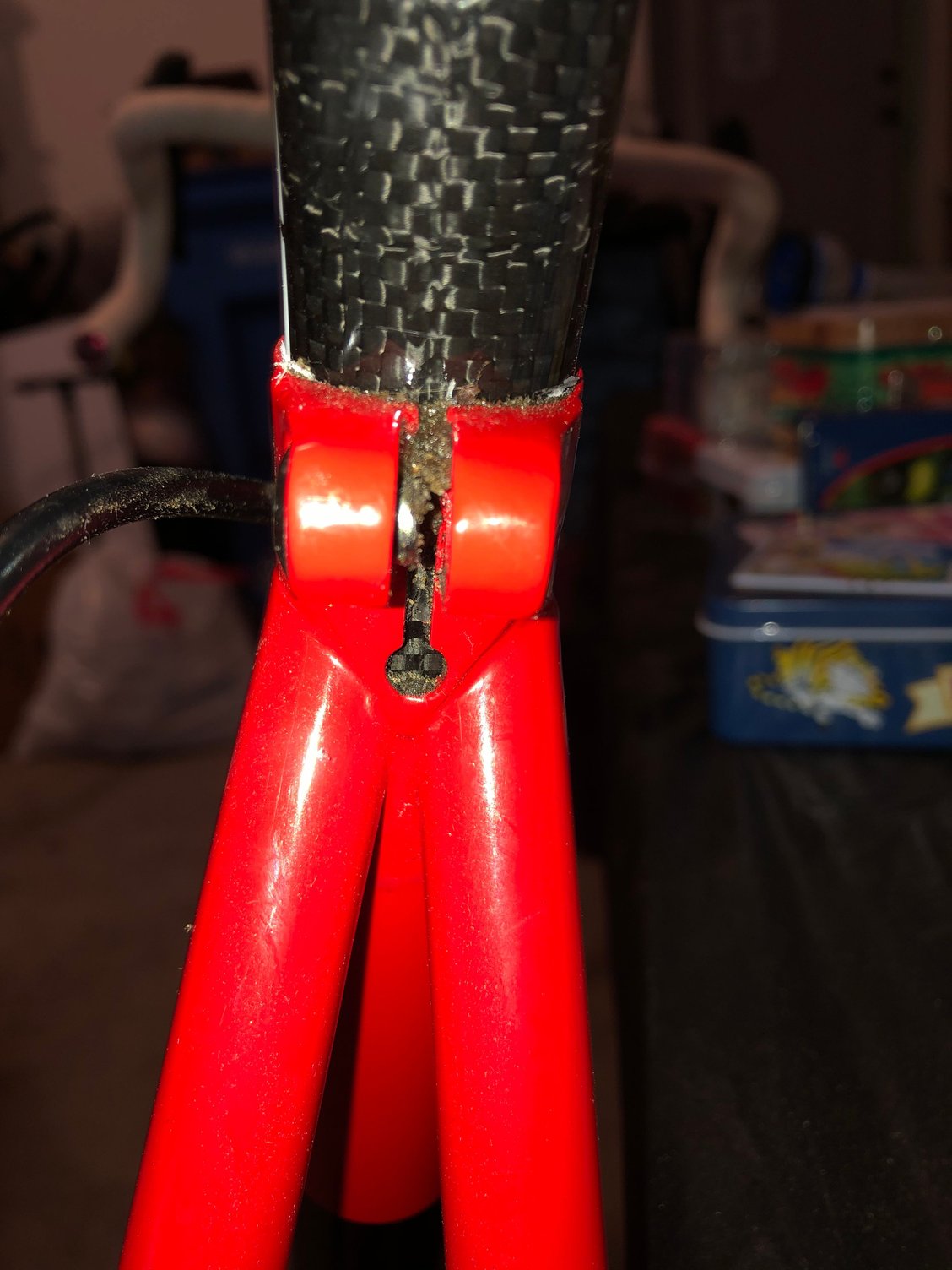

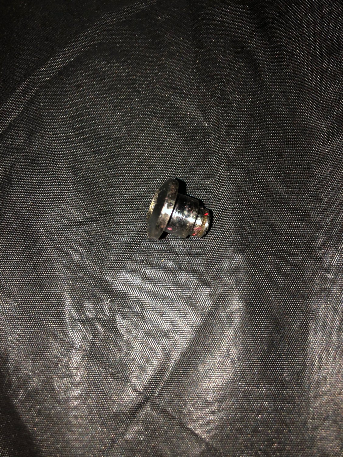

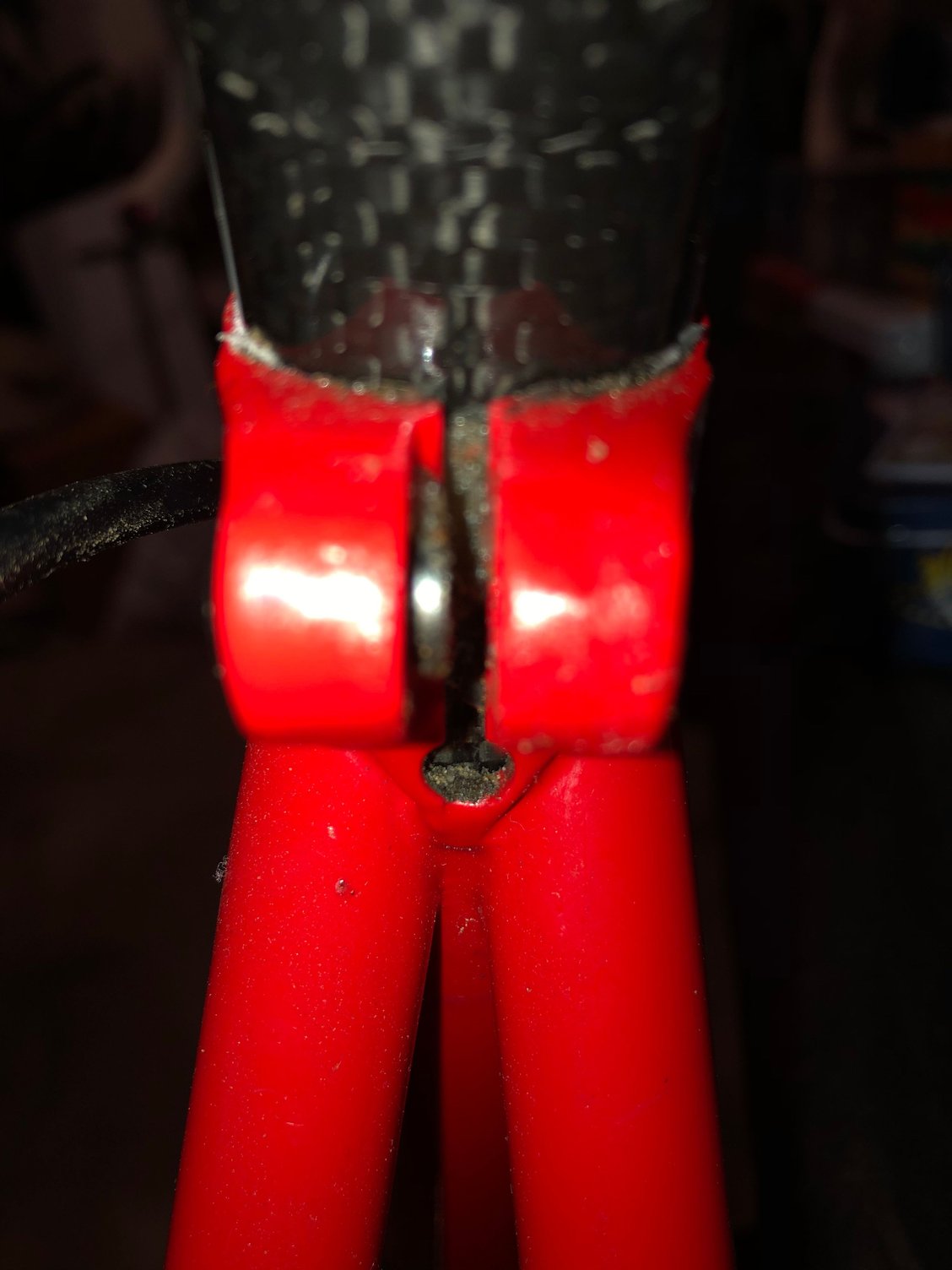

Ladies and Gents, I was not paying attention as I should and not using my torque wrench and I overtightened my seatpost binder bolt on my Torelli Nitro Express steel framed bike. The part that did not break off into my hand is still on the bike and Im not quite sure how to get it out. Suggestions would be helpful. Photos below of sheared bolt headband the area in question. Thank you.
Nut end and partial bolt still stuck on bike
Rear view of area
Rear view of area again
Sheared off bolt head and partial bolt that snapped off into my hand

...it should tap right out with a pin punch of the proper size and a small hammer. This is a pin punch.

The first thing I would do is see if needle nose pliers can fit in the gap, maybe even forceps, to see how easy it is turn the remainder of the bolt. If it easily moves see if you can back it out.
You might be able to drill a hole to thread a screw, from the opposite side, and the drill itself might turn the bolt and remove it.
If not, put a screw in the hole and back it out.

Although you could use a punch to extract the nut with the bolt stub still in it, I would first try to extract the broken bolt stub with the nut still in place.
It's a small diameter bolt, so drilling and using an extractor would be tough.
Question is... how tight is the remaining bolt?
I broke a bolt and was able to manipulate the remaining stub with a pin to remove it.
Too tight for a pin? Can you Dremel a divot in the bolt in order to get a grip?

Thank you ! The pin punch actually worked like a charm on the second whack. Next question. Where can I get another of these ? Are they a standard size ? Any suggestions ? Thanks in advance

...theyare now relatively standard in diameter for frames like yours. They do differ in length, So put your two pieces together and use a caliper to measure the length so you don't get one too short or too long. The Campy ones have more of a reputation for snapping than the Asien made ones, like sugino. But I don't know whether you have a keyed opening, so you might want to stick with the Campy type if you don't want to file in a little slot for the key in a keyed binder bolt.
