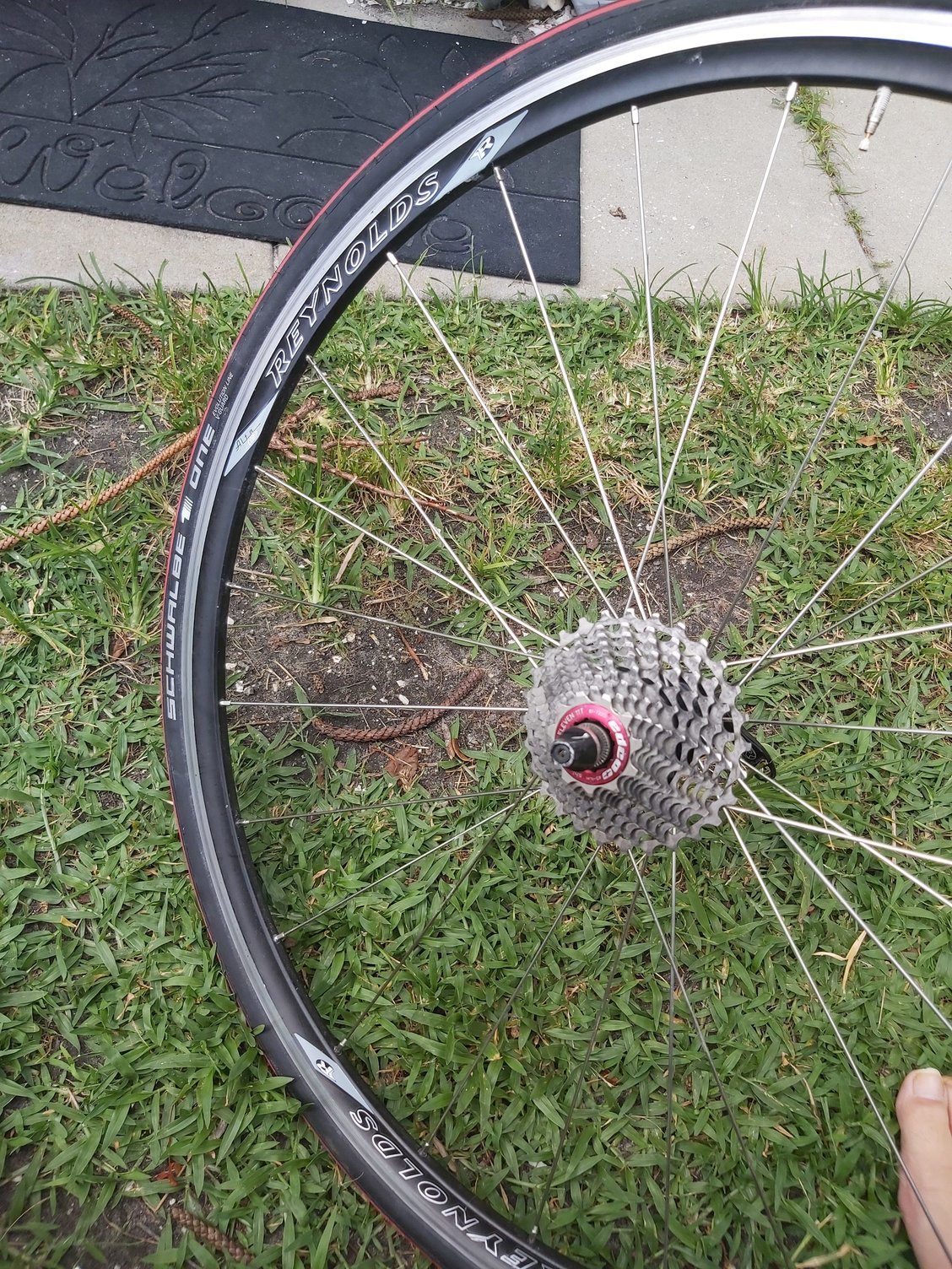

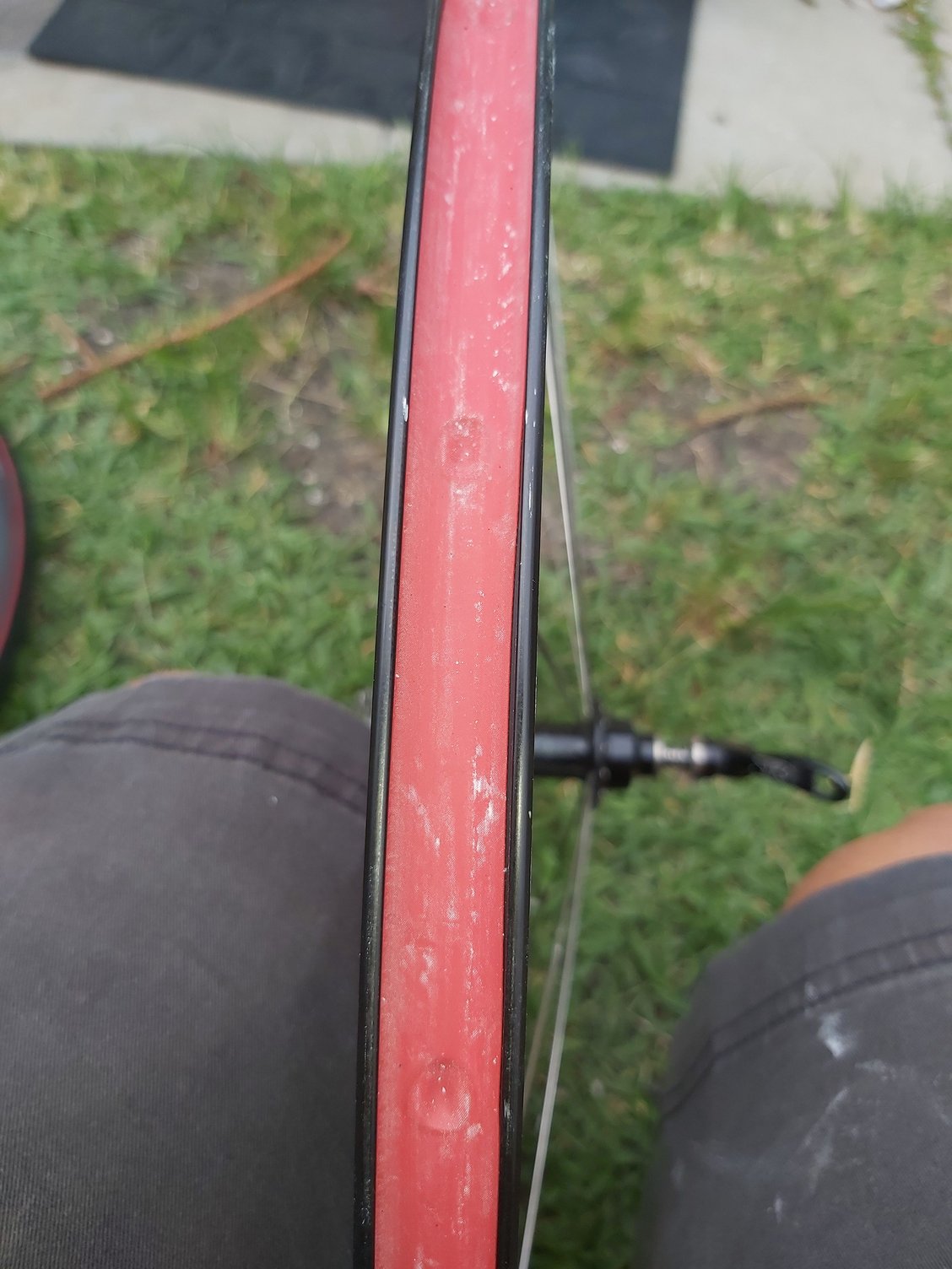

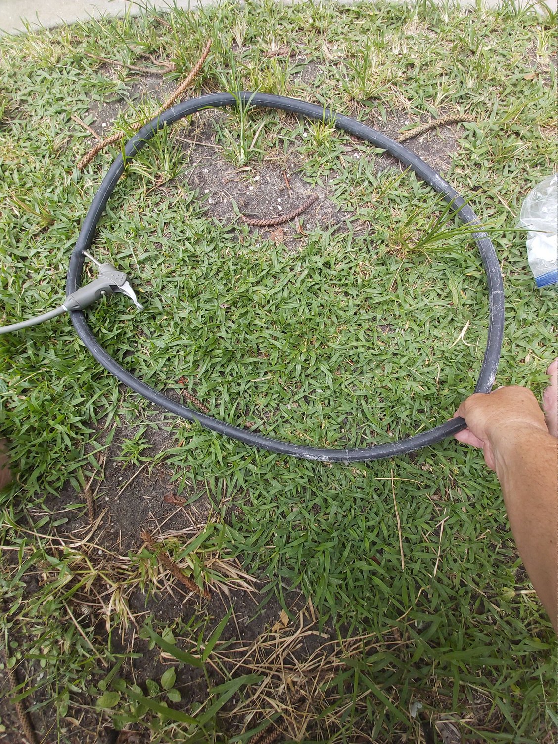

Ok , ok took some photos and I think I have a clue from all the comments helped me .
Showing my Rim . Tires are brand new very good quality, no holes.
Welp.... For the life of me I dont know why I took off the original cloth and replaced it with this cheap sh*t but I think its my clue.
Pumped up innertube with hole in it . Heard it leaking and followed the hiss. It is coming from where my hand is about opposite side of where valve is .
Hole is where my thumb is ......and yup it appears to be on the inside, unbelievable !
Here are the photos .

I do not see any holes in the cheap plastic rim cover so I am not exactly sure how the innertube tear happened but the plastic literally sucked thru the holes causing concave dimples . I would never run my tires less than 100 psi. Too mushy for my taste and I'm currently about 200 lbs.

That looks like a pinch flat, tube caught between rim and tire.

Rage all you like against flats if it make you feel better but just accept that flats are random events. No pneumatic tire is impervious to punctures. Some do a good job but nothing is perfect. Shout, yell and curse the gods all you like if it makes you feel better but in the end, youíll just have to realize that flats happen.
As for your particular problem, that looks like the tube extended down into the spoke hole through the rim strip. The rubber probably looks like it has a little pimple in it towards the rim. Iíve been having this issue a lot lately as well. I have not been able to find the part of the rim strip that appears to be weak and have even changed rim strips. At this point, it has happened so often that Iím not convinced that it is a rim strip problem. I have always worked under the idea that tube are expandable and have used undersized tubes but Iím beginning to think that the rubber being used for new tubes isnít as flexible as it once was. The tubes arenít expanding as much as they should and they are tearing at the spoke hole where push down into the rim strip. Iíve been using larger tubes (closer to the size of the tire) lately and, so far, they have worked where Iíve tried them.

I wondered if plastic rim strips get pushed into the rim's spoke holes under high pressures but the strip isn't expanding, it's shifting. So the edges are pulled from the sides of the rim and thus are more exposed to the tube. Just an idea I've thought about. Andy

Well, to be fair, you can only see it when there's 0psi pressure and you have the tire off. Sure, no apparent holes or tears in the tape, which is fine. But that doesn't show how sharply-defined the edge is when pumped up.
At 116psi, those sharply-defined edges on all the spoke holes are going to be quite "edgy," with a very thin material for the "protector" tape. Tube's going to be sucked right down onto those holes, hard.
The thing about the Velox cloth tape is: it's pretty thick stuff, compared to most other similar products. Even at 100+ psi, it's going to round out those edges nicely.

Ok I got the Velox cloth tape ordered. I am having difficult time find inner tubes. Since I am running 25mm tires for first time ever I am trying to find 25 mm innertubes with a 60mm valve. I am only finding 18- 25 ( which to me sounds like it would stretch to thin for my high pressure ) and the other is 25 - 32 ( seems excessive ) why not just a 25 mm for sale ? Any suggestions and links ? Thanks.
Ilovemyride is offline
Either is fine but I would go with the 18-25 version for less bulk and weight but not much in it really. Most of the world has been using tubes manufactured this way for decades so no sense overthinking it. Choose one and enjoy the ride.
Schwalbe Tube Finder search tool @ SchwalbeTires.
From the search list, here are four that might suit:
P/N = 1042-7363 -- SV 15 60mm; 700 x 18-28C (28 x 0.7-1.1'', 27 x 7/8-1'') (18-622, 20-622, 22-622, 23-622, 25-622, 28-622, 22-630, 25-630); Presta 60mm; Standard; 105 g; $10.02
P/N = 1040-0103 -- SV 20 50mm; 700 x 18-25C (28 x 0.7-1'', 27 x 7/8-1'') (18-622, 20-622, 22-622, 23-622, 25-622, 22-630, 25-630); Presta 50mm; Extra Light; 65 g; $12.29
P/N = 1042-6363 -- SV 20 60mm; 700 x 18-25C (28 x 0.7-1'', 27 x 7/8-1'') (18-622, 20-622, 22-622, 23-622, 25-622, 22-630, 25-630); Presta 60mm; Extra Light; 65 g; $13.49
P/N = 1042-6383 -- SV 20 80mm; 700 x 18-25C (28 x 0.7-1'', 27 x 7/8-1'') (18-622, 20-622, 22-622, 23-622, 25-622, 22-630, 25-630); Presta 80mm; Extra Light; 65 g; $15.56
This seller on eBay seems to have some in stock, in the 60mm valve size: click.
