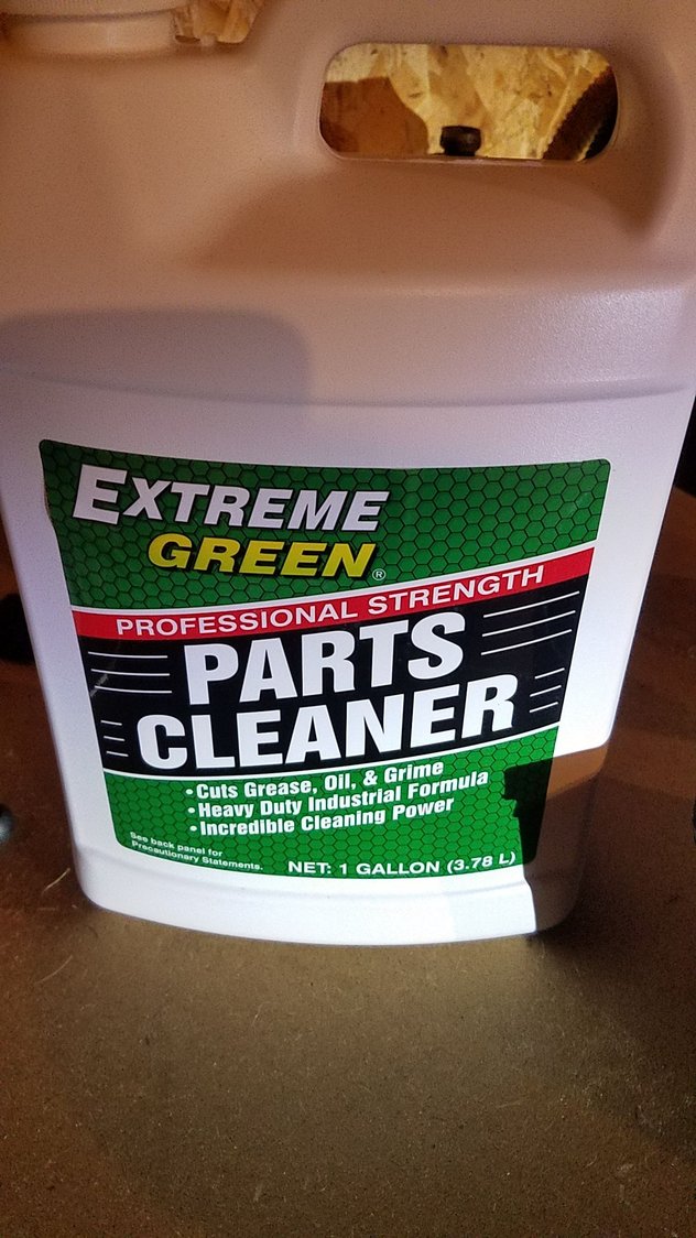

Maintenance
Yes I have a Marin Rock Springs 2 that I use for general trail riding. Right now after I go mountain biking I put degreaser on a grunge brush and brush down the cassette then I wipe it down with some paper towels. After that I do pretty much the same thing to the chain. Finally I lube the chain shift all the way up and down, let it sit for a minute or two and then I wrap a paper towel around the chain then run it through it.
Is this the right approach; do I need to do more; how often?

Can someone please explain how degreaser will damage sealed bearings?
Spartan...you are fine doing what you are doing with the brush and degreaser. I do the same myself and I will also pull the cassette off a few times a year and soak it in degreaser and brush it and wipe it down. I'm actually doing that right now with one of my cassettes.
The only way bearings are going to get destroyed on any bike by spraying degreaser or any other chemical is if they are loose ball bearings that you will find on a cheap bike.
