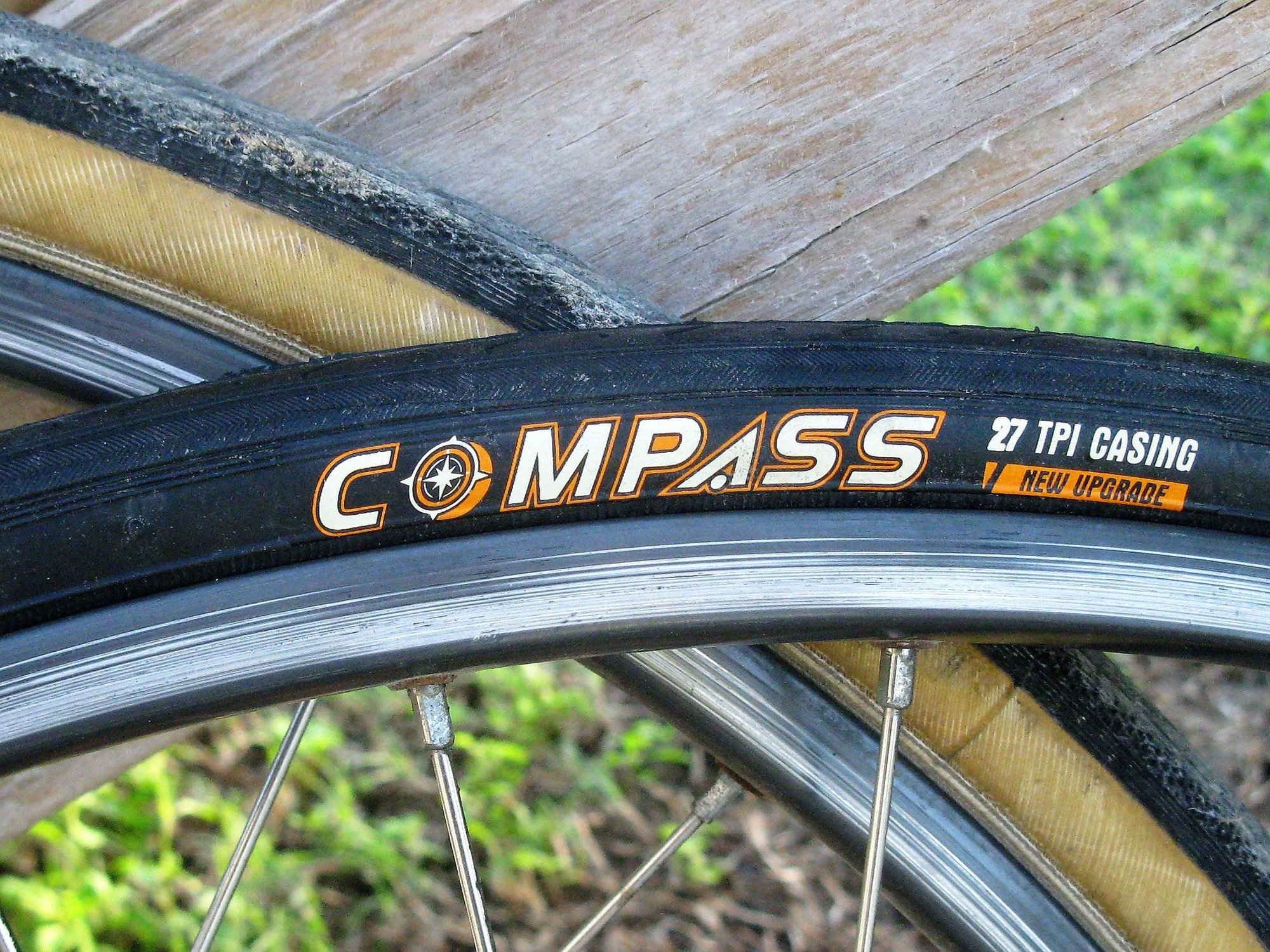

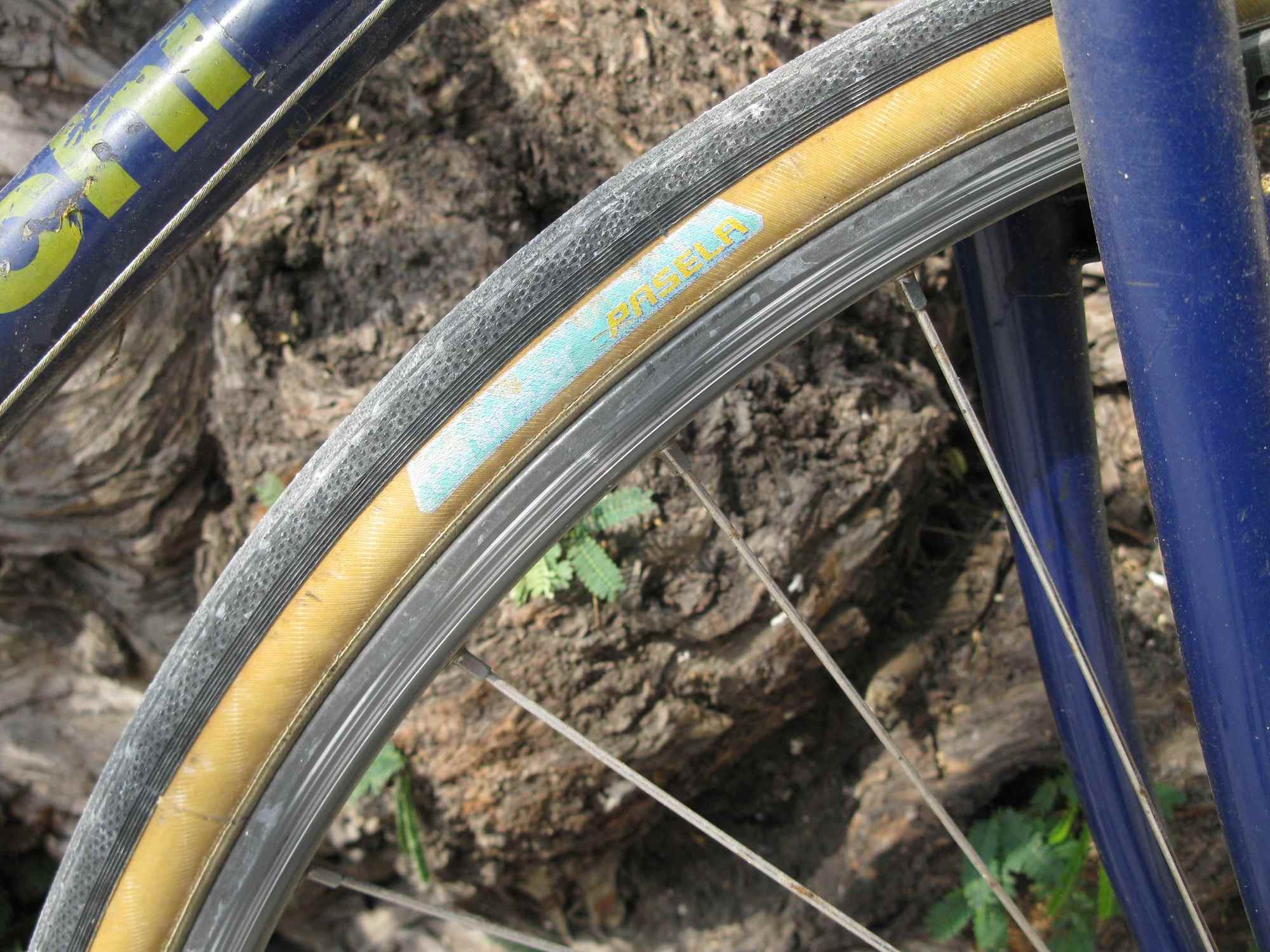

Are you sure that the tire is properly and evenly seated all the way around and on both sides? An improperly seated tire will feel like a bump every time around (had this problem super pronounced on my Jamaica motorcycle). So...
Take a close look at where the rim meets the tire when inflated. Look at the relationship and see if the line, closest to the rim, is evenly spaced. If not, that will most likely be the problem and easy to fix.
Here the embossed line is just under COMPAS and should be even all the way around both sides...
Here, the line is a lighter color, than the sidewall, but still needs to be even...
