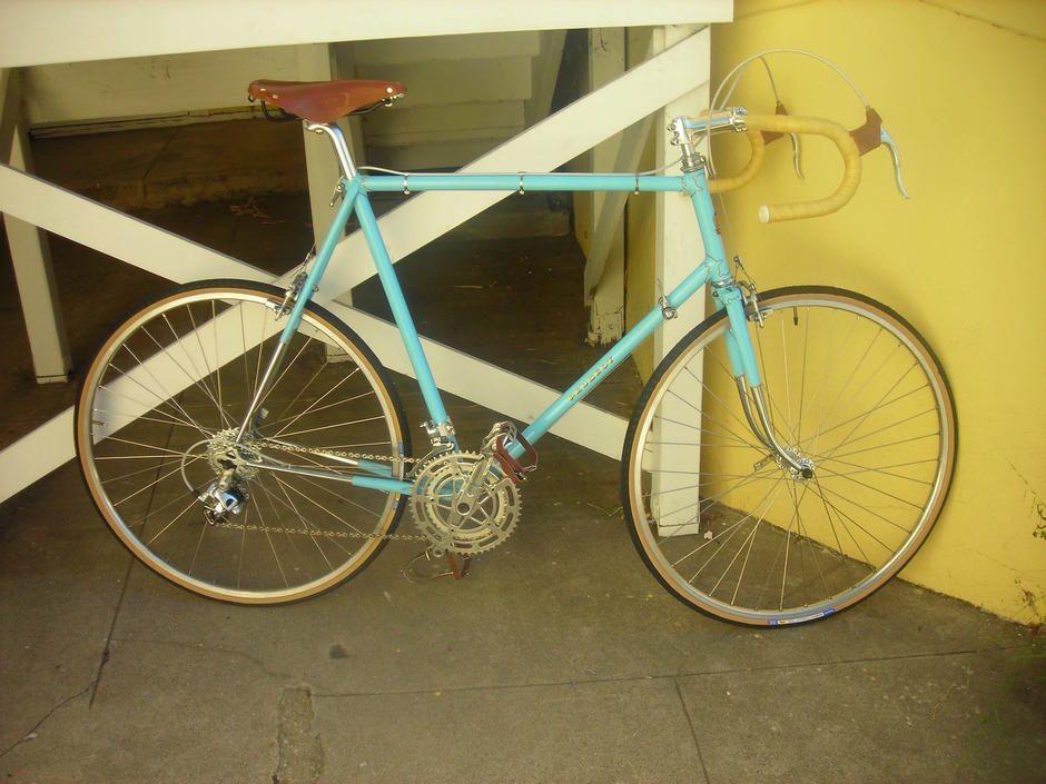

I bought one of those adapters from that seller a few years back. It's been accurately turned down, and is a high quality piece. At the time, I hadn't been riding for a while, and wanted to experiment with a more casual positioning on my PX10 build. It worked great for that. At some point it was always the plan to put a quill stem on, but I've not gotten around to it yet. It doesn't really stick out too much, if you're not looking for it. ( I guess that's arguable, )
I have no doubt finding a black French 22.0 stem is going to be difficult. By the time black stems were in fashion, French stems were very rare. If you are patient enough, one might eventually turn up. If you are on a shorter time schedule than that would entail, I agree with the others, get a stem, polish it up (sand down if necessary), and have it anodized or anodize yourself.
