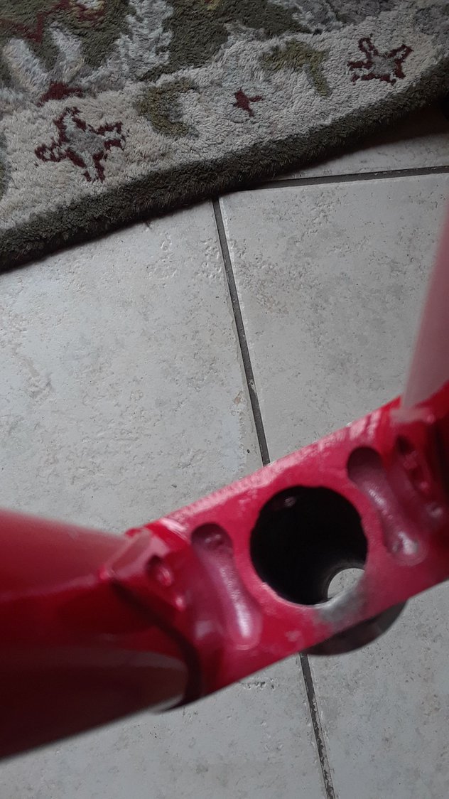

Looking for ID help with this Columbus fork. Looks like full chrome under paint, inside lug has a heart cutout and Suntour Pro fork ends.

Do I notice rifling inside the crown opening?
I almost always associate hearts with Derosa or Benotto. But not familiar enough with either to know if they ever built anything with Suntour ends & DOs
EDIT: Almost forgot about J.P. Weigle.

Rifling........yes

But, what sort of "rifling"? 'Cause I could think this might just as well be a Japanese fork as Italian, despite the Columbus decal. The forkcrown looks fairly "Tange" and a good bet the paint is not original. Not many Italian builders ever used SunTour forkends (AFAIK)!

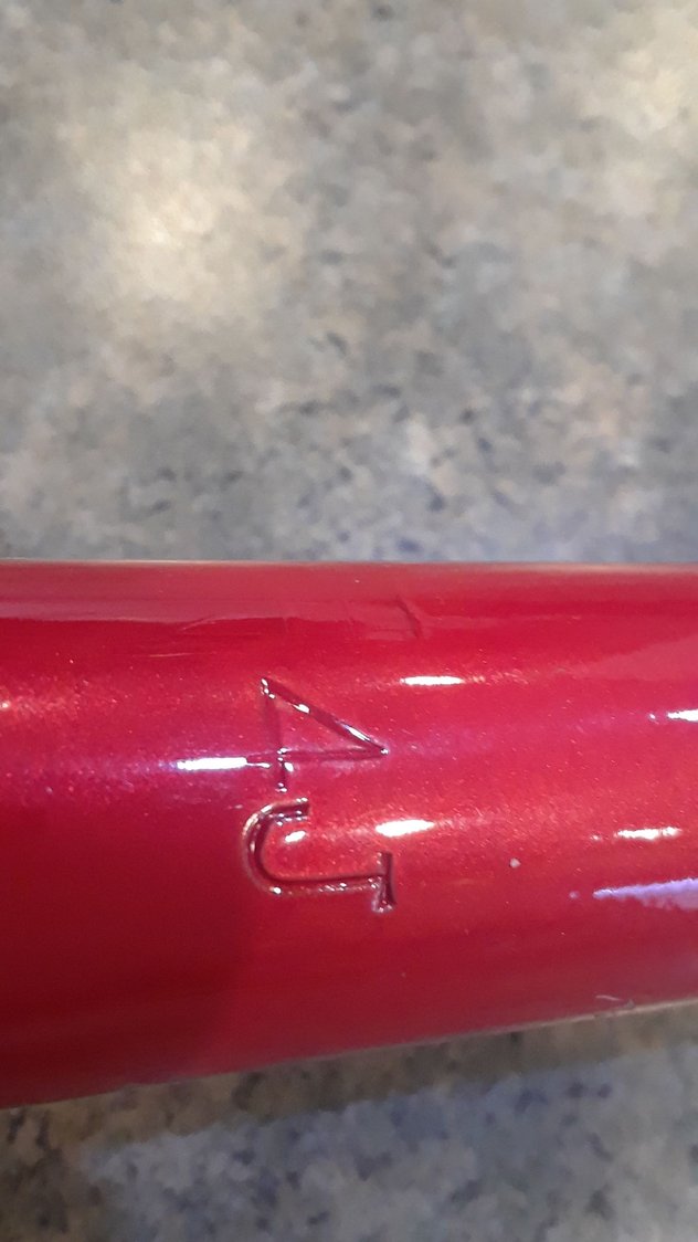

Thank you all for the responses thus far.
I did not see anything on the steerer except 4J. Upon closer inspection I now see the Columbus dove logo as well as TANGE MADE IN JAPAN. I also see 5 helical ridges inside the fork crown.
I've never seen a steerer tube with both the Columbus dove logo and 'Tange Made in Japan'. The 4J indicates October 1984 for Tange and would have me leaning towards Tange but you say there are only five ridges inside the bottom end of the steerer tube. That would indicate Columbus, as Tange used six ridges. This is definitely conflicting evidence and I'd appreciate pictures.
Tange's pre-fab operation (forks and rear triangles) was separate from their tubing mill. The pre-fab facility would build to order, using whatever tubing and components the customer specified. So it's entirely possible for a Columbus (or Reynolds, or Ishiwata) tube fork to have a Tange pre-fab stamp on the steer tube.
N.B. Tange steer tubes, from their tubing mill, were not stamped at all unless they were brazed at the pre-fab facility.

Difficult to capture these markings as they are faint. Capturing the ridges even more so.

I'm leaning towards a 1985 Schwinn Peloton.
Edit: It's definitely Tange built with a Columbus steerer which would be correct for a Peloton. The date code is October 1984 which would be a 1985 model and the Peloton was spec'd with Superbe Pro that year, which would explain the dropouts (the 1985 Schwinn catalogue states SunTour dropouts but not the model). The colour is correct, as is the blade end treatment, dropout chroming, fork crown style and absence of crown embossing. The only thing I'm not sure about is the heart cutout in the blade reinforcing tang.

r0ckh0und

Old 02-25-20, 11:29 AM
r0ckh0und
r0ckh0und's Avatar
Join Date: Jun 2009
Location: Plano, IL.
Posts: 1,481
Quoted: 90 Post(s)
Liked 76 Times in 50 Posts
That appears to be spot on........thank you kind sirs

Old 02-25-20, 11:41 AM
r0ckh0und
r0ckh0und's Avatar
Join Date: Jun 2009
Posts: 1,481
Quoted: 90 Post(s)
Here's another pic that shows the heart cutout detail
