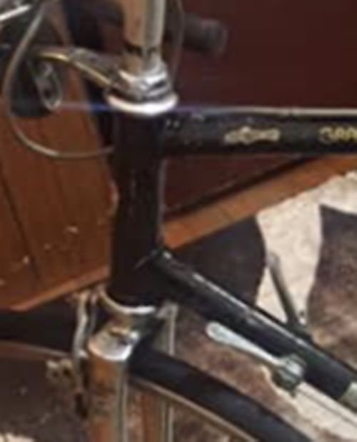

This is close to me, and at the price I'm considering buying it and replacing the fork:
https://www.facebook.com/marketplace...8240149557236/
This is clearly an '82 or '83 model with Vitus 172 frame. Anybody have an opinion on whether or not the frame itself would be compromised after a collision bad enough to bung the fork up like that? If I do this thing, what size fork would be a reasonable replacement? Would this have a 1" steerer tube?
Or do I just grit my teeth and walk away?

The good news is that you don't need to run a fork with a French steering column; you can run one with BSC threading and use an English threaded HS.
The bad news is that fork looks bad. Offer them $25 and see if they bite. Maybe you have a frame you can work with, maybe you have $25 worth of parts.

That frame could very well be compromised. Only way to know is in person inspection. With a non-French replacement fork, your headset and stem options increase. But again, be wary of any ripples or kinks in the top and down tubes. There are lots of vintage bikes out there without this kind of damage. How much of a project are you looking for?

that looks like it took a hell of a front-ender, and I doubt it was just the fork impacted. I'd carefully look at the top tube and down tube at the head tube to check for cracks in the paint, creases or otherwise.
Looks like a 1983 year. I have an 1980 GR also built w/Vitus 172 same as the one linked above. It's light as hell with a couple of minor hardware tweaks, I think that one could be quite similar.
Edit: Two other things to note, the cockpit is rubber-encased simulating leather, you'd need to cut it off to - for example - remove the stem. It's got a decent array of parts, you could easily break-even selling the parts for the ask price if the frame is trashed.

If looks like the paint has cracked and chipped off in the area immediately behind the head lugs.. Almost invariably, this is indicative of bent tubes.
That's what it looks like to me. "It's dead, Jim".

Offer $25. If accepted, strip all the parts, throw parts in box of crap for future use, throw frame in recycling bin.

Sorry to pile on, but I agree that what I see is a parts bike. (Nothing wrong with that, btw!)

Thanks for the responses, all. That's what I was afraid of. Since I moved a couple of years ago and no longer have a garage to store projects and spare parts I think I'll pass.
I had a full Vitus 172 Grand Jubilee from 1981 that suffered a stress fracture of the seat tube at the bottom bracket after several thousand happy miles. I have since heard from several people that post-1980 Vitus 172 frames were overheated in production and prone to breakage. SOunds like it's not worth my time. The search continues!

Anyways, my frame doubled over. My forks and everything else where fine. My step dad at the time had a welding shop. He straighten the frame and then put a BMX like gusset between the top and bottom tube.
I would think that frame is bent if it bent the fork.

For $25-$50 it might be worth it for the parts but I wouldn't bother.
If you do end up buying it at the very least make sure the frame gets cut up so someone else doesn't build it up again.
