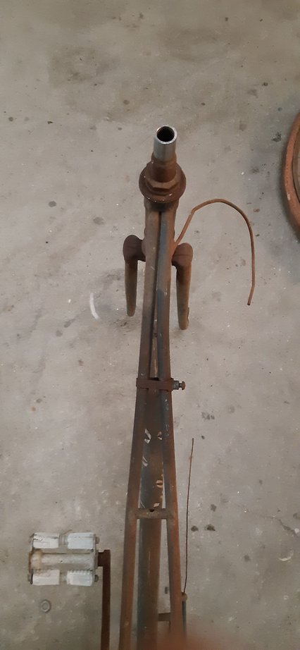

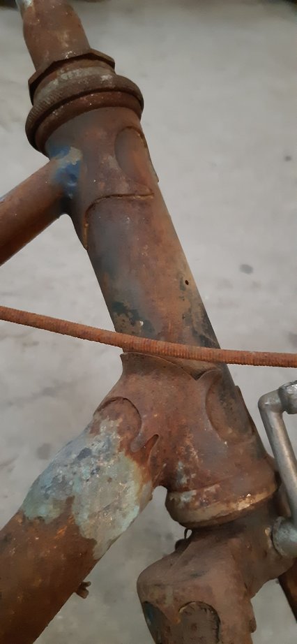

Hi everyone,
i finally had some time to clean up my workshop.
this was my pile off garbage and scrap metal. And underneath this pile was this frame:
It's one off the bikes I found in a field in France a few years ago. It was in bad shape and I made the decision then to scrap it.
But looking at it now I'm not sure anymore.... some close ups off the bike:
this repair off the frame has me worried...
What do you guys think?

if you can get the crankset off, it might clean up to make nice wall art.
Too much work (for me) for a mixte with at least one compromised tube.
But the story you write about trying to make rideable could be worth reading.
So, as a lesson for the rest of us - Go For It.

Agree with Wildwood on this.

The downtube looks sketchy. Maybe repair from an accident?
I'm of the mind, "always save it!" where reasonable. I have no doubt soaking it in Oxalic Acid bath would probably resolve the rust issues, but not knowing what was up with the downtube would always bother me and leave me a bit concerned about someone riding it.
Fortunately I don't think everyone is lawsuit-happy over there as they are over here in the US, but ...
I have no doubt based on other field bikes you posted, you'd definitely do a fine job bringing it back to life in a tasteful way.

Send it to gugie.
Let him replace the downtube as practice.
I do find the frame attractive.
even if that repair is sleeved, danger.

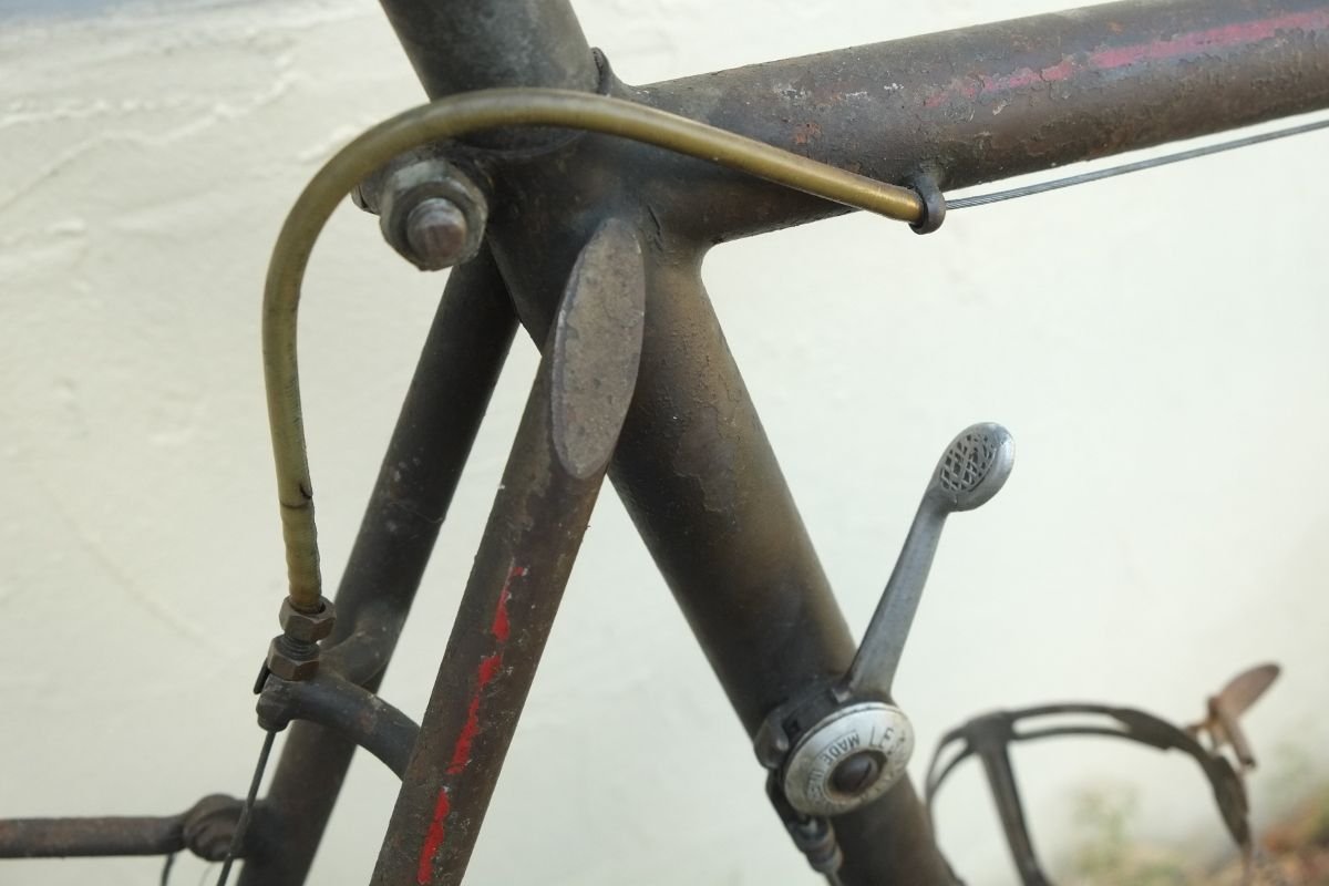

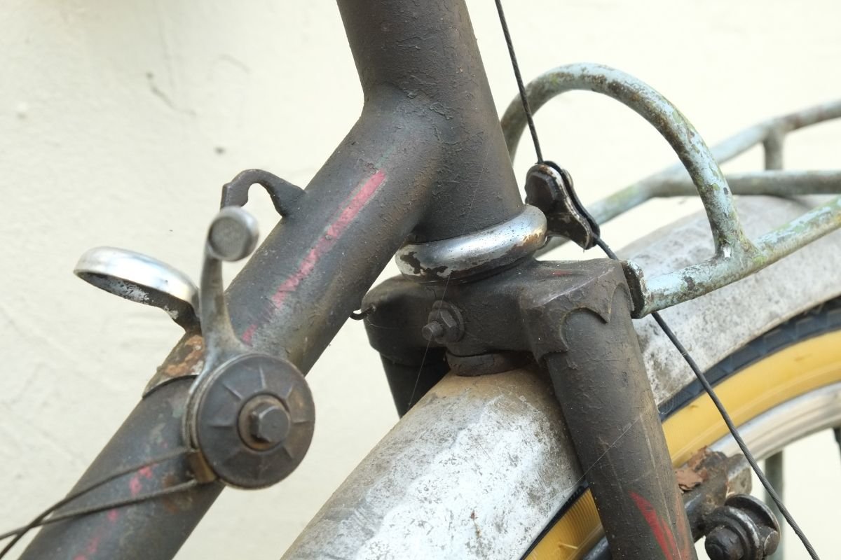

Love that front brake hanger.
Wonder if joint of laterals to upper head lug had to be done this way because Herr Oscar did not offer an upper head lug for mixte designs. Does anyone know?
Sacre berceau!
Sacre berceau!
you can see that they grinded the lug and soldered everything together. It a little messy in person.

Like I said before. I'm keeping the frame for now because I'm very curious about what's underneath the repair work. But I don't think it will ever see the road again. If you look at the front fork it doesn't look that strait anymore.
and the top tubes doesn't look that great as well. Just noticed that.

the fork can be corrected. The frame is toast but can be repaired. There is such a big dose of French Style to this-
Does appear that someone tried to fix the downtube with body lead.
I was just about to mention that the fork looked bent.
While it is technically correct that the fork can be bent back, I presume that is related to the downtube repair.
Can you tell the repair material? Lead? Brass?
It is a curious bike, but appears to be pretty mediocre quality. I think wall art is a good use.

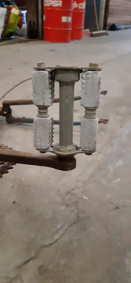

Pedals,
they appear to have one-piece alloy barrels, is that correct?
slightly unusual to encounter pedals with rubber treads and one piece alloy barrels
i realise thar be others, but not very common in any event
can you read a maker's name?

I couldn't find a maker's name. This bike has seen some action in its day. The aluminum in the middle is worn down from use. The end caps on both pedals are missing. I'm not sure what you mean with one piece alloy barrels so I made some more pictures. I like the small pieces between the rubbers. Nice little detail.

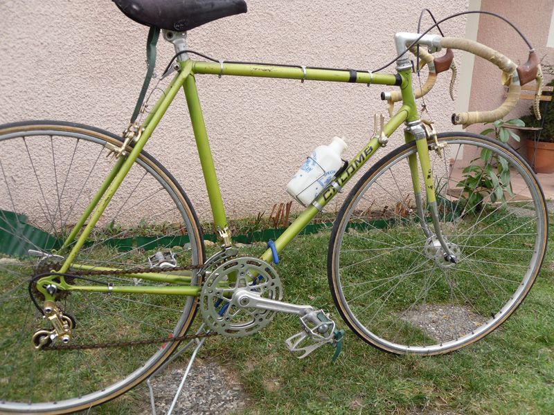

At one time there was a Cycles Colomb entity in operation in the town of Bagnolet. Have not as yet discovered years active...
Machines wearing Colomb badge continued to be produced well into the 1970's. This fellow appears to date from about 1978 -
Thus far have located four or five 1970's era examples. Producer at this time seems to have been Etablissements Beteber of Oloron-Ste-Marie, maker of the Regina Sport and Lapebie brand cycles.

@juvela- nice referencing. I like the lime green Velo de course - almost all French- about my size even and of pleasing appearing geometry.
the lug less bike is also interesting.
the quantity of French brands that were “badge engineered” does seem to be significant by the 70’s.
