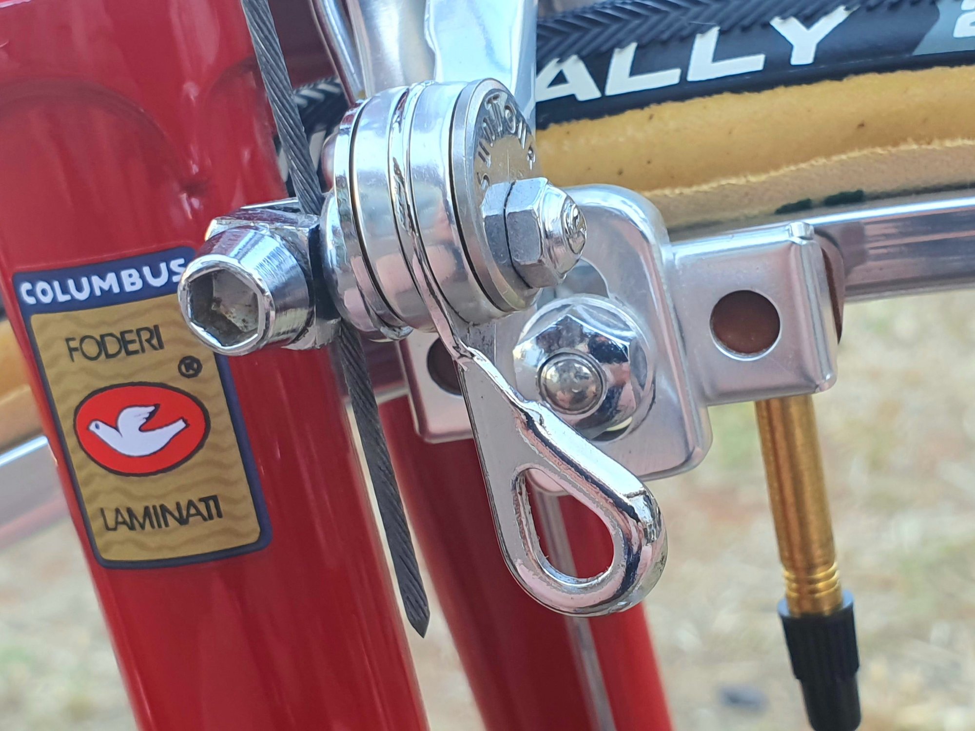

I've been perusing old Suntour cable sets on Ebay and guess what? They have ferrules in them!
You know, the more I think about it, the more I realize that most cable sets I see have some sort of ferrule at the transition - even if they are only plastic/nylon, there always seems to be something. So, I will stick with my bias (or whatever you want to call it) and will build this up using ferrules at both ends of the housing. I get that some of you don't, and the braking works for you and that's cool - but have you ever stopped to think if you might see an improvement in braking feel if you were to add the missing pieces?
Off to the bike shop for some housing and ferrules

I haven't been paying close attention to this thread. My take on ferrules is that if the port was intended to take a ferrule, the cable fit in the port (lever or caliper) will be sloppy without one. If a ferrule fits, I use one. If not, then I go without. I've never considered the issue of beveled or flat bottom, but will pay closer attention in the future.
The ones I just looked at seemed to only have ferrules on one end, and based on the direction the cable was loaded into the housing, it seems to be the end that goes into the brake lever. Not the end that goes into the brake caliper.
Sure, when pieces are missing.

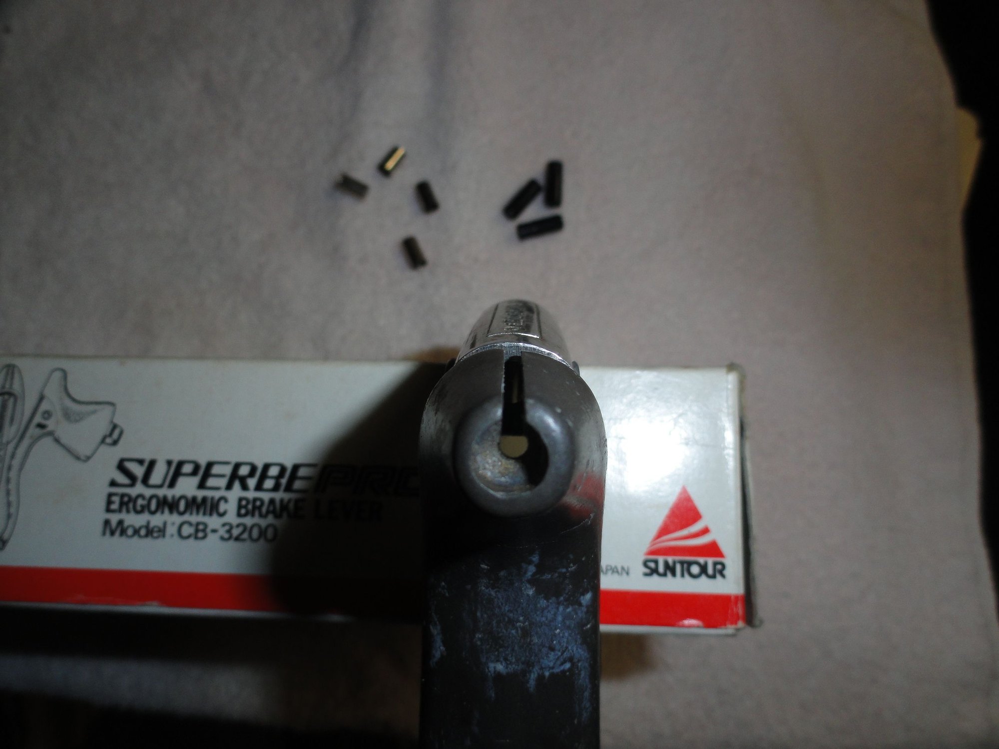

Originally Posted by Drillium Dude
Cool - but does is this brakeset one of those designed to work without ferrules? I don't know - I haven't used Superbe brakes since the mid-80s.
Bias? If you mean my habit using ferrules at each end of the housing when installing Campy brakes, well, that's not bias - it's textbook installation.
I don't remember what the tech manual for Superbe brakes said, but it would have been standard good practice to use ferrules at both ends that time. Yeah, it makes them feel more solid and precise. It would have been weird to buy a very expensive top end brakeset and then take shortcuts in set up. Superbe were essentially campy copies, so it's hard to believe the factory recommendation would have been any different than campy. It is possible, but I think unlikely. If anyone still has the tech sheet, please share... There are partly stepped down ferrules that should work for this particular application. If i had to guess I'd say that's what was used.

DD,
The missing part of this discussion is the size of the cable housing. Three different sizes, and three different ferrule sizes. 4mm is a standard size for housing in Shimano indexing system. 5mm is a standard size for both Shimano index shift cables using the radial inner wires, and some brake cables that use bias wound cables. And lastly 6mm bias wound cables used for brake cables. The 5mm cable when used as a replacement for brakes need a ferrule to keep the cable centered in both the lever and the caliper.
The pics of a Superbe cable above is of a 6mm cable housing that fits snugly in the barrel adjuster. I have enclosed a pic of the Campy lever and the size of the cable receptor. And pics of the ferrules for a 5mm housing. The steel ones are the ones needed for brakes and the plastic ones are used for shift cable where the reinforcement of the cable end is not needed. Smiles, MH

Originally Posted by Mad Honk
DD,
Right you are, we haven't discussed is the sizes of the housing involved. In my case, the Suntour adjuster socket is 5mm and the Campy one is 6mm. I measured the Campy ferrule and it works out almost exactly as 6mm, meaning the housing is just a little smaller than that.

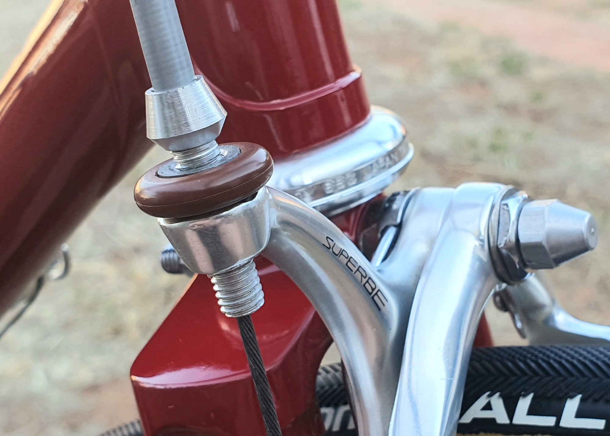

I see that, too. And I also assume the ferrule goes at the lever/cable interface. So at least I know now not to go with the spendy old-school stuff and will stick with my "upgrade" instead
...The steel ones are the ones needed for brakes and the plastic ones are used for shift cable where the reinforcement of the cable end is not needed. Smiles, MH
I believe that shift cable housing ferrules are plastic because it allows the sharp ends of the housing wires to embed slightly, so as to even up the compressive stress on all of the wires.
There are also metal versions for the ends of the rear derailer housing loop, but always with a plastic seating washer inside.
