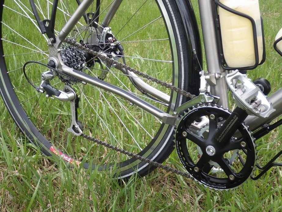

I've got a 48/34 on my Rando Bike but with a ten speed 11/28. The 14 teeth in front is an extreme jump but provides a good range. I really enjoyed my time on a Trek with 1/2 step plus granny 5 speed and put a less than ideal 6 speed on it. I only took it on hilly 50 mile rides but could see the benefit of 1/2 stepping with the granny for steep climbs. The two "large" rings would ask you to push it a bit. See what you come up with on the calculator.
If you are looking for an example of a half step plus granny system, I built up my Lynskey Backroad for light touring three years ago, eight speed 11/32 in back (11,12,14,16,18,21,26,32), in front a triple with 46/42/24. I avoid using the two most cross chained gears on each chainring, thus only use 18 of the 24 possible gears.
The 24T chainring is almost invisible being silver on a titanium frame. And the 42 is hard to notice behind the 46.
I do not recommend half step to people that have grown accustomed to lots of gears on 10 or 11 speed bikes, but I had a half step bike in the 1980s, so I got very used to it.
I find half step not that useful when the changes in grade are frequent and large. But I did a two week tour in Florida which was totally flat, it was perfect there, a slight change of windage and I knew exactly where the next gear was.
