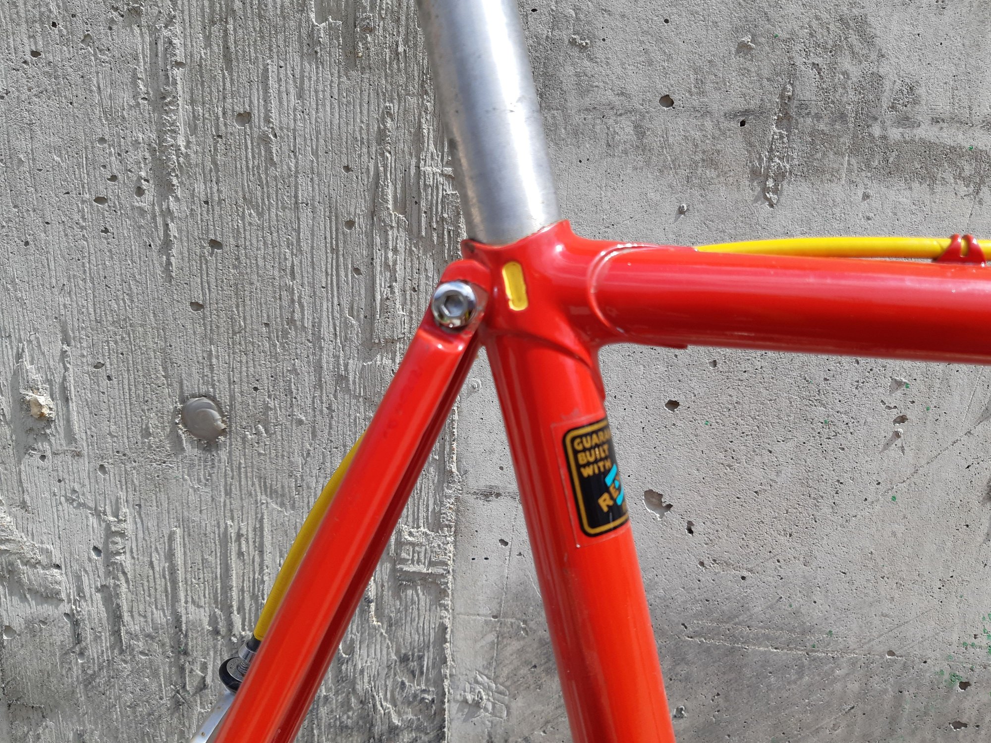

Hey all , this lovely bike got donated to our local bike co-op recently and we can not figure out what the heck it is! It's an interesting mash of parts (mostly Campy and Dura Ace) and looks like it's been repainted (though with some stickers applied afterwards) The "R" cutout in the BB should be a pretty big giveaway but my cursory searching has come up with nothing solid. I would guess it's from the 70's but I couldn't say for sure. I could post more photos if folks wanted , we're going to tear it down and give it a full repacking and cleaning before doing much else with it.

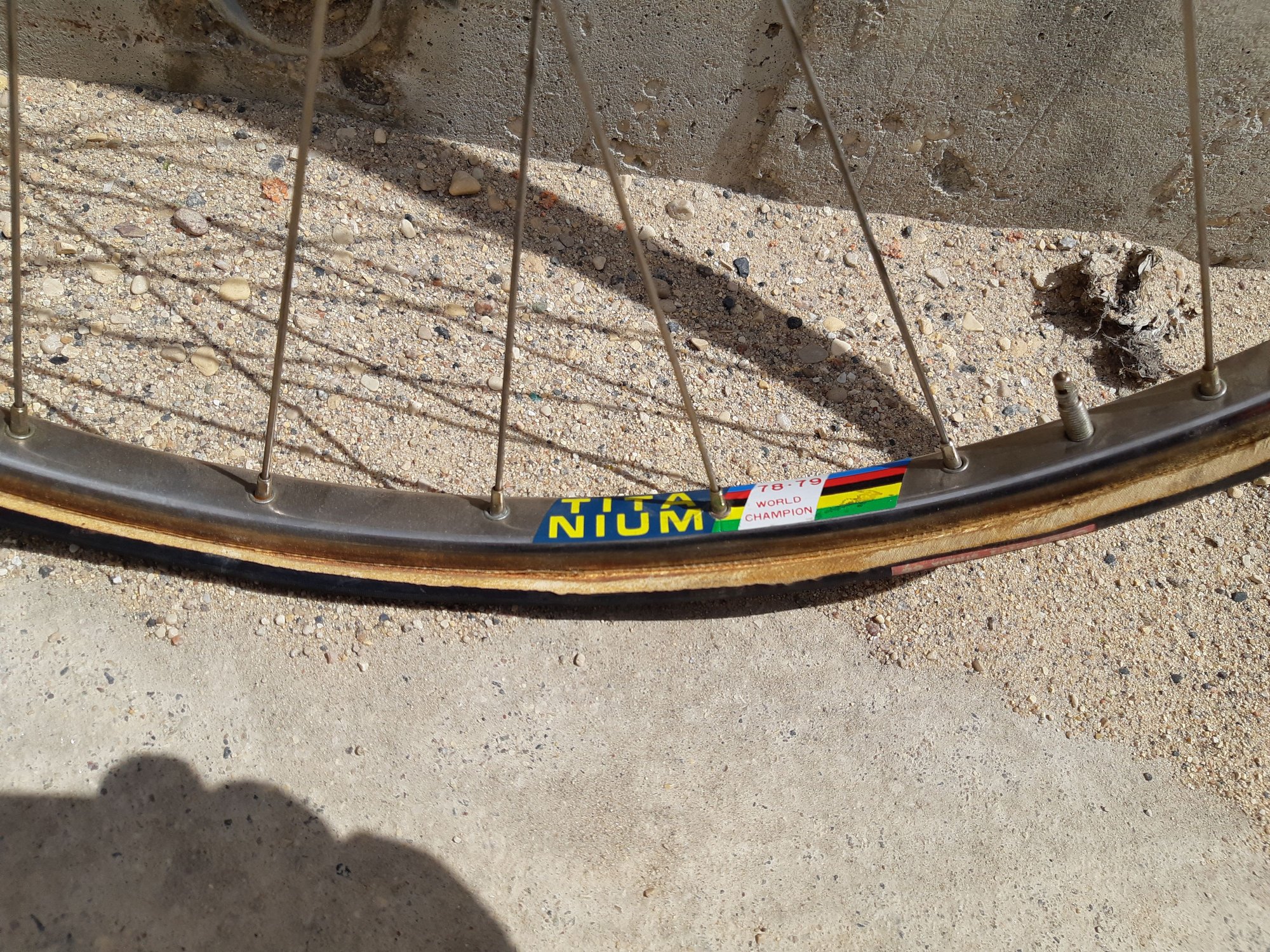

It also came along with a set of these wild titanium rim tubular wheels. Never seen these before.

1060 Corsa dropouts out back, that could date to mid-70s IIRC
Seat stays at cluster reminds me of the treatment Cinelli, Toressini (thus Torpado, Italvega etc., right?) and others used on their 70s bikes.
Looks like maybe powdercoat, and way too thick. Cutout in BB doesn't ring a bell. Sad to see the BB guides shaved, the under-chainstay stop ignored, and someone used a clamp on chrome, wtf? (edit: Probably because BB guides are shaved, duh!)
Nice looking though. Any info on the BB or steer tube threading?
Could be really cool to have it stripped, fresh BB guides brazed on, and a repaint.

Not a chance. The "R" on the bottom bracket isn't the style of a Rossin either.
Raseza, perhaps? (that's a guess)

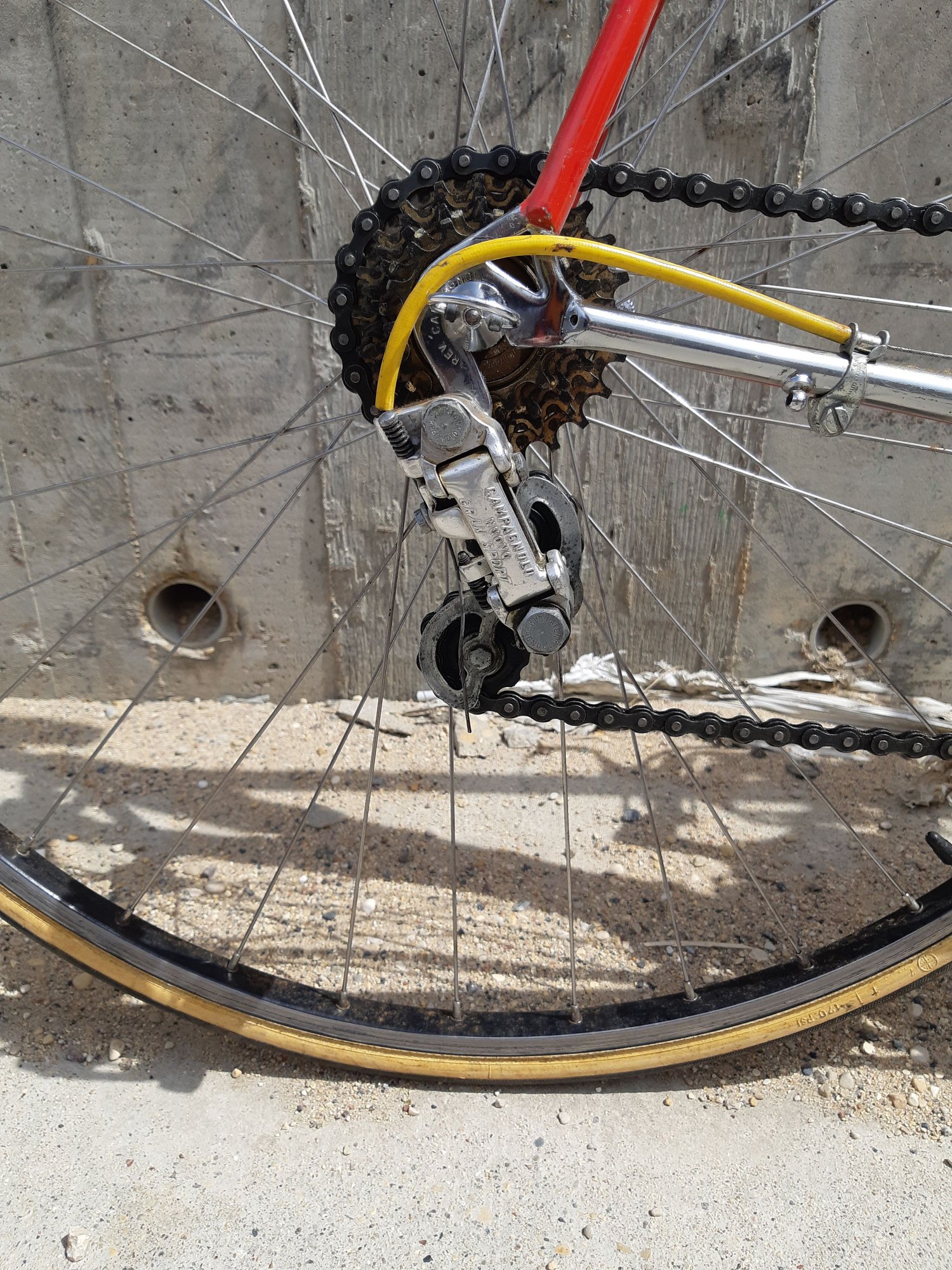

The 6-speed, two sets of bottle bosses, rear drops, and shifter bosses tell me mid '80s, at least.
But the nutted calipers say otherwise. The rear caliper mount and nut looks odd.

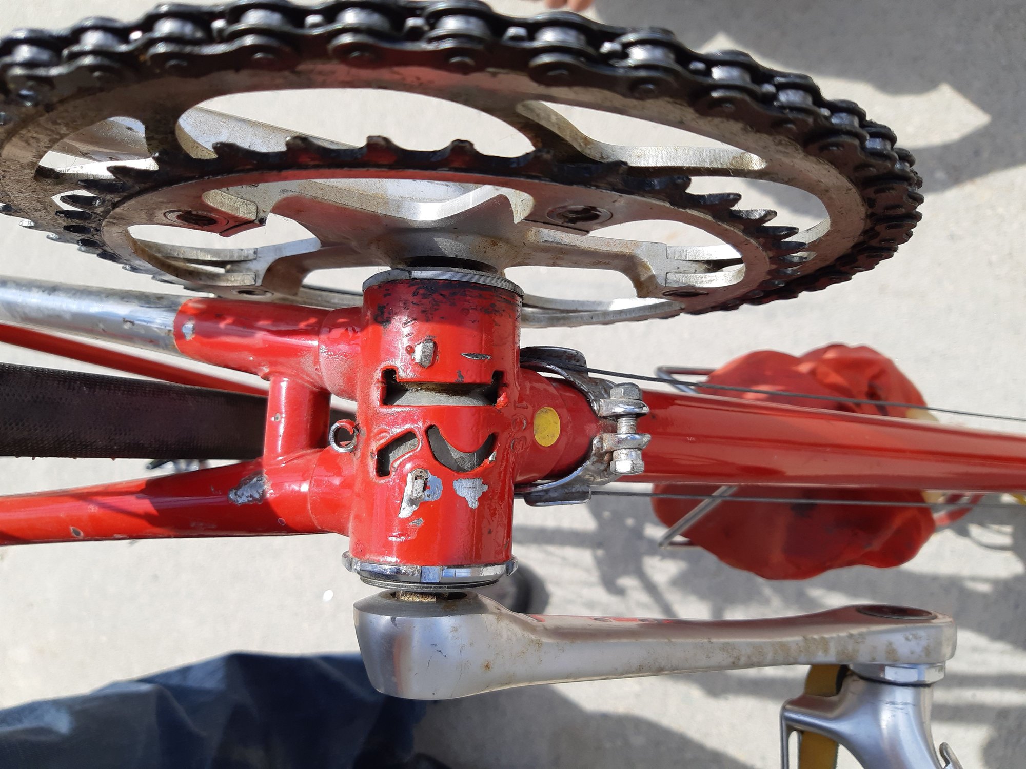

What is the round circle thing on the back of the BB shell? Is that a 3 digit serial # between the yellow dot and the R cutout?

Not Razesa, I've got one, different styling.
I'm thinking Raysport. And just to add to the mystery, check this. https://www.bikeforums.net/classic-v...elli-copy.html
Definitely a lot of Cinelli-esque elements here, but not a Cinelli either.

Yup, it's a Raysport.
CC Bicycle Gallery: Jay Blankenbiller's 1975 Raysport Super Corsa
Same R on that one. Same elements too.
More info: https://www.cyclofiend.com/cc/2005/cc...port_info.html
"These are essentially a quite nice Cinelli Super Corsa copy from Mexico from about 1975, but with a tighter wheelbase, and vertical Campy rear dropouts. Very responsive but comfortable frames (steel is real!), no eyelets on the dropouts, not for wide tires, fenders, or 'touring.'"
Braze-ons could have been added later. 6-cog freewheels have been available since the early 70s at least, and the Campagnolo 1060 dropouts since the 1960s. So it could be much earlier than 1980s.
The Cinelli-style seat lug is interesting, and consistent with Raysport, as mentioned above.
Cable guide for under the bottom bracket cable routing. The bare metal patches likely once had similar loops, perhaps drewed off to allow the bike to be used on a trainer.

6-cog freewheels have been available since the early 70s.
I associate them with 126mm spacing.

To be specific, it is a later production Raysport Super Corsa. Earlier production had 1010 dropouts. It would originally have had chrome lugs. IIRC, they are chrome plated but the chain stay was not exposed chrome.
Example of a NOS frame below.
P2221599 by L Travers, on Flickr
P2221601 by L Travers, on Flickr
P2221597 by L Travers, on Flickr

The front derailleur cable guide looks to be snapped off, as opposed to shaved off.
The rear was deliberately removed.
Once either was damaged, the clamp-on guide bracket became a necessity.

I have seen those rims before... Araia TITAACE, On a national champions 3-Rensho track bike, You have struck C&V GOLD!!! Those rims go for about $600 EACH on Ebay, worth even more as a set, also that wheel in your photo may have titanium spokes as they appear identical to the titanium spokes on the 3-Rensho. Unbelievably rare.

I hate to bring up mere practical considerations but it seems to me that the cutaway R in the BB shell would allow dirt easy access to the BB.
Mountain Mitch is offline
Old 10-02-19, 10:15 AM
merziac
merziac's Avatar
Posts: 13,043
Mentioned: 267 Post(s)
Quoted: 4512 Post(s)
Liked 6,383 Times in 3,669 Posts
That's what BB sleeves are for.
