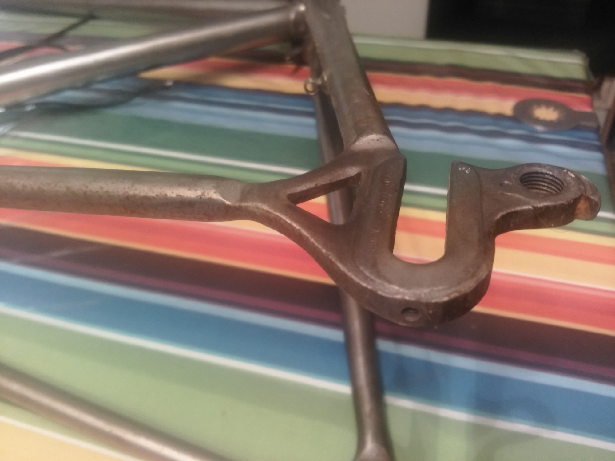

I got nice frame. but what is it?
Join Date: Sep 2018
Posts: 43
Quoted: 10 Post(s)
Liked 3 Times
2 Posts
I made a good deal on very nice frame.
Raw steel - previous owner states it was never painted and frame is probably made in 1970's. (it could also be professionally stripped and cleaned but I can not see any at all sign of paint even in deepest darkest hole...
No serial number or any factory marks on it , only two marks on seat lug, but one is R (on the right side) and other is <F l> (on the left side so that can be just mark for sides and front of lug... ) Frame could be custom made, is quite small and has campagnolo dropouts.
I'm thinking of leave it as a raw steel (just a bit of polish). at the moment I rubbed boiled linseed oil just in case but there is no signs of rust on that frame - if its really from 70's that is quite unusual - specially in irish wet conditions...
incazzare.
I don't know what is is, but the wraparound stay detail is often seen on English bikes. Based on the braze-ons (or lack thereof) I would guess it is mid-70's or earlier.
1964 JRJ (Bob Jackson), 1973 Wes Mason, 1974 Raleigh Gran Sport, 1986 Schwinn High Sierra, 2000ish Colian (Colin Laing), 2011 Dick Chafe, 2013 Velo Orange Pass Hunter
incazzare.
And the over the BB cable guides. That and the chainstay stop are what I was referring to.
The wraparound stay reminds me of Falcon, Carlton, raleigh and Urago.
But, it does not look quite right for any of them.

I see a head badge hole. The hole pattern and distance between holes will help in identification.
Brent
Brent

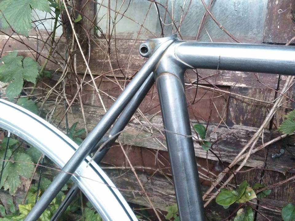

What's the threading? What's the seat post size?

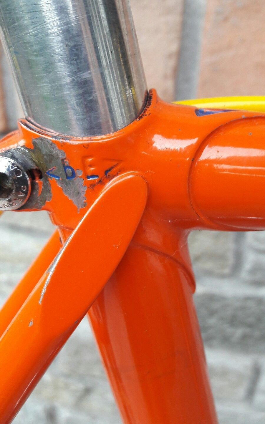

There is a word, of which i see only four letters --[ . . . ] R E R A -- on the left side of the seat lug, just below where the seat stay is brazed on; they are filled with brass and filed smooth, with more letters presumably lost in the glare. Can you read them? They will probably only identify the lug manufacturer, rather than the frame manufacturer, but still... a good clue. I wonder what @juvela knows about this.
The long crimp on the outside of the drive side chain stay is pretty distinctive. I can't recall ever seeing that before. Should be a clue.
The same goes for the <FI> stamp on the seat lug.
It appears to be a very nice frame, and knowing who made it would probably enhance its value. But, that said, I can't identify it.

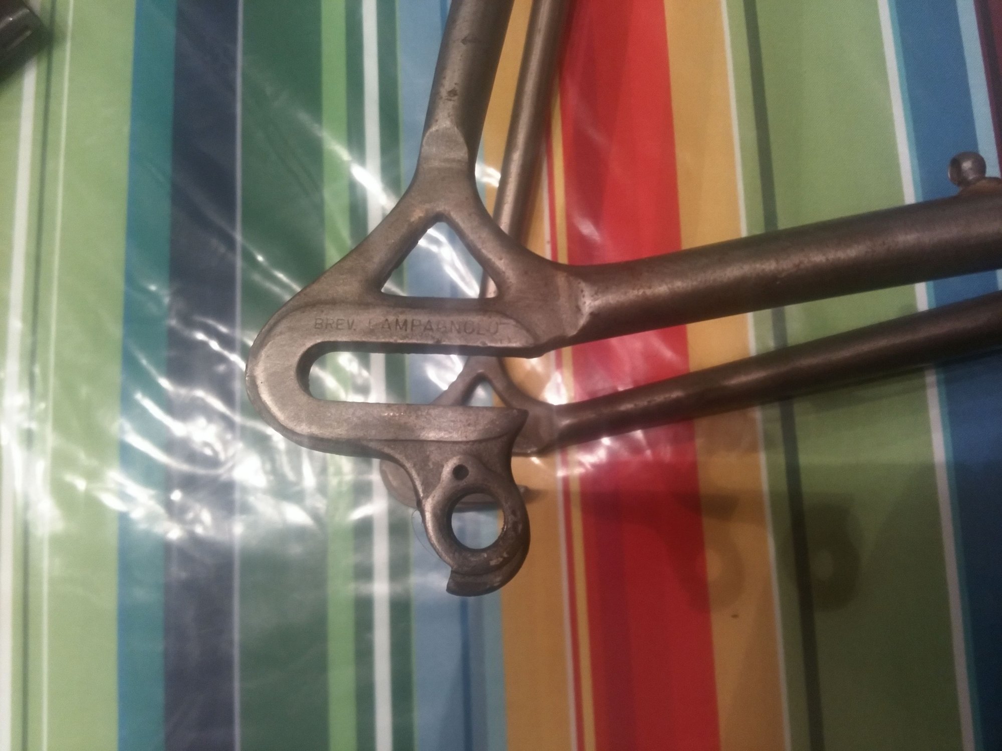

You mention that ends set is Campag.
Is it a regular 1010 or something else?
From image of whole frame I would have guessed something else...but perhaps it is just me annuated occipital receptors...
Do fork ends match dropouts? They appear to be without eyelets like the rear. You could check both the front and rear for evidence of eyelet removal. This was a minor fad amongst enthusiasts at one time in the interest of "lightening." [think "Drewing"]
Frame appears to be conceived in a "sports - recreation" geometry rather than "racing" so the absence of eyelets is slightly surprising.
In Italian the F I marking is sometimes employed to indicate Filetaggio Inglese (English thread). This is moot here since it is pretty clear we are dealing with an anglophone product.

Seat post 28mm

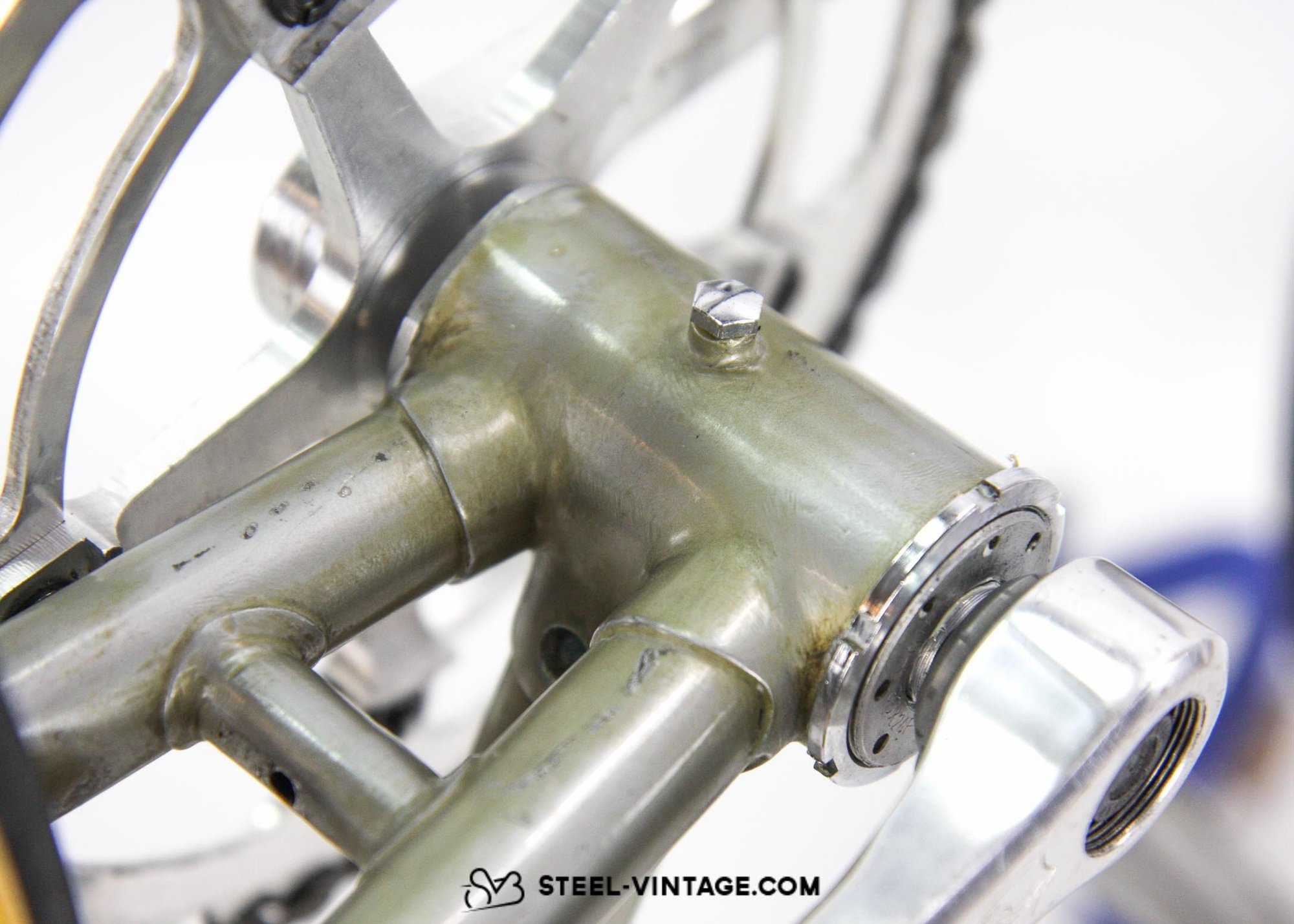

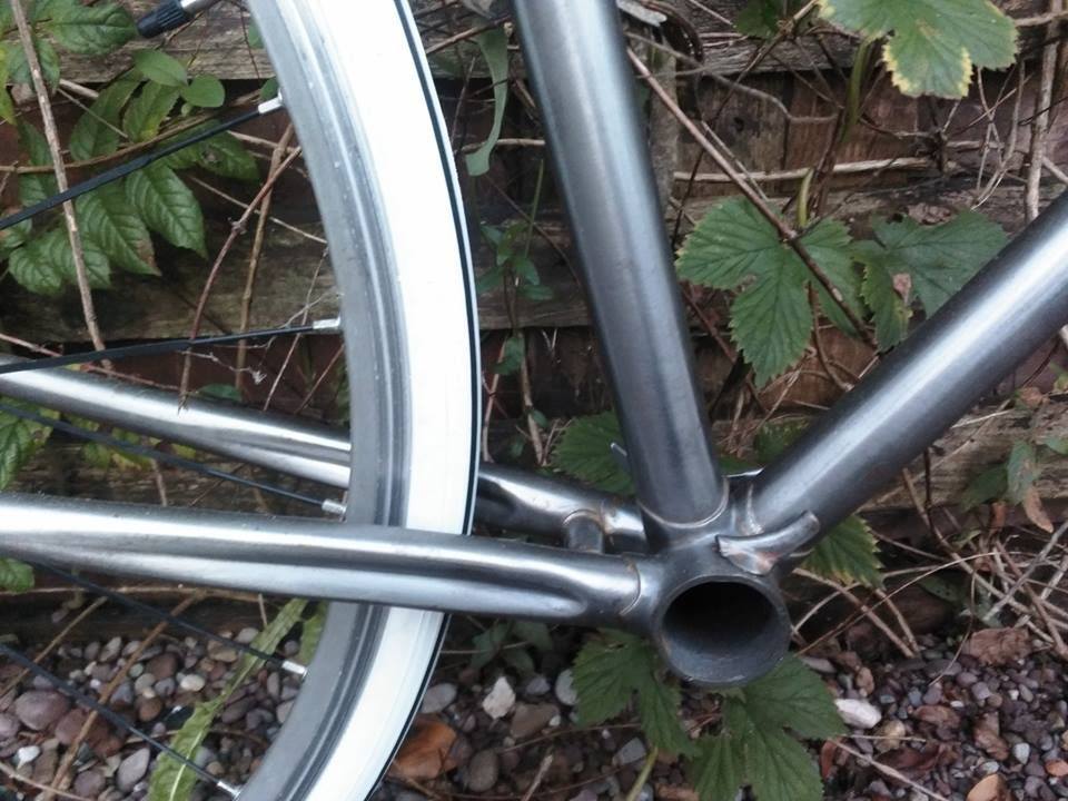

Bottom bracket is slightly larger than english type. I'm unable to check what thread it is at the moment rought messure shows 35mm .
Sign on seat lug is ERRERA with possible F, H T or something on the front (there is one more line but cannot see what letter could
it be (or part of letter). google shows some results for Herrera that have something to do with bicycles. Most likely Herrera was a name of frame builder who made this frame.
(all I have to do is call all frame builders in the world asking to speak with Herrera guy...)
Dropouts campagnolo wth no sign of eyelets removal. front are campagnolo as well.

The stamping on the seat lug may indicate Giuseppe Ferrera, an Italian framebuilder who reportedly built some of Roger de Vlaeminck's frames, along with those for many Italian amateur teams. In the mid-1980s he was recruited by Jim Miele and came to Canada, where he set up and oversaw the Guvin manufacturing operations. He also designed the top Miele models. I'm not familiar with his pre-Miele work, so I can't say if this is one of his frames but it's a possibility based on the seat lug stamping.

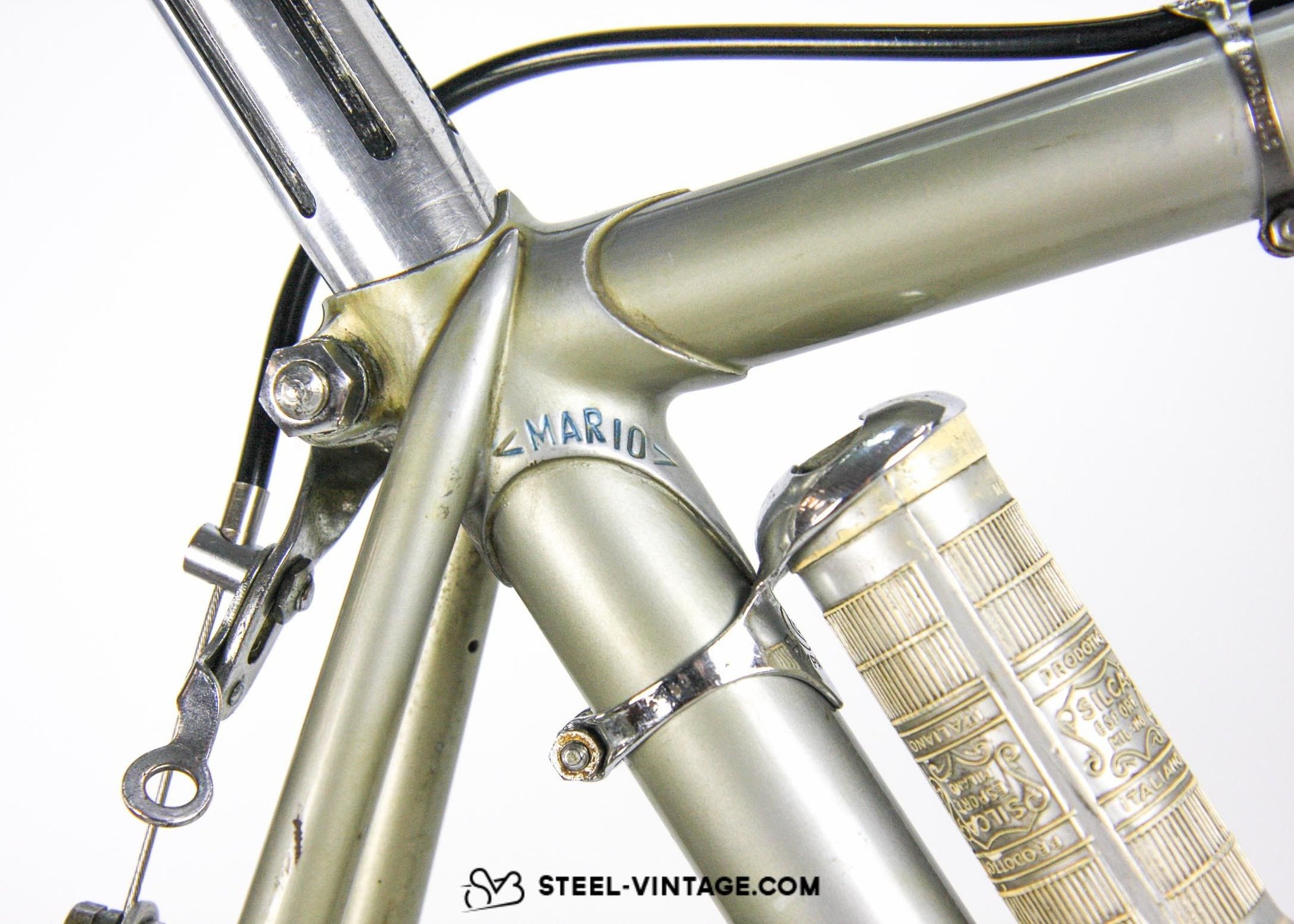

This frame looks like the work of Mario Peloso (Alessandria). Even though I don't have any pics of an exact match, I'd be surprised if it didn't come out of his shop.
Peloso built custom frames and generally would have initials of the customer (or another shop he built for - see the Suzzi frame below) stamped on the seat lug in the format seen on your frame.
Sometimes full first or last names would be stamped, some had "Peloso" and some had words like "Special" (not sure if those indicate some sort of model).
Perhaps on your frame the word was filled in with brass because the original order didn't go through as planned? Who knows.
Peloso head badges were attached with two horizontal rivets. The little port on the underside of the bottom bracket shell was also common on Peloso frames of the era.
You can find a bit more info on Peloso in this post by Mike Barry,
and another one that dovetails with it from an Italian who knew Peloso back in the day (it's in Italian so you'll have to use Google translate - just remember that any time you see the word "hairy" it's actually "Peloso" ).
Here are some examples, starting with one that has similar seat stay treatment (which wasn't common on Peloso frames) as well as the long chainstay crimp:
Suzzi by Peloso:
Suzzi by Peloso:
