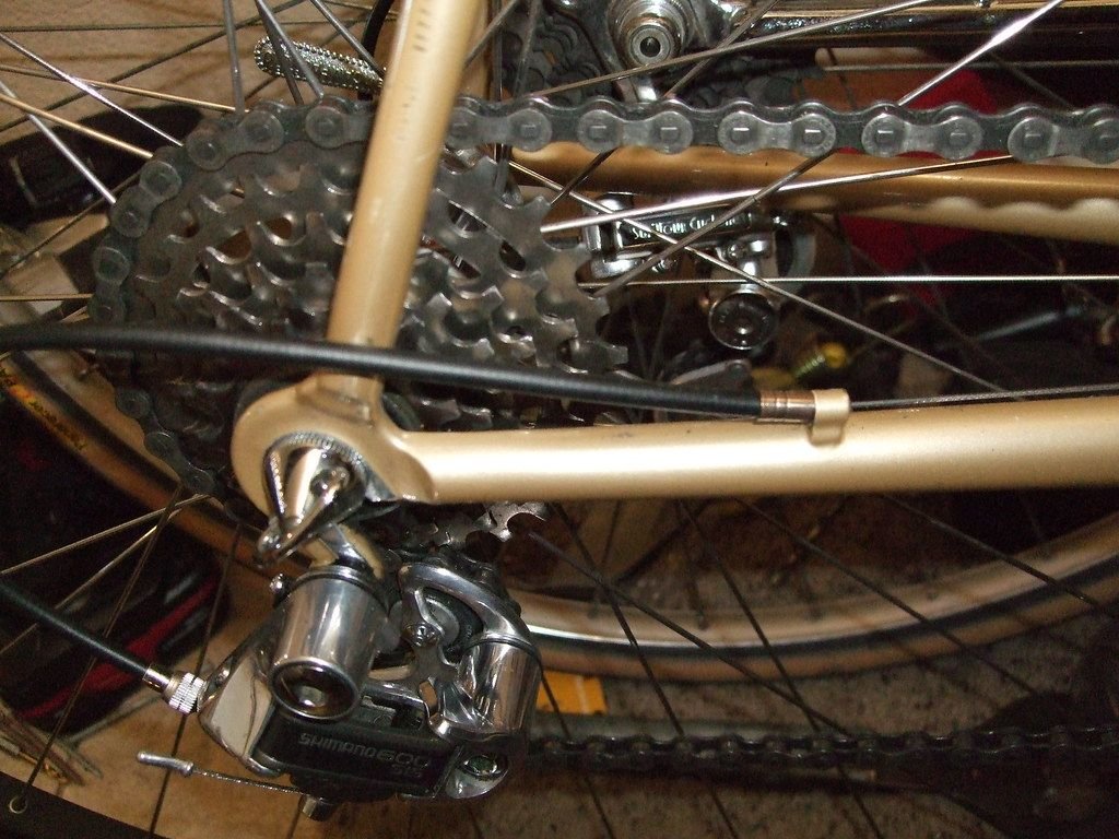

Chain cleaning method opinions can become biased toward removing crusted-on lube deposits when one works on vintage bikes. Newer chains can stay reasonably clean over their service life simply by wiping thoroughly with terrycloth shop towel before and after each lubing, thus never needing removal and/or dedicated cleaning processes.
There will always be some grit that gets into the wrong parts of the chain when it is lubed and wiped, but chains are made to digest this stuff and go on to a long and healthy life. Modern chain is a blessing and prices today seem very reasonable even at the higher levels if one shops around.
My road bike chains get lubed with a diluted style of lube and then wiped down, and end up looking like this. This is the old UG Narrow chain that came on my recent Goodwill-sourced ONP and has been lubed and wiped down 3 or four times in the weeks I've been riding it everyday since. I haven't touched it in the last 200 miles and It sure doesn't seem to need any sort of cleaning. Luckily it had little ancient encrusted detritus when found (the freewheel is a cleaned/rebuilt D-A 7s with smallest cog removed to fit 120mm, so is still super clean).

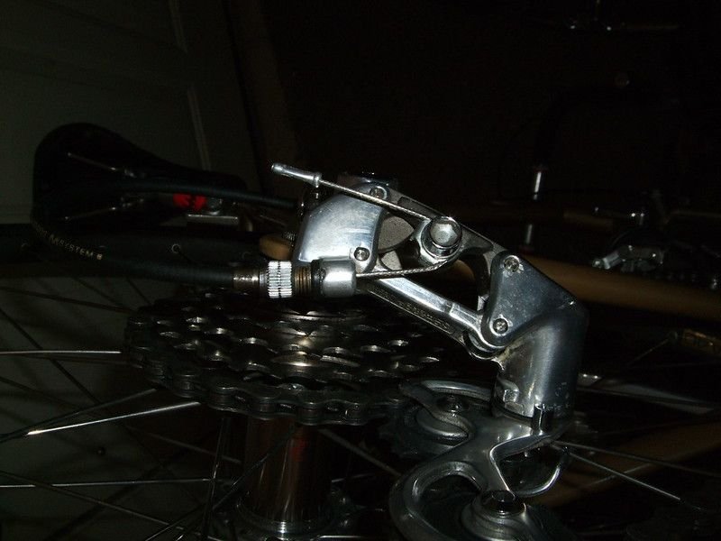

In case anyone was curious about the odd cable routing at the pinch bolt, this was to get the 6-speed SIS levers to work with the 7s cog spacing.
I made a two-legged bent-tab washer to extend the arm length and thus increase leverage of the cable to reduce the derailer movement.
Amazingly, the 600 SIS short-cage mech handles this 13-28t freewheel and 34-42-52 gearing with grace:
