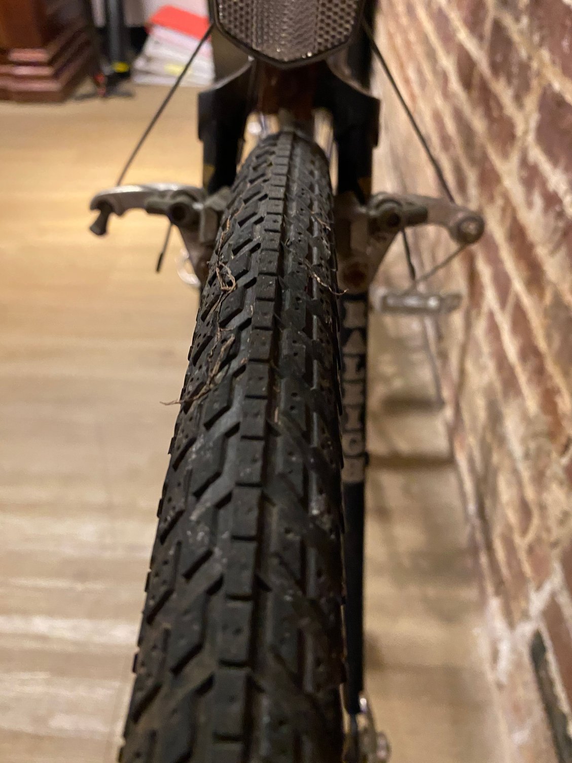

OP know that *Some* old touring bikes with Cantis built for 27" wheels can be difficult to convert to 700c due to getting the brakes pads to align with the smaller diameter 700 c wheel so maybe test fit first. I would also HIGHLY recommend a 27 x 1 1/4 (roughly 32mm) Panaracer Pasela in my opinion having used Kenda, Sunlite, CST cheap 27 inch tires the Panarcers are worth paying a bit more for and they are very supple which the cheap ones are not.
Thanks. I test fitted some 700c wheels and I can orient the cantilevers to work. They're too narrow for fitting wide tires so I'm just deliberating over different wheels or upgrade 27" tires. I also have long debates with myself on what socks to wear, what to have for breakfast etc etc

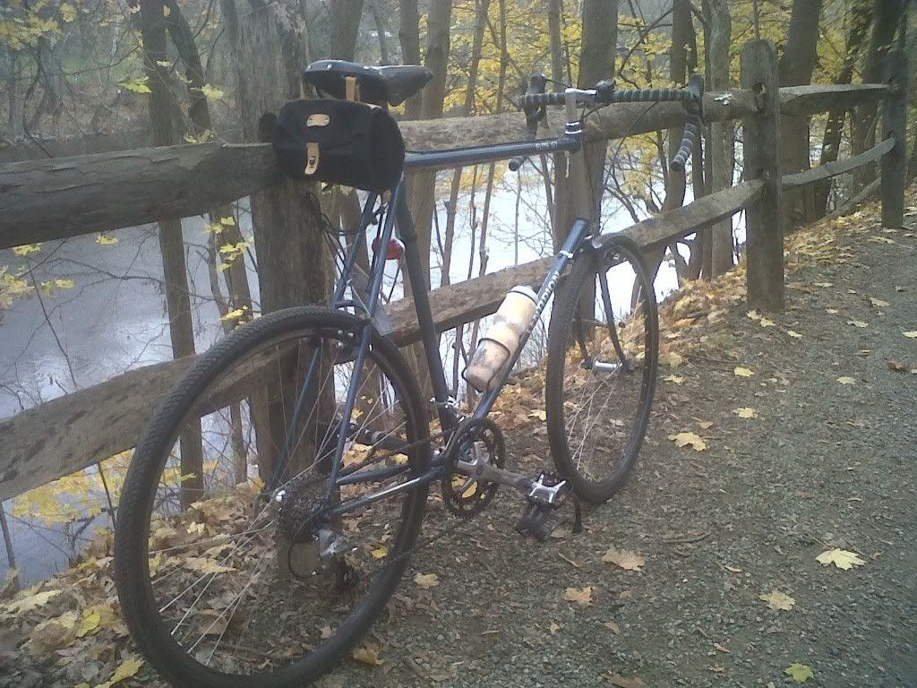

Here’s the Gugificazione approach I used to do that with the ‘79 Miyata 912, now as my rain and travel bike. All the work that gugie performed was on just the fork: re-raked for lower trail, braze-on center-pull posts, mid-fork and second (stout) bottom eyelets, custom racks for the rando bag and low-rider panniers, and Mark’s great custom decaleur with inverted tubes for my tall bars and the big Waxwings bag he helped to find. It all works fabulously - better than the engine that powers it!
Fenders not yet reinstalled over 700x28’s, with room thanks to the conversion from 27” decades ago.
The pannier supports are horizontal, unlike what my unfortunate photo angle suggests here:
Last day of the cold Tour of the Willamette with Mark and several other regular C&V contributors.

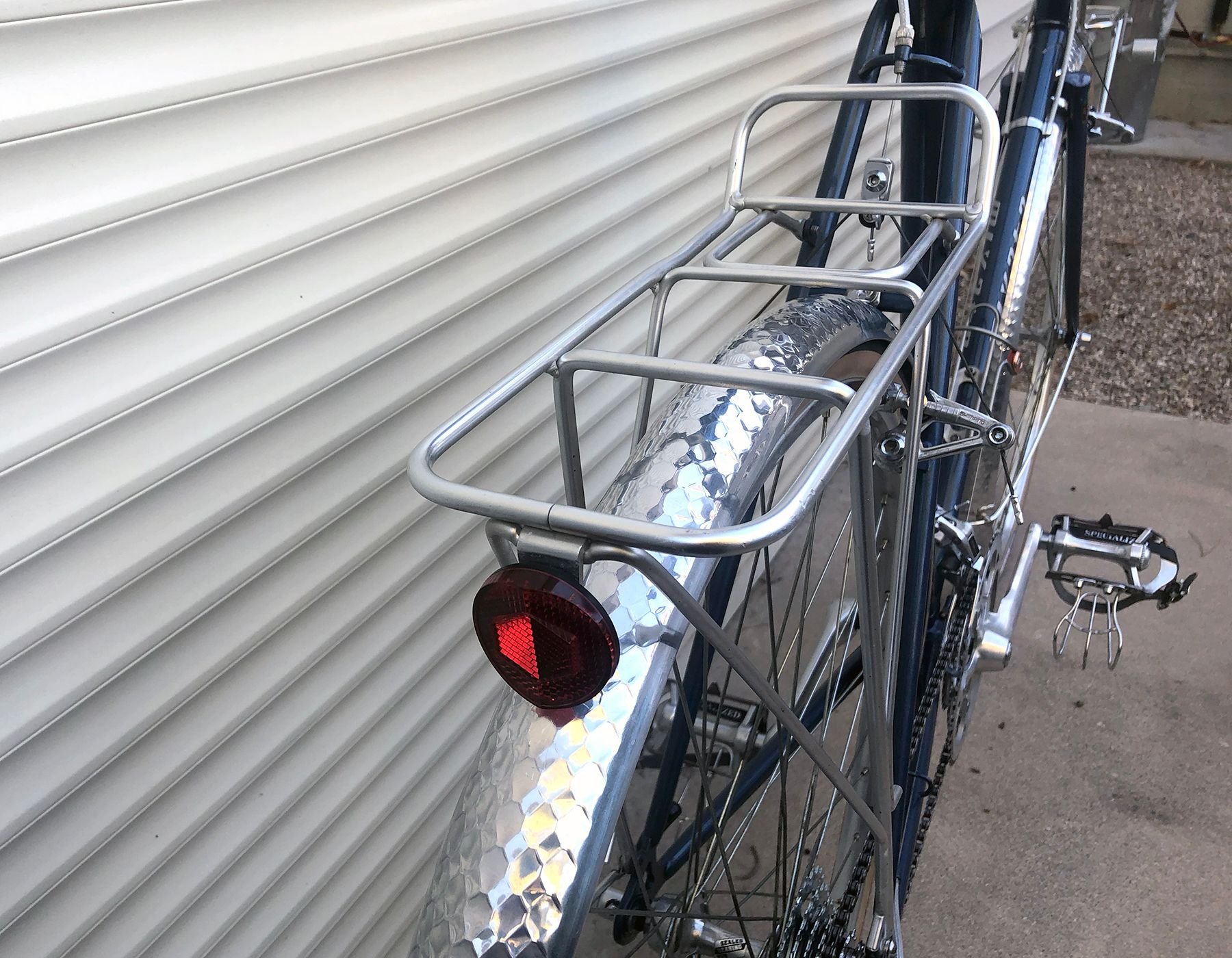

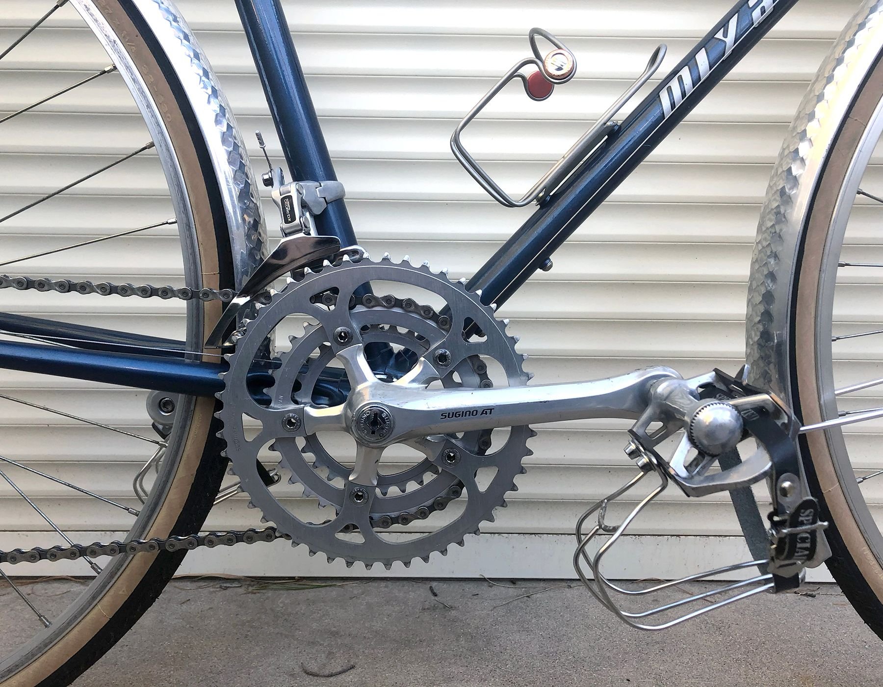

Here’s my 1984 Miyata 610. The only original parts are the Wheelset (Sealed Bearing Suntour Hubs), Seatpost and Rear Rack. The rest of the build is mostly period correct-ish, plus newer cockpit. I moved a majority of the original parts to another bike ('85 Sekai 2500) and built up the 610 closer to Miyata 1000 specs.
Vintage Parts:
• Sugino AT Crankset (50/36/28) w/ Original Sealed Bearing Bottom Bracket
• Specialized Touring Pedals (as found on the Specialized Expedition) w/ MKS Cage Clips
• Shimano 600 Brake Levers w/ Dia Compe Adjusters and SOMA Hoods
• Shimano Deore XT Brakes (BR-MC70) w/ Shimano LX Kool Stop Pads
• Shimano Deore DX Derailleurs
• Shimano 7 Speed Bar Ends
• Speedic 170GT Saddle
New Parts:
• Tange Levin Headset
• Nitto Technomic Stem
• Nitto Noodle Handlebars
• Sunrace 7 speed Freewheel (13-28)
• Panaracer Pasela Protite 27 x 1-1/4 Folding Tires
Accessories:
Velo Orange Randonneur Front Rack w/ Integrated Decaleur
(Not Pictured) Velo Orange Randonneur Handlebar Bag
Velo Orange Hammered Fenders
Crane E-Ne Bell
squarenoise is offline

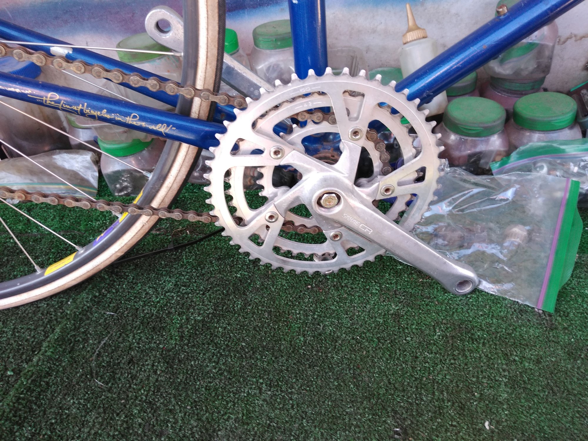

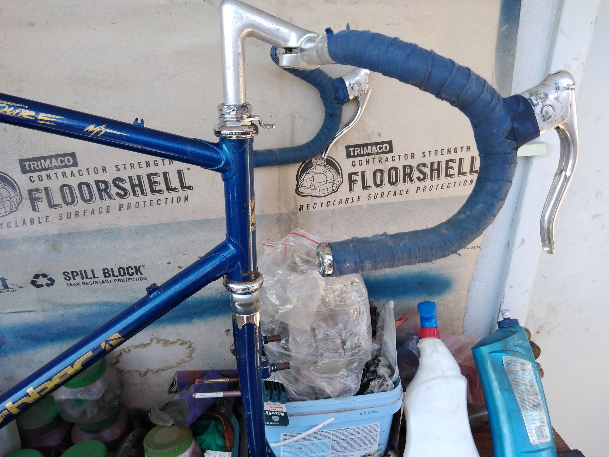

This was a 1984 Miyata 610 that came to be with really rough paint. New non-original powder coat color and non-original decal colors (from Velocals), plus some nutty componentry (7900 Dura-Ace shifters, XT shadow-type RD, speedy Vuelta wheels, quill stem conversion) had this one a looker and a rider. Quite sporty, certainly more so than the 1000 (per design brief). Sold the frameset eventually, but man...so hot.
New Parts:
Accessories:
Crane E-Ne Bell
