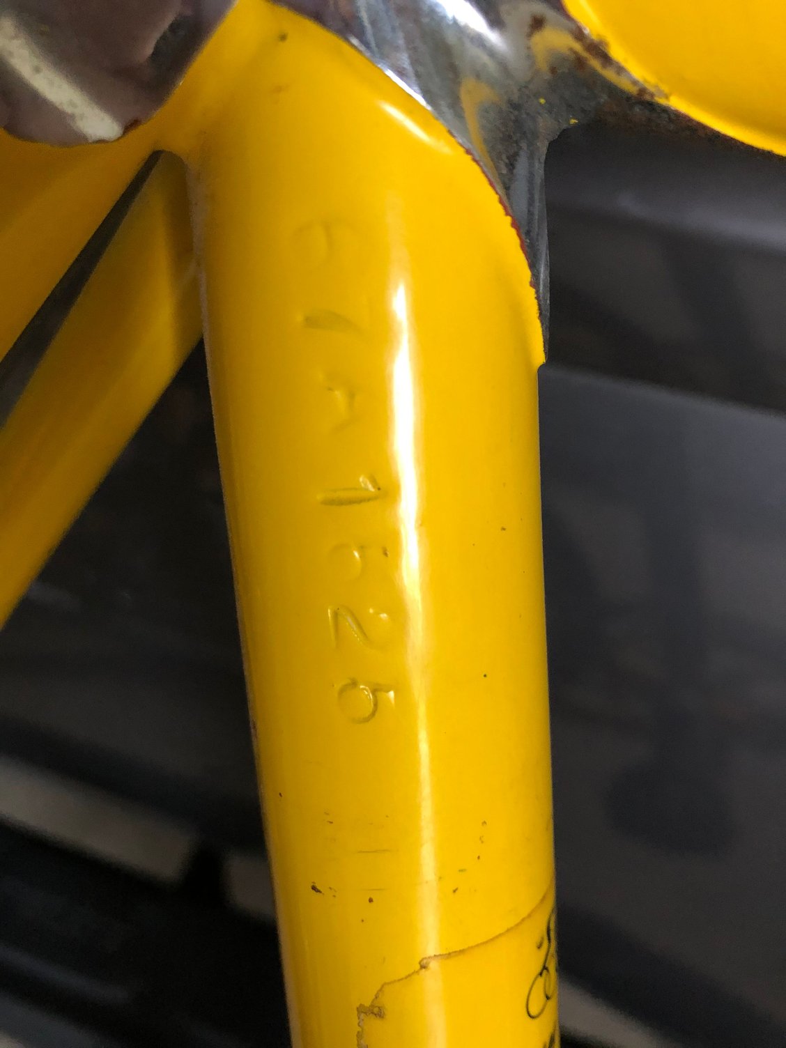

Well I picked up the bike. Gentleman used to own a bike shop and apparently this bike was one of many that he owned. He just wanted to get rid of some bikes so was nice enough to lower the price a little more.
Appears to be a 1967 based on the information provided previously. See picture.
Hubs look nice and are smooth and dent doesn’t look as bad in person...think I just bought a project bike!
Needs some serious cleaning but think it will clean up nice. And since the paint is not original then I won’t feel bad about repainting it I go that route.

The top tube is also bent, as can be seen by the paint cracks in the pictures. Too bad. Make sure, when and if you buy the bike, that you ask the seller for the original wheel set. My guess is that there is a set of Campy high flange hubs laced to a set of sew-up wheels stashed away. He will likely throw them in, if so. The bike appears to be of 1967 vintage. Mine was a 1969.

As randyjawa pointed out, there is damage to the paint on the top suggesting some deformation there. I don't exactly understand the mechanism that causes it, but this is 100% typical of a frame damaged frm a front end collision - obviously 'wrinkled' underside of the downtube with less obvious damage to the top tube. Usually, but not always, you can feel a wrinkle in the underside of the top tube behind the lug.
A brake is very unlikely to cause such damage because brakes, especially old single-pivot calipers, would pivot on their mounting bolt before causing damage to the steel frame. THe missing paint a few cm behind the damage is much more characteristic of damage from a brake caliper.
Anyhoo, it may be possible to repair the damage - I worked on one bike where the owner liked to have a little drinkypoo before riding, and had crashed and caued the same damage to his old steel bike multiple times, and had it repaired multiple times. My guess is that the steel is weaker after each crash/repair cycle, but the guy kept riding it.
The guy eventually died in a helicopter crash.
So, gstein , if you decide to repair that frame, it is likely it will be perfectly fine to ride, but be very careful when riding in helicopters.

Yes, the new photos do indicate a bit of a collision.....I need to revise my earlier statement....

I have to say that the location of the dent is a bit concerning. Usually they are further back, in my experience. This one is right by the lug tip, meaning that it's more likely to crack. Not sure how much you are going to ride it though.
I assume it came with Universal brakes, so the previous owner replaced those with something that will stop the bike.

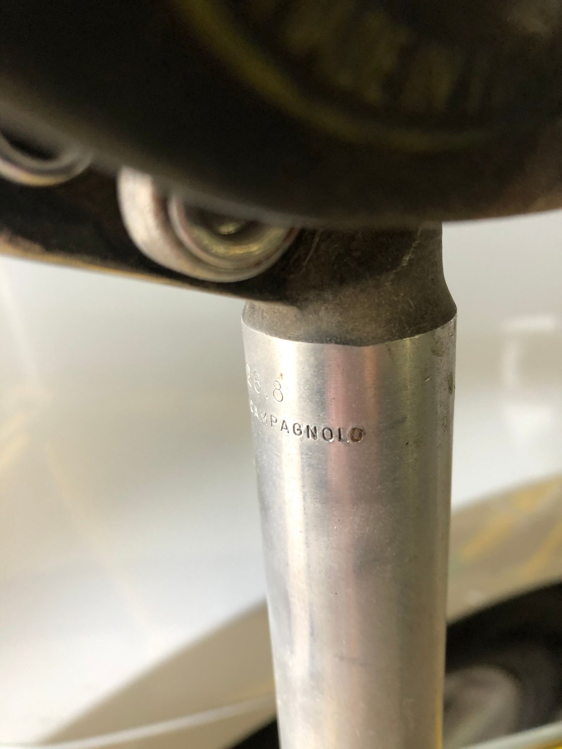

I’ve started to breakdown the bike and I’m pleasantly surprised at the overall condition of the components. The Phil Wood hubs cleaned up very nice with no signs of rust and they spin smoothly. The only rust I could find on the bike was on the TT cable clips but steel wool took care of that. Was interesting that of the three cable clips, one was Campagnolo the other two were Shimano. Guess a few must had been lost along the way.
