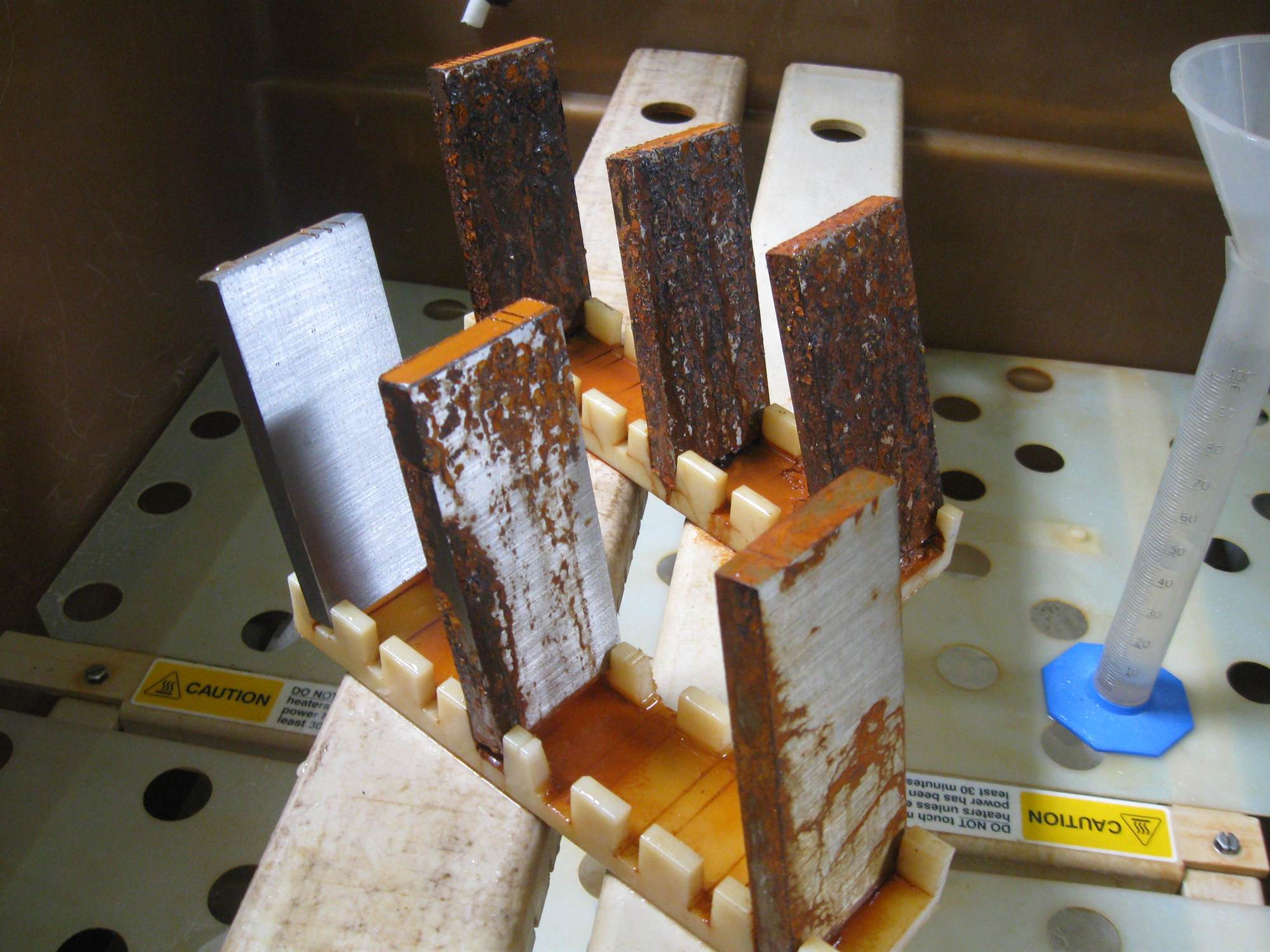

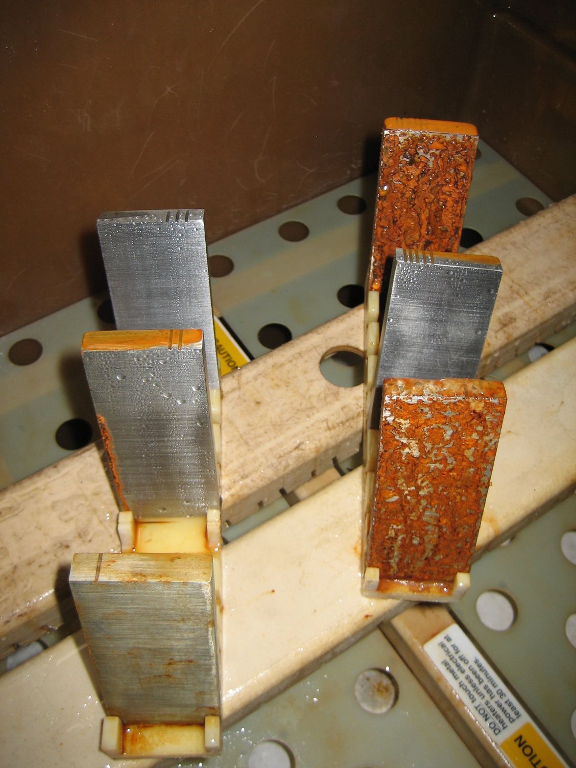

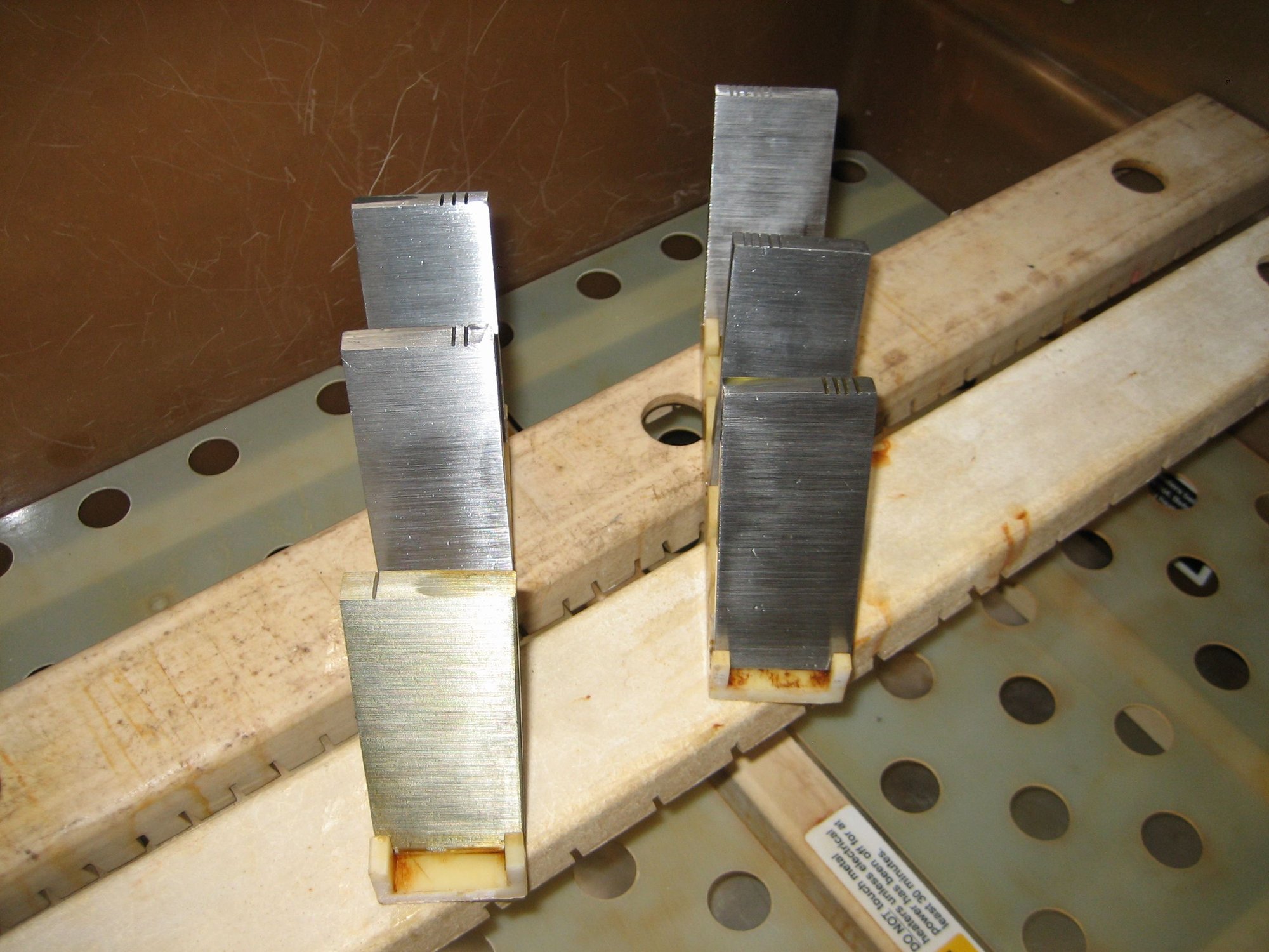

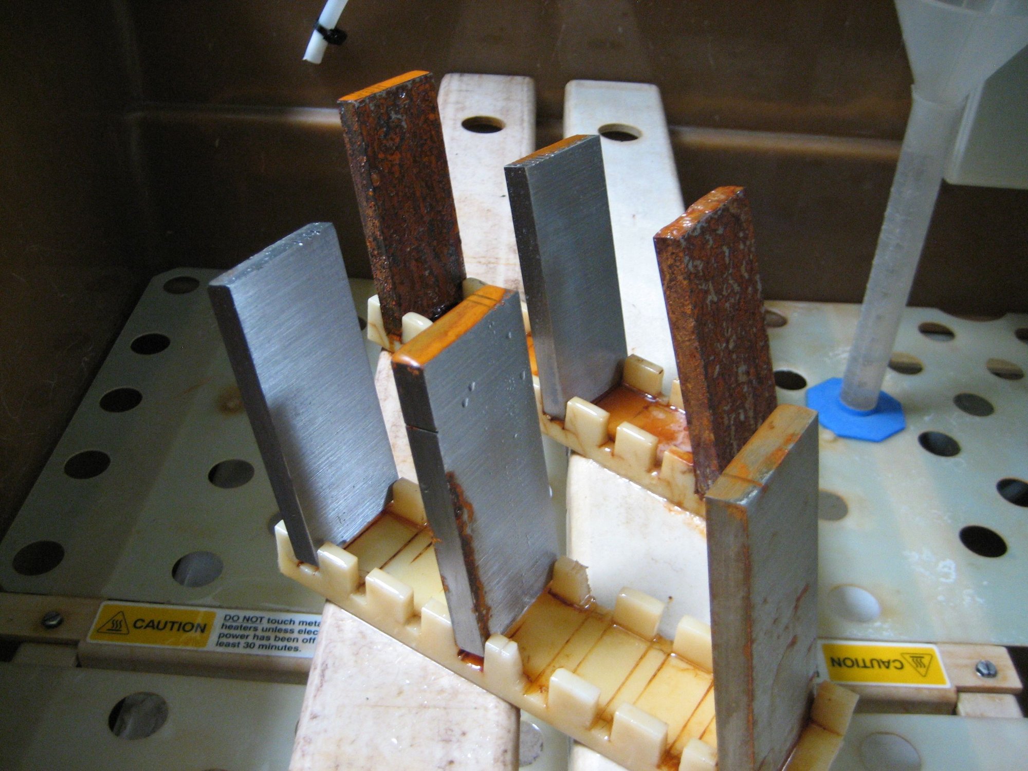

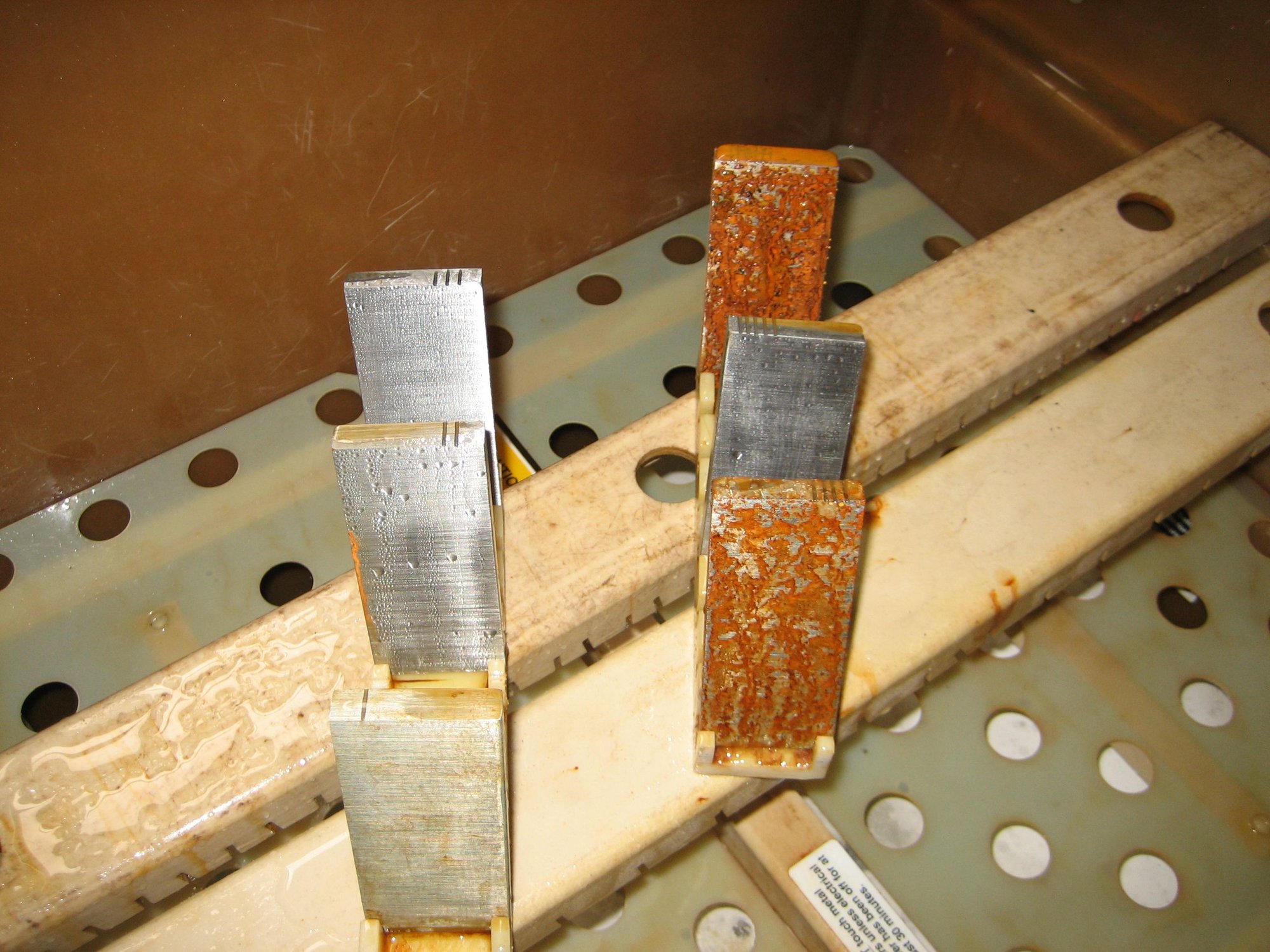

Finished the test a bit ago but had been insanely busy preparing (and working a lot trying to get some extra fund-age) for 10 weeks in Thailand/Cambodia/Vietnam as well as a year in Ireland after.
But yes C.B. was the big winner by a landslide. Framesaver took second.
I have the photos with me so I'll post up a full report once I have the opportunity.
sorry, probably an anti-climax without the pics but promise to get them up soon.
And dont worry if you are using one of the other products, they probably hold up ok in normal conditions.
But in extreme conditions, after everything was rusted to hell, C.B. was shiney and pretty.
