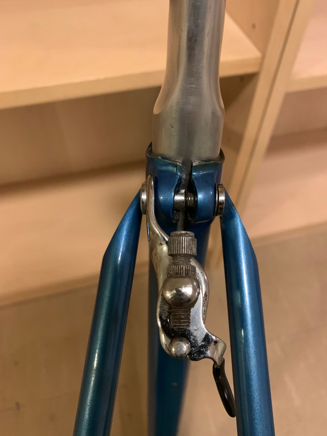

This is the 26.4 post. Fits perfectly.

It does look in the picture of the slot that the post has zigzag scratching. It maybe caused by the post sized used. I would use a fine semi circular/flat file the next time you need to service, or if the bugs of concern get to you.
This may be a point of, if it ain't broke don't fix it.

Originally Posted by DoubleClanger View Post
Try Sheldon Brown. Comprehensive tables of seat post sizes and manufacturer's seat post/down tube sizes.
I found them very useful trying to pi down my 1968 Holdsworth Mistral. Previous owner had a Campa 26.4mm in a 27mm downtube!
Take nothing for granted with pre-owned bikes..
Hope this helps.
Good resource, but be careful, It had my '73 Raleigh Competition labeled as 27.0 seat post. It's a 27.2. I had a 27.2 laying around and should have checked. I guess I have an extra 27.0 Campy seat post if I ever need it...

Let's not talk about the 5 seat posts I bought to find out I needed a 26.6 probably because I didn't know 26.6 existed until last spring then finding a quality post was yet another joy.
