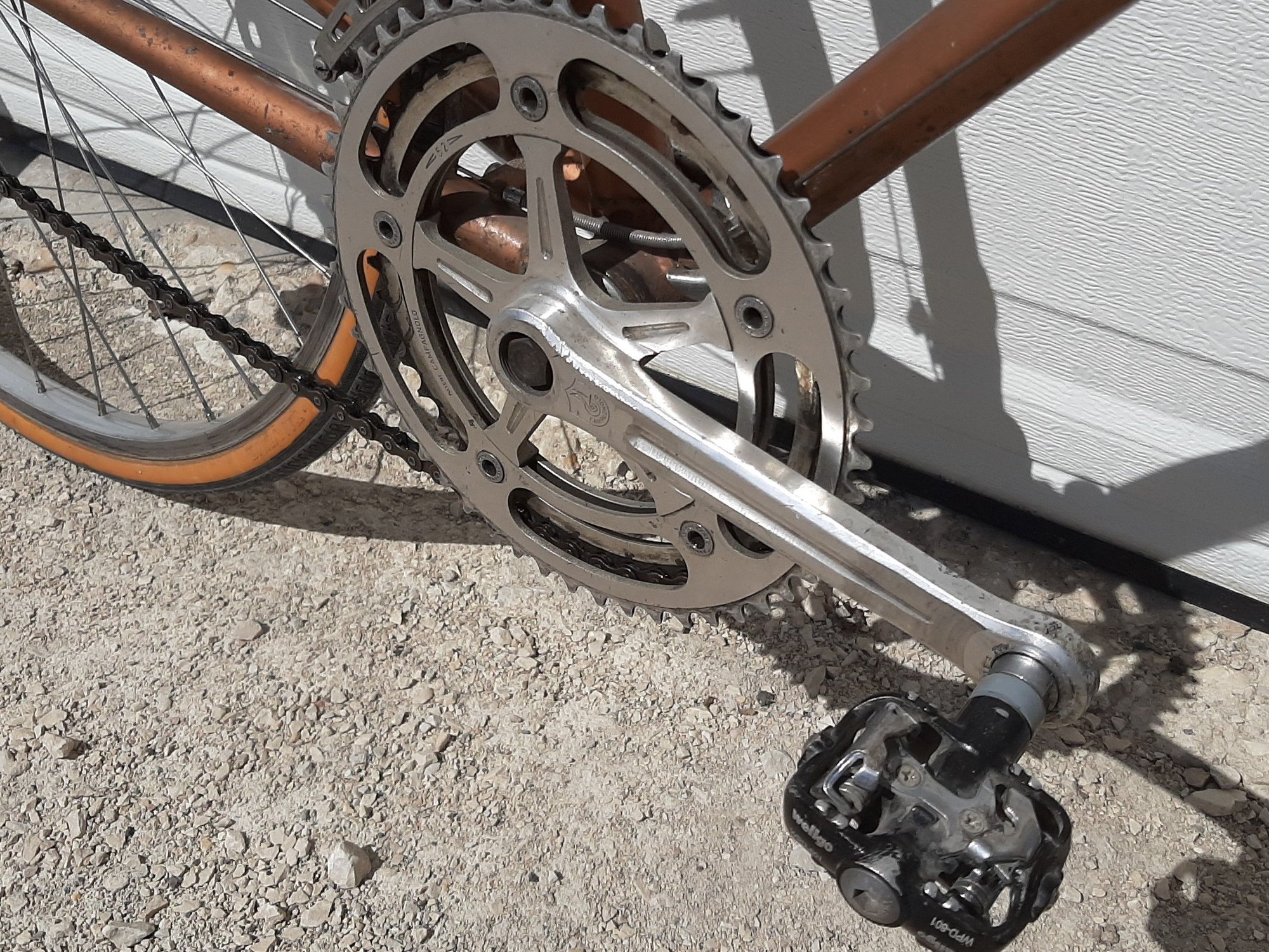

Thanks to the steel rims, which dramatically and negatively impact bike ride quality and stopping ability (brake function gets worse in wet weather with steel rims) I would not make it a daily rider. To that add that I believe down tube shifters to be dangerous, once again suggesting to me that the older steeds do not come up to par with today's traffic and safety demands (that is purely my opinion only and the same goes for rat trap pedals). And, it matters not what bike I choose to ride, I DO NOT ride with rat traps. SPD - period, even though they look so out of place...
Some bikes, even those not really the best to use in today's traffic world, once built up, demand to be ridden. This late fifties Rabeneick 120d, that I recently finished, is not a daily rider, in my mind. But it is will be ridden frequently next Summer. It also sports modern SPD pedals, bar end shifters and alloy rims...

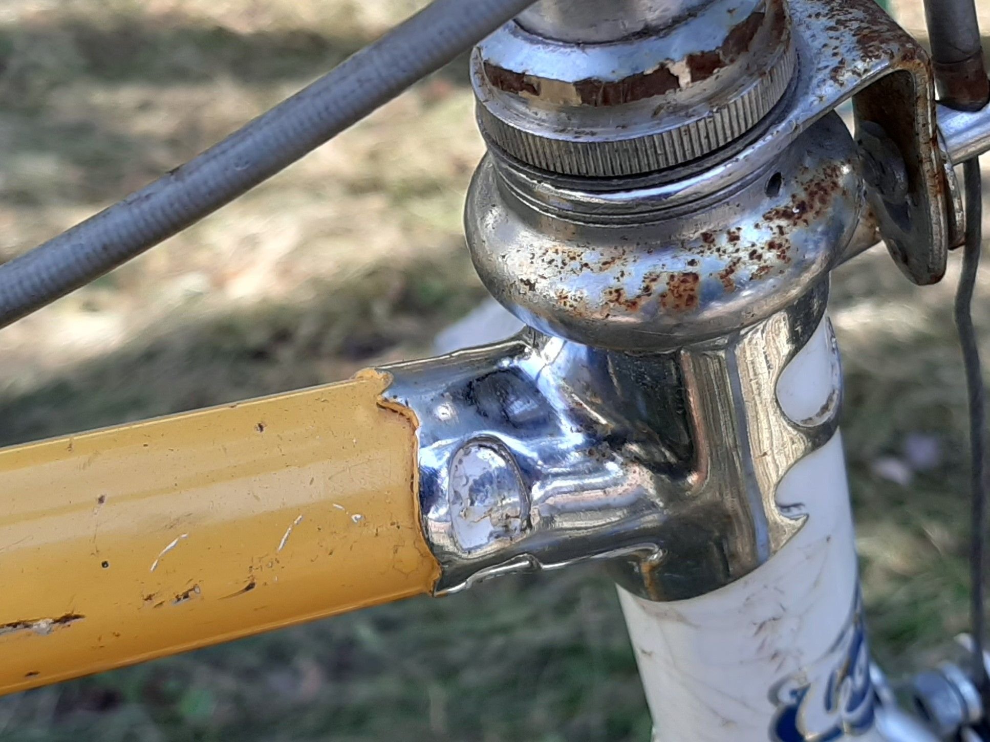

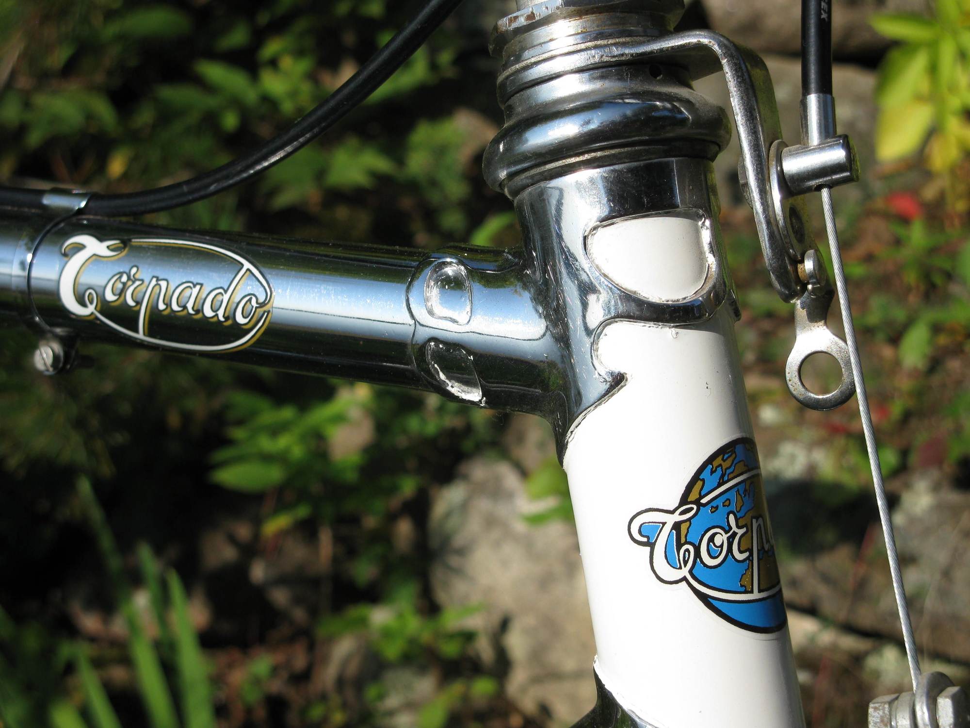

@randyjawa The lugs on those Torpado's are very nice. Any close-ups?
JaccoW is offline
Old 01-03-21, 05:16 PM
juvela
juvela's Avatar
Location: Alta California
Posts: 10,414
Mentioned: 299 Post(s)
Quoted: 2410 Post(s)
Liked 674 Times in 543 Posts
they are constructed with the Agrati "BRIANZA" pattern lug set item nr. 000.8030/U
Brianza is a place name in the home town of Agrati-Garelli
the upper head lug is item nr. 000.8034
the lower head lug is item nr. 000.8033
seat lug is item nr. 022.8039
fork crown is item nr. 000.8038
seat lug on Randy's yellow Torpado is from another Agrati lug set, the "CORSA", and is item nr. 202.8529

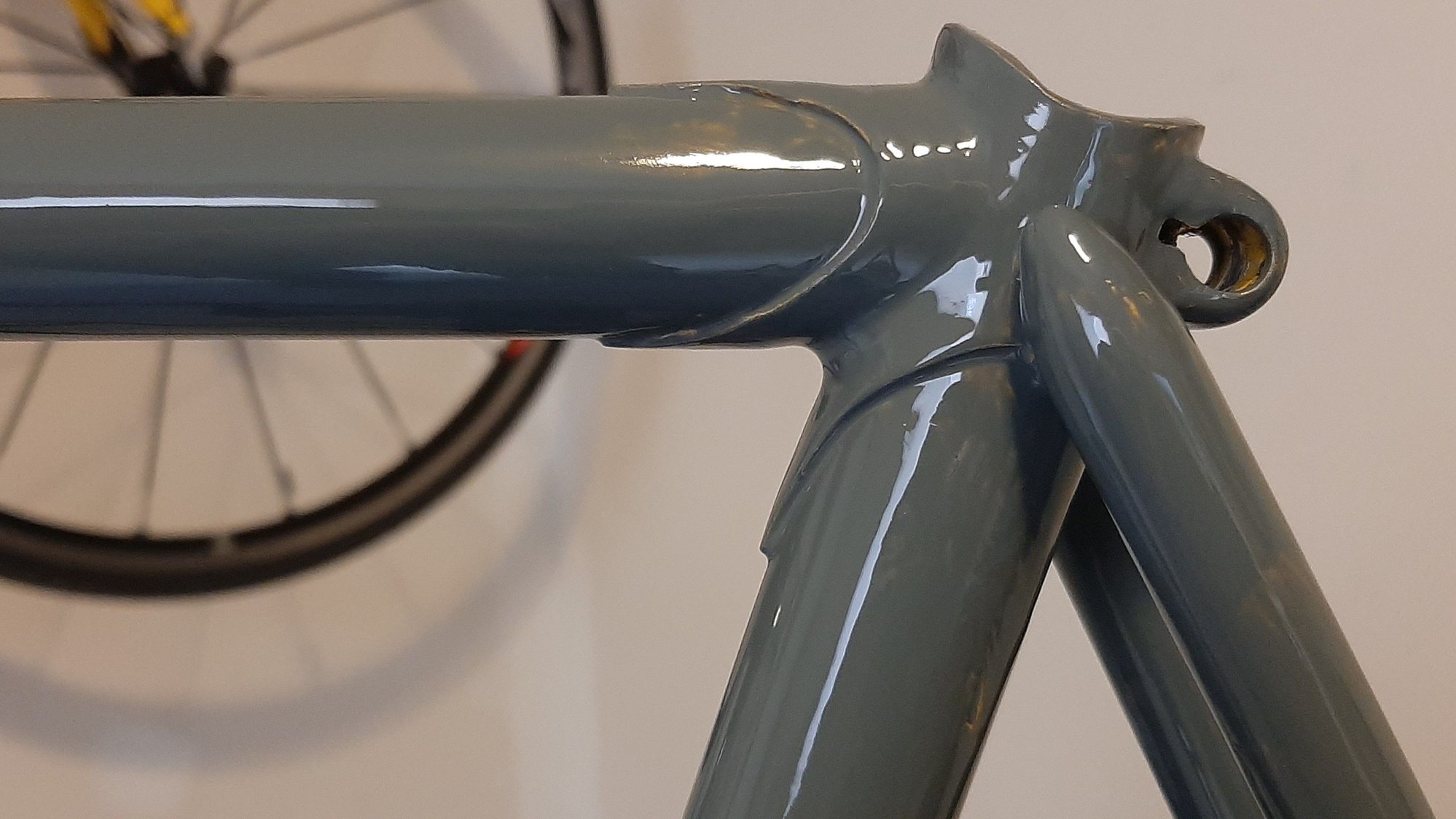

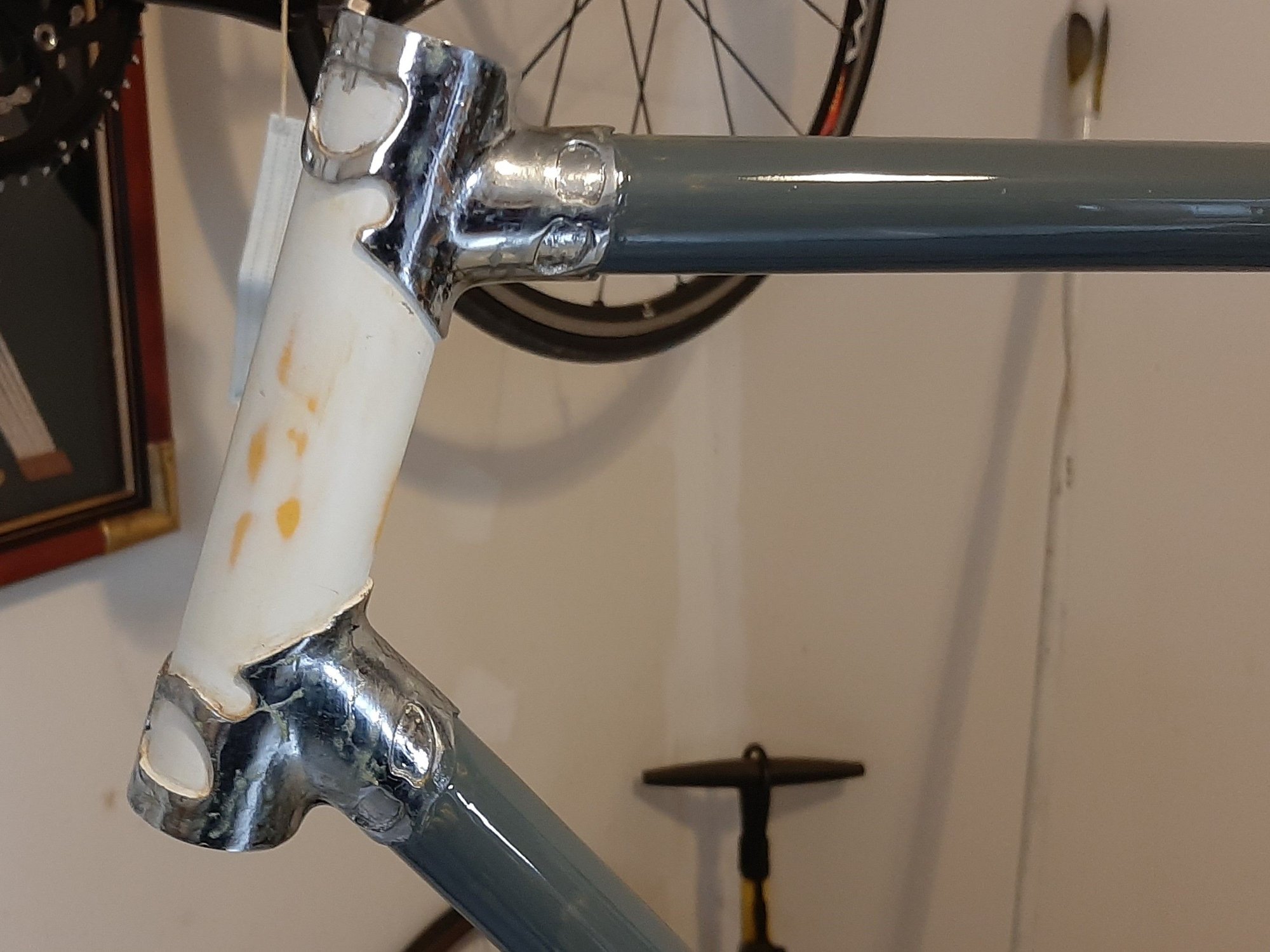

The Torpado lug work is one of the reasons I like my Torpado bicycles so much. Over the years, close to ten have come my way. Built up four or five.
All chrome bike but I chose to do the off white on the head tube only on this Torpado Luxe...
The yellow (now grey) Torpado is in the paint stage right now...
The pooey stinko looking chrome is actually chrome in great shape. The ugly is liquid latex, a product I use for intricate masking tasks...
The lugs on my early sixties Professional are very pretty and nicely fitted. Adding to the lovely chrome lug work is a great old headbadge, something else I really like on a vintage bicycle...
The entry level yellow Torpado lug work is no where near as well done as the lugs on the Pro. Makes sense, I guess...
First coat of grey applied and Bobby B is gone...
