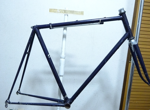

Hi Guys,

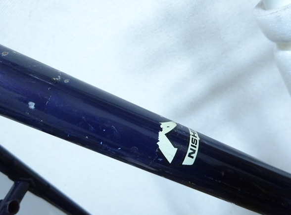

Need help identifying what this Nishiki Frame is. As far as I can tell it says made by Kawamura in one of the lower tubes. Anyone seen this kind of frame before? Would you know its specifications? What would it be worth? If I were to build it up what considerations should I have?

the recessed brake mount and round-oval-round chainstays when combined with other features are suggestive of an early 1980's machine

Mid 80's Logo, so close to that date. Feature seem to be of that period as well, and it appears to be club style race bike. Size would help in giving it a value. Smiles, MH

Its in my size, I guessed it might be 80s but it doesnt seem to have the nubs for downtube shifters? What is a clubs style race bike? Do those ride well?

The shape of the head tube lugs matches some of Nishiki's higher-end Kawamura-built frames from the late-70s and early-80s. If it is, it will be a very nice ride, indeed. The raw fork crown looks like a one-off customization by the owner, possibly part of a repaint. I'd be curious to see what the serial number on the bottom bracket tells us.

the brand offered a top line pro frame around this time which was designated by three letters
cannot quite recall them but the Nishiki experts are sure to know
want to say it was something such as "OCV"
fork note: TANGE offered off-the-shelf forks identical to this at this time, wonder if fork ends are a match for the dropouts, conceivable that fork could be a replacement painted to match cycle, do not wish to assert that this is the case, mention it only as a possibility...if fork ends are marked TANGE and dropouts are marked SUNTOUR that would be a clue...

Hard to tell with that dark paint but it looks to have a braze on of some sort on the downtube, right? A close up would help.

No closeups in the pics unfortunately though I did ask. To me it does not look like it has any braze on for downtube shifters.
This one looks more like paint damage to me.
Could be a Nishiki pro. I initially thought it might have been a Nishiki Cresta but then figured its not likely since the Cresta has attachments for touring stuff in the dropouts.
So if I do decide to get this bike, what kind of considerations do you think I will have to deal with?
Is there a workaround to using downtube shifters on a frame without braze ons?
Or can I buy a more modern 105 and use brifters instead?
The top tube cable guides seem to be rusted out, is this indicative of a larger frame rust problem or should the frame still be good?
If I do get this frame I will also need to get BB, crank, rear cassette, pedals, front and rear derailleurs, brakes, cables, wheelsets, saddle and handlebars. Did I miss anything? This will be my first time building a bike from parts .
Lastly, what kind of bottom bracket should I be looking for? I read somewhere that there is quite the variation.

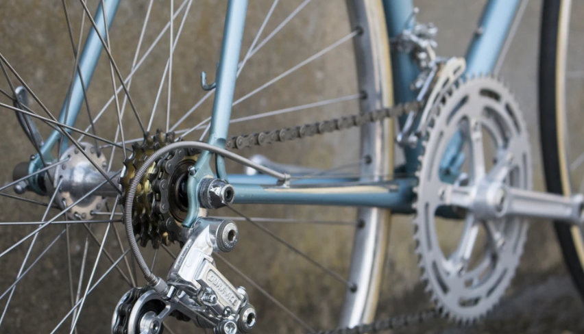

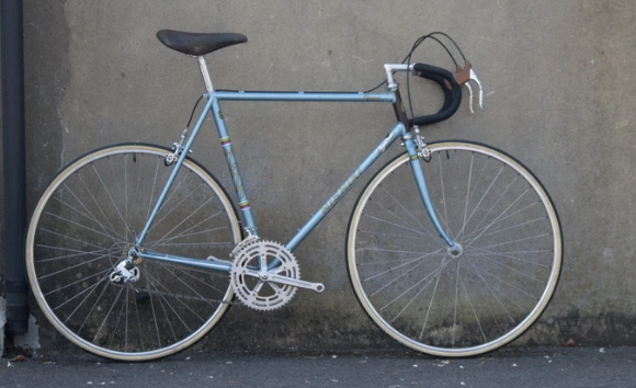

There are clamp-on shifter bosses. These would would work for either downtube shifters, or to mount cable stops for brifters.
The bottom bracket is English thread.
You forgot a seatpost (it will probably be either 27.0 or 26.8), brake levers and shifters (or brifters), and handlebar tape. I can't really tell from the pics you posted, but you might also need a clamp-on cable guide at the bottom bracket.
This is my '77 Nishiki ONP, built with parts from the era (mostly SunTour Superbe)
This is the thread from my project last year that documents my progress through the build...https://www.bikeforums.net/classic-v...d-project.html

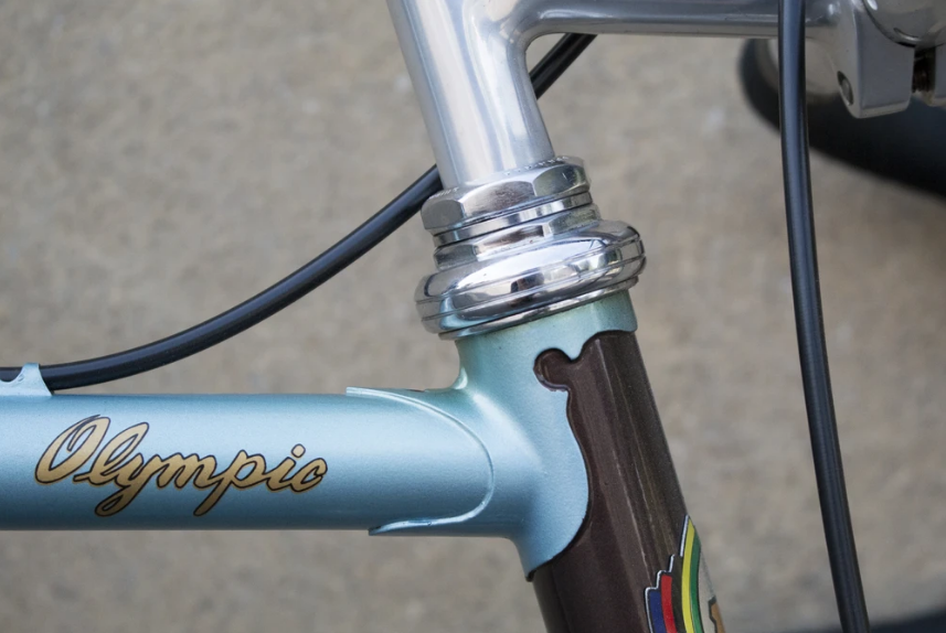

I think given there are no top tube cable guides this rules out a Nishiki Pro since I cant seem find one with cable guides either. I have however found that this might be a Nishiki Olympic? Which is supposed to be made out of Tange Infinity or Tange Champion? Know anything about it?
Dropouts dont have rando dimples. Seem to be similar style too.
Tange Champion? 1987 catalog says Tange Infinity
Top tube cable guides
Lug style matches
What do you think? Likely an Olympic? This is the closest I can get referencing photos from what I have researched. Only thing I cant match are the decals.
So this poses a new question. The seller has indicated the rear dropouts are 126mm. I read that this means I have to buy a 6 speed groupset since the newer ones wont fit. I am looking at a old Shimano 105 with Biopace chainring. Does old shimano 105 offer the clamp type downtube shifter you showed earlier? If not, would it be that bad for the bike to manhandle a 2005 Shimano 105 to fit? Some posts say 126 to 130mm is not that difficult to force fit.
Are the BB sizes the same? Is it worth upgrading BB's to something newer vs the vintage 6 speed sets or is there no performance difference?

The Olympic is a possible candidate. Be aware that Nishiki also had the same frame with different model names depending on which area it was being sold - US/Canada/Europe/Asia. The more I look at the pics you have posted, the more I'm convinced it's one of Nishiki's better frames from the early-'80s, and it's been repainted. As such, I would also bet those aren't the original decals, which would make your attempts at decal-matching to determine the model an impossible task.

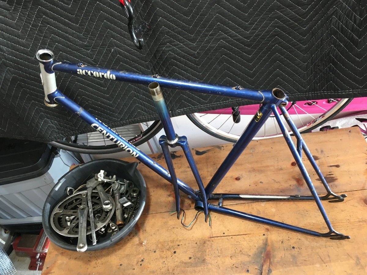

Here's a 5 speed 126mm spaced Centurion that I converted to a 7 speed recently. I put an inexpensive set of Shimano trigger shifters on it. Upright handlebars. (Of course). What an absolute joy to ride. It sold on Craigslist for full price after being advertised for just four days.
