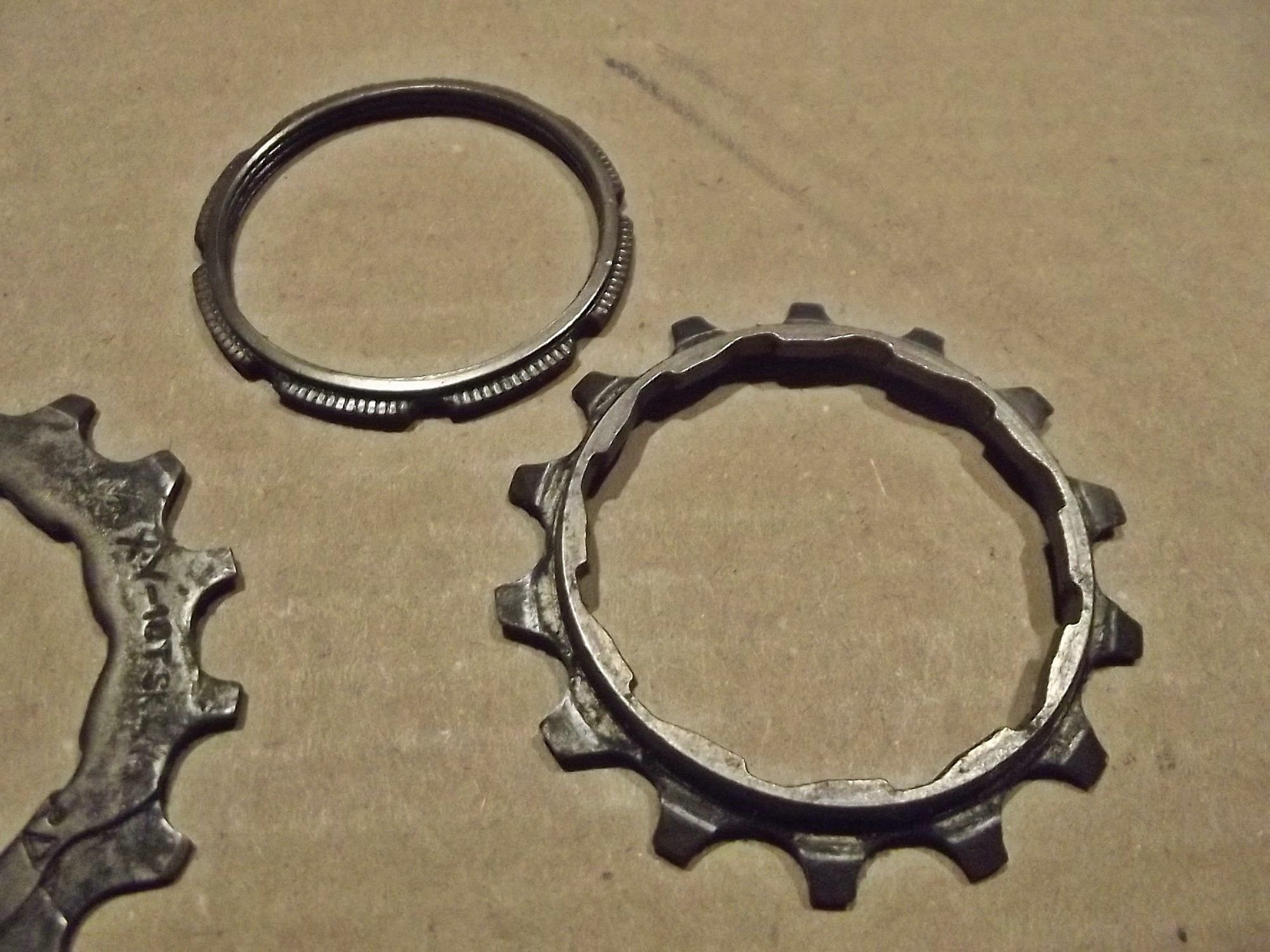

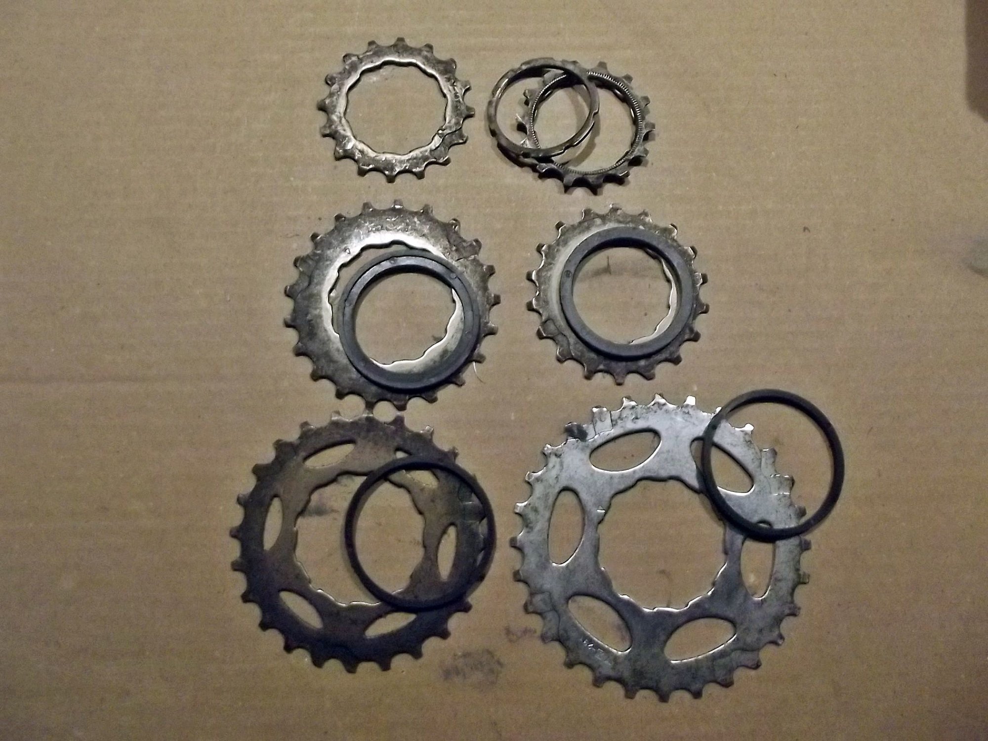

Thanks for that link Bill, it really cleared up my issue. I'm posting the pics in the next box for everyone to see, but it appears to me it's a hyperglide from the late 80's.

I made a quick stop out on the road the other day and never even thought about down shifting to get started again and I was on the 52-14 gears. Flat ground and a slight push off and I was rolling again.

Here's the culprit. 14/16/18/21/24/28. It's all held on the freehub with a threaded lock ring. The smallest gear (14T) has a built in spacer that snugs against the lock ring. Thanks to Bill's informational link, it appears this is one of the first hyperglide setups from the late 80's. Hope this answers everyone's questions. I have a 13T that will fit it and I'm going to try that when I get back after the holidays. Hopefully it's the answer I'm looking for. Thanks for everyone's help and great information.

Originally Posted by Bigbus View Post
Here's the culprit. 14/16/18/21/24/28. It's all held on the freehub with a threaded lock ring. The smallest gear (14T) has a built in spacer that snugs against the lock ring. Thanks to Bill's informational link, it appears this is one of the first hyperglide setups from the late 80's. ...I have a 13T that will fit it and I'm going to try that when I get back after the holidays. Hopefully it's the answer I'm looking for. Thanks for everyone's help and great information.
...if you already have that Hyperglide freehub on your wheel, I'm pretty sure you can just buy a current Hyperglide cluster in the 7 cog version made by somebody like Sunrace that will both be all new cogs and have something on the order of a 12 or an 11 smallest cog in the set. The only thing that might be an issue is the width of the freehub, but if that's a 126 spaced rear wheel, the 7 speed cog sets should fit. Shimano also still makes and sells 7 speed cassettes.
It's been a while since I worked on one of those, which is why I'd advise measuring the width of the freehub body before you spend money on a cassette. If the set is too wide by one cog width, you can still use it by leaving off the smallest cog, but since that's the one you want, it seems pointless to do that.

...if you already have that Hyperglide freehub on your wheel, I'm pretty sure you can just buy a current Hyperglide cluster in the 7 cog version made by somebody like Sunracethat will both be all new cogs and have something on the order of a 12 or an 11 smallest cog in the set.
Do we have photos of the original hub/cluster?
I think those look like they came off of a freewheel rather than a freehub.
I am a little puzzled that frequently the freewheels have a progressive size of inner shoulders for the sprockets to mount on. Nonetheless, looking at the size of the 14T, I find it doubtful that an 11/12T sprocket will fit on that same freewheel.
And, since freewheels weren't fully standardized, it can be hit and miss whether parts will interchange between different freewheels. Generally not with cassettes.
I think at least one users on this board does frequently rebuild them.
While "Hyperglide" typically applies to cassettes, I think it can be applied to an indexed shifting technology as applied to freehubs too.
CliffordK is online now

Looking at the "lock ring" in the OP's photo it appears to be a lock ring for a freewheel, not a cassette. Threads are in the inside of this lockring.
A cassette lockring looks like this: Threads are on the outside

Those are freewheel cogs.
Yes. In the context of cassettes, the switch from Uniglide to Hyperglide involved a change in the design of the freehub body. But in terms of how Shimano uses the terminology, Uniglide versus Hyperglide primarily refers to how the cogs are profiled to facilitate smooth shifting. An MF-TZ20 six-speed freewheel is a hyperglide freewheel, for instance.
