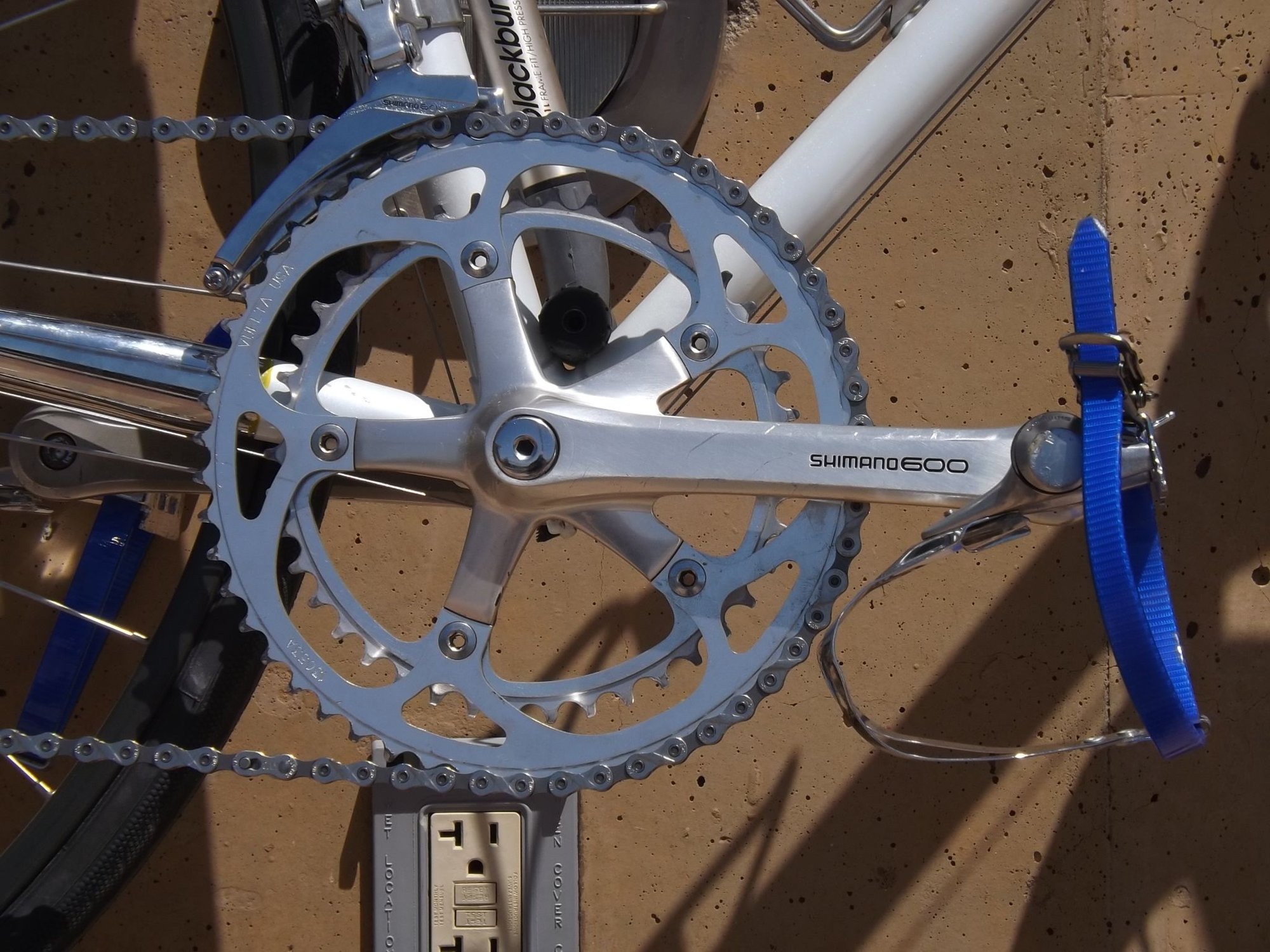

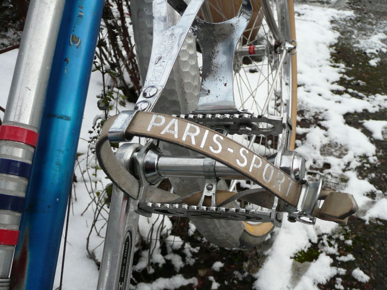

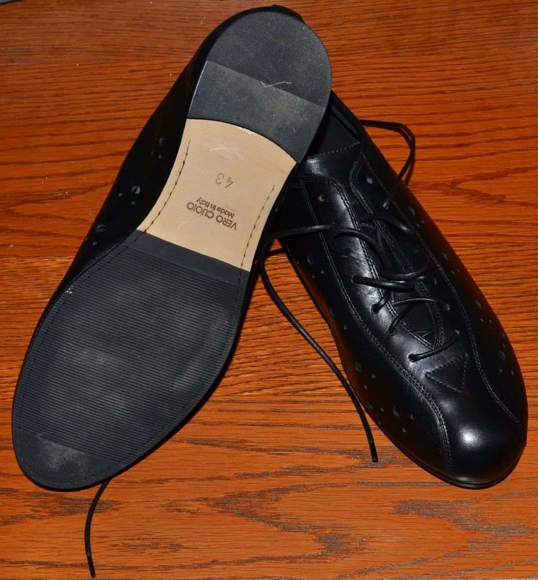

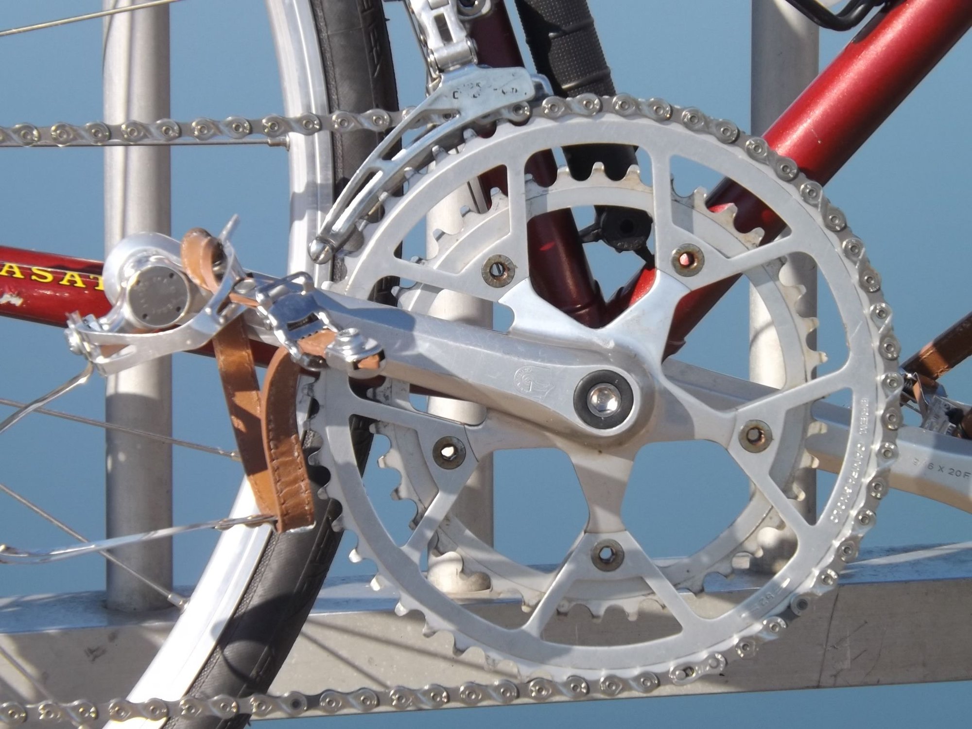

...some comments on the above images:
1. Right now, about the only pedals I'm buying and installing are either MKS Urban Platforms (new), Shimano aero pedals (used...they made them for years, and come under various designations like "600", "Dura Ace", "105", etc.), MKS Sylvan ( the wider, regular ones), and MKS AR-2 (new).
2. The best straps I've found are either the old laminated leather ones from Performance (no longer available from them), and the brightly colored old Pake plastic laminated ones (also no longer available ...sometimes you can scrounge around on e-bay and find some old stock.)

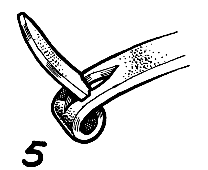

3. I lucked into a whole card of strap buttons a few years back, otherwise I wouldn't use them. The ones I see for sale (like the VO orange ones are way too expensive for what they are.)
On a lot of straps, you can substitute for buttons by folding the long end of the strap over, punching it with a leather punch, and inserting the appropriate sized pop rivet. (Wait until you're sure the setup is good before you rivet the end.)
4. If you have a co-op or other used parts supply locally, some of the earlier, black woven nylon straps are stiff enough that they work well. The new ones have sucked for years.
5. On touring setups, I usually go for either an MTB toe clip, or the ones you can buy online for about 8 bucks that are made by Soma. The white ones are cheap, the chromed ones are more expensive. For road aero and quill pedals, I use a standard single gate clip. The Campy and Shimano aero clips are difficult to find any more. Again. I just lucked into a supply some years back in the appropriate size. But if you can find a set of Shimano aero pedals with the right size clips, combined with a stiff enough toe strap they are my favorite pedal. It's just hard to put all three things together nowadays, because you can't buy any of them new.

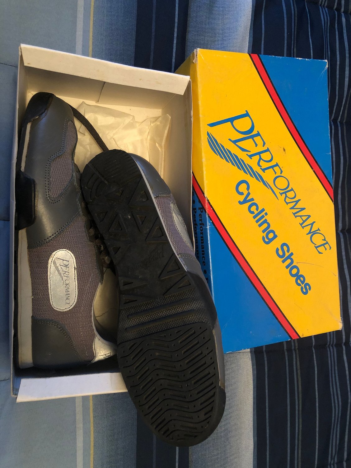

6. For shoes, I'm currently having good luck with some Pearl Izumi MTB shoes, that look like regular running shoes, with a tapered toe, but a wide last and stiffer sole. My 70 year old feet require arch supports. The best ones I've found for this are the thin nest ones they sell at REI, branded "SOLE". Sole also has an online website, where they sell them directly by mail.

I love my Pearl Izumi MTB shoes, so comfortable and ventilated. The soles are a bit heavily lugged to get in and out of clips and straps easily though, at least for me. Maybe they'd work better with platform pedals.

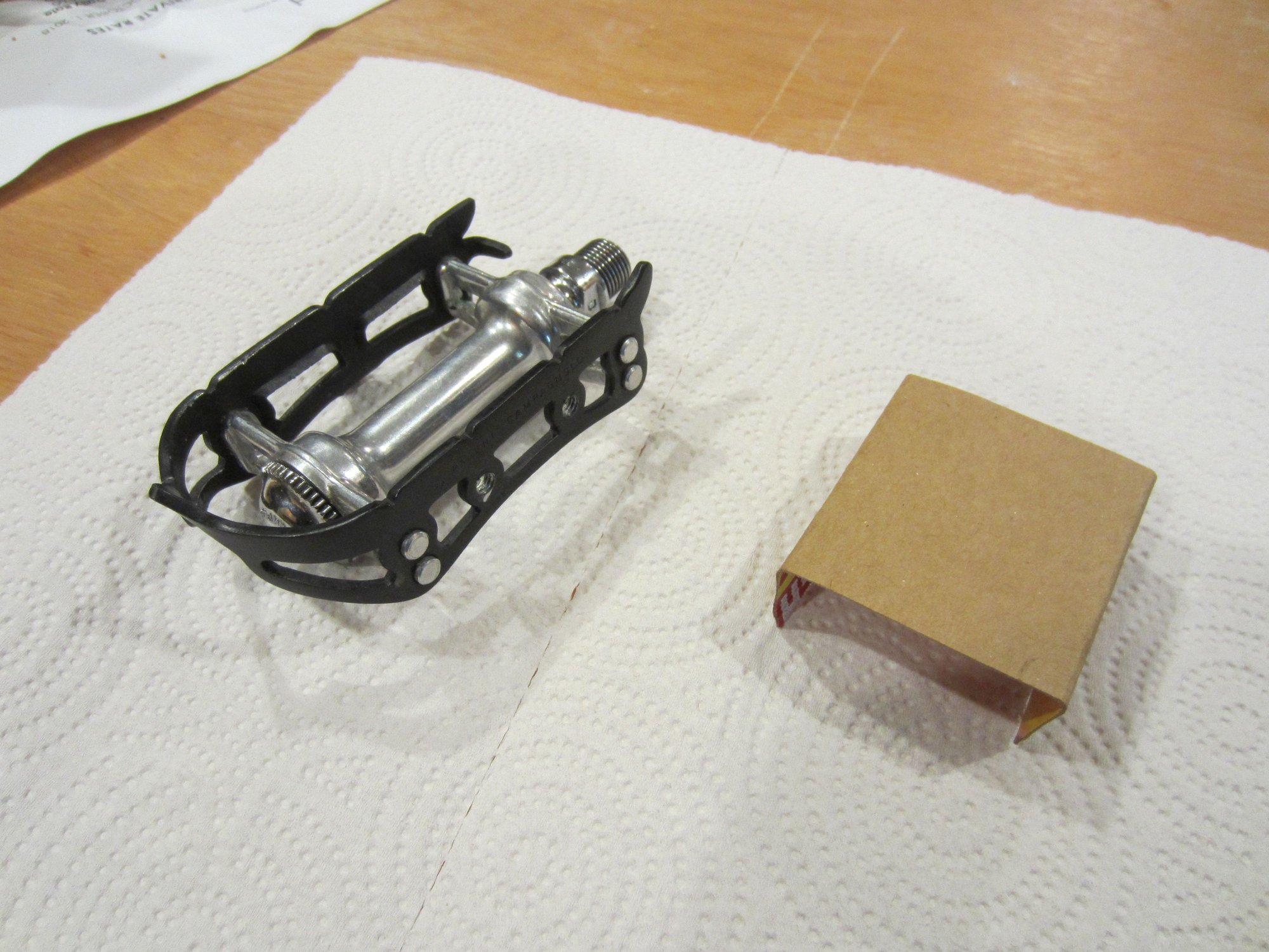

Always counted myself lucky to not have major pedal issues. No modern clip in with a crooked ankle which is fine since I hate the aesthetic and don't ride hard enough for it to matter.
Can't imagine C+V with out Campy or MKS, no cleats as the ankle thing requires it to "float" a lot, regular oldschool clips and barely snug straps work great.

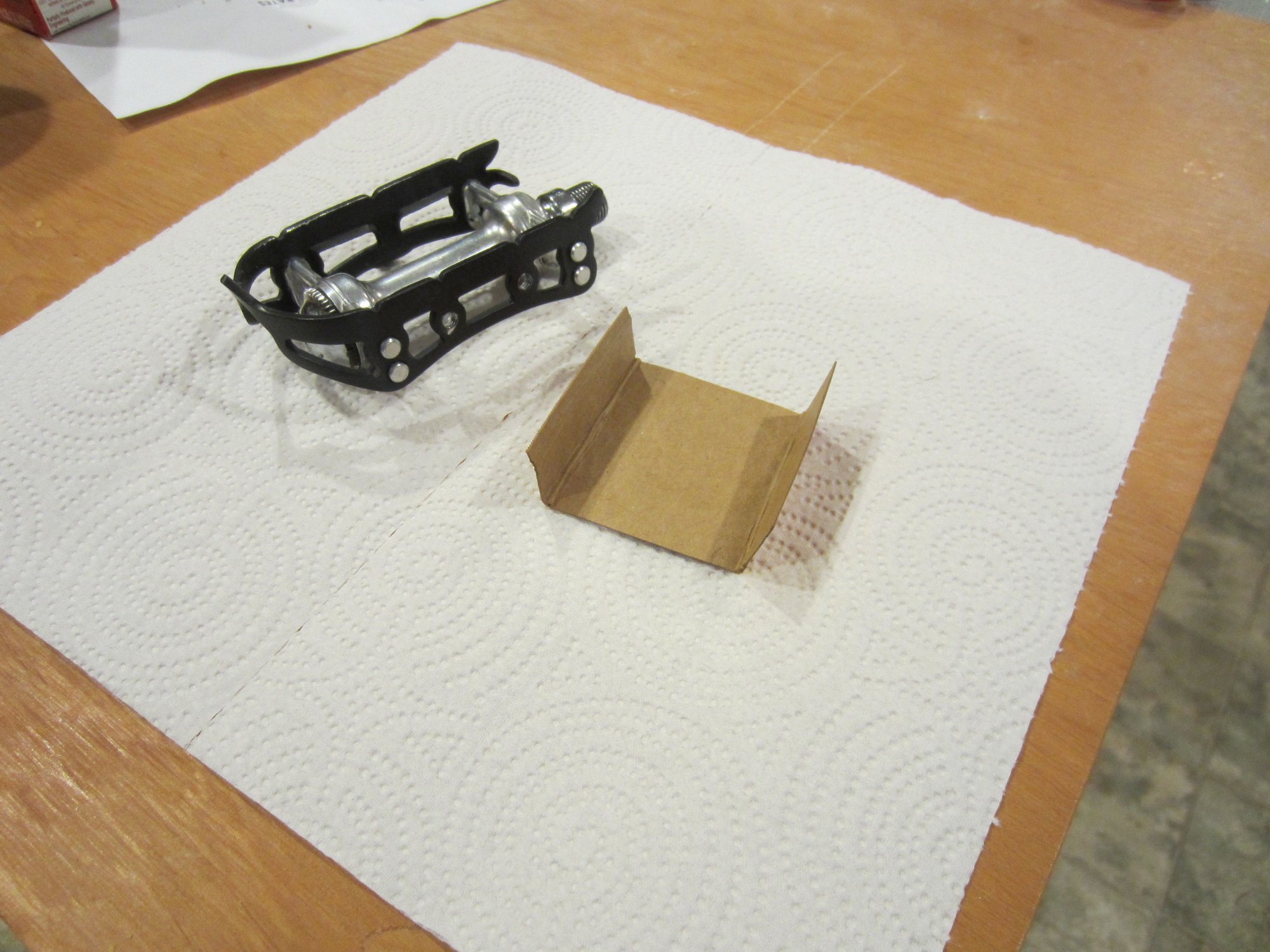

I have given it plenty of thought though and figure I will do something like this if need be.
Just add a platform inside the pedal for support made out of aluminum or stainless thin plate secured to the clip screws on the inside.
They could be drilled or slotted some so as not to be quite so visually offensive but no one will see them while riding anyway.
Here's a mock-up out of cardboard.

Love this thread! My road bikes all wear clips and straps with pedals of the day, except for the Cannondale Criterium Series that has something newer, anything light and durable.
The 1898 has Pirate rat traps, very light and serviceable, still work great. The 77 Colnago has Campy Superlegerro with Binda’s. The 86 Trek 760 has Superbe. Etc etc
Shoes. Here is a pic of NIB Performance Bicycle (Pacer 9 1/2) where you can see a tread incorporating a semi-cleat slot. I think they are late ‘80s shoes.
OldsCOOL is offline

Two more examples that work for me (with wide feet.)
...this one is the (pretty cheap) MKS AR 2, which is a very wide pedal, with a very short quill. It has the additional advantage of a longer spindle that makes the pedal cage to crank arm distance greater than some other pedals.
...an example of Shimano aero pedals with those Pake Space straps, that maintain shape very well. They might be a bit too colorful for some C+V tastes.
