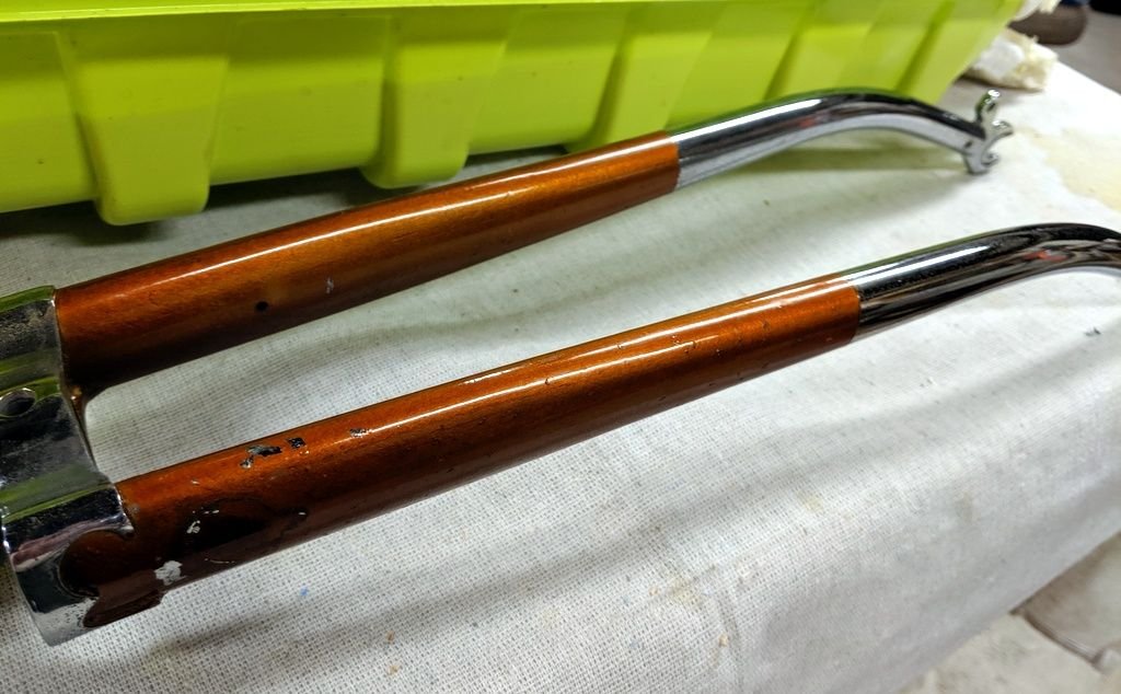

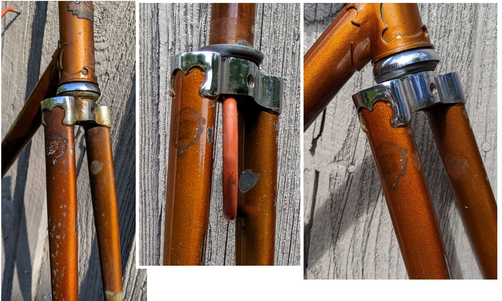

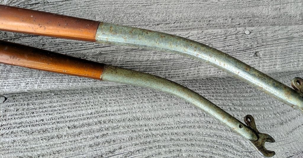

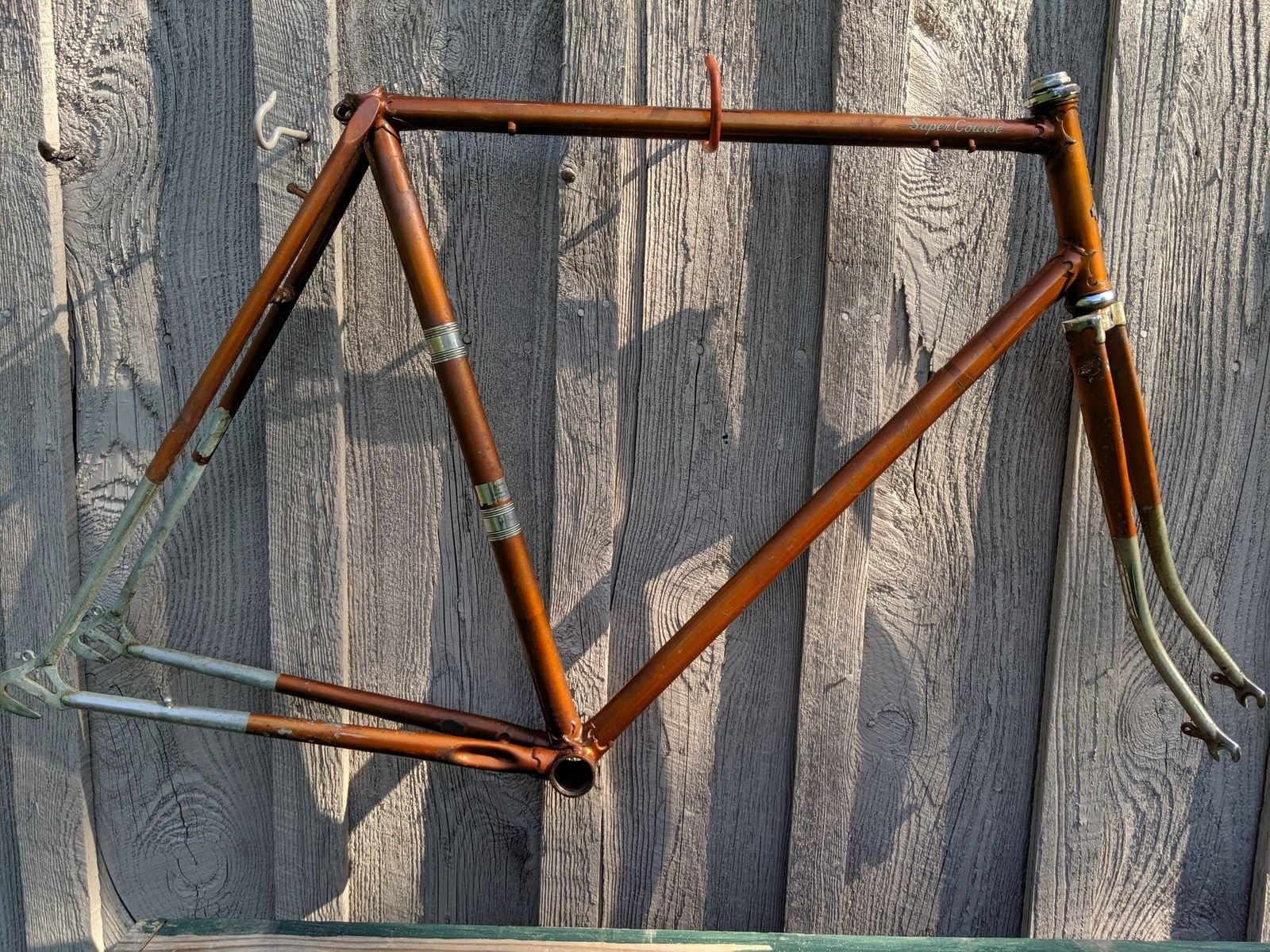

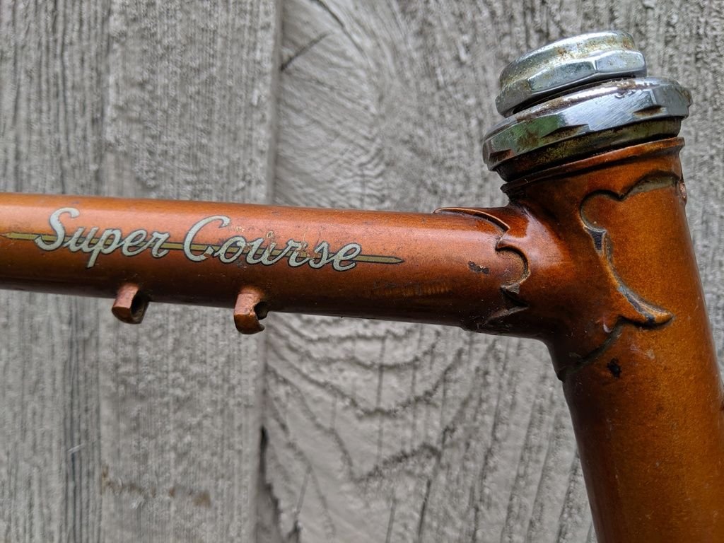

This Super Course came to me as part of the bargain for another bike I bought last year. It's too small for me at 23 1/2" but it should make a good "guest bike". The chrome was fuzzy and the paint was worn off in places so I thought I'd try a bath in Evaporust. I used a wallpaper tray, starting with the fork and then soaking one part of the frame at a time. This approach takes more time, but it is compact and you can control how much of the frame you soak based on need. Some photos:
fuzzy chrome
After a bath and some cleaner wax
Jars of water to raise the ER level. Baggies of gravel would work better
You could hang the frame from a chair or a stepladder.

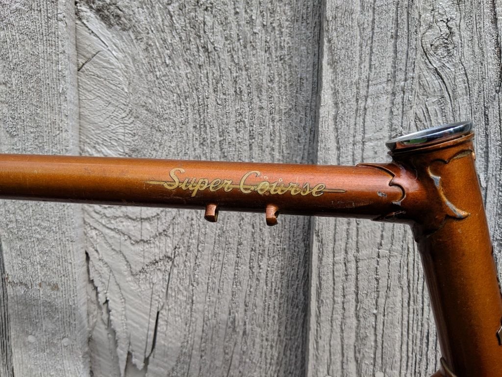

White decals yellowed. Not sure if this would have happened with fresh ER
Lost paint on the headbadge....

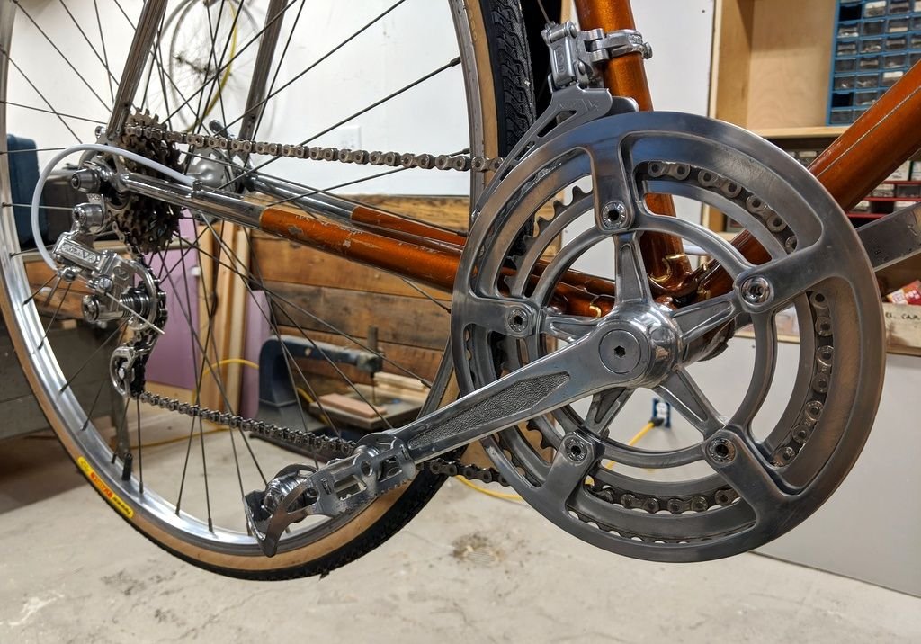

Used Testor's Gloss Brown tinted with Flat Brass to cover any bare steel.
After touching up the bare steel
With some shiny parts!

Do you have to immerse the frame? How long do you soak it? Can you brush it on in several coats? How many "dunks" do you get in each bath? Do normal DIY stores carry it, Home Depot, Lowe's, etc. ?
With the liquid Evaporust, you need to immerse the frame so it stays liquid. There may be a gel version for spot treatment but I haven't used it. I soaked 24-30 hours for each part of the frame and cleaned with a toothbrush. I paid $20 for a gallon at the local Tractor Supply store. It is re-usable, so I poured it back into the jug when I was done. The outside was rinsed with water and toweled dry. This is the second frame I treated with that gallon.
Originally Posted by Pcampeau View Post
scared off by, if I remember correctly, a warning on the bottle that said not to use it on chrome,... Is that warning really on the Evaporust bottle or am I misremembering?
I read the label again and there is no warning about chrome. I've used it on many chrome parts and it works very well. Does not damage aluminum either. Some steel parts (bearing races, bolt un-chromed heads) may turn black however. Not to be used on red paint!
I'm pleased with the results with the exception of that white SuperCourse decal. It may need additional washing or perhaps OA spot treatment using Barkeeper's Friend. I hope to nail down the brake lever placement this weekend and wrap the bars - if it warms up enough.

The serial number on the dropout is 337456 and the downtube has the older script "Raleigh", so I think it is a 1972 model, although it could be earlier. It was a bare frame w/ headset when I got it, so the SN is the only thing I have to go on. The paint has really faded into more of a copper color than coffee brown and I like it. The Nervar star, Suntour VX and stem came off a rattle-canned Grand Sport that I picked up for rustystrings61 when I was looking for parts.
