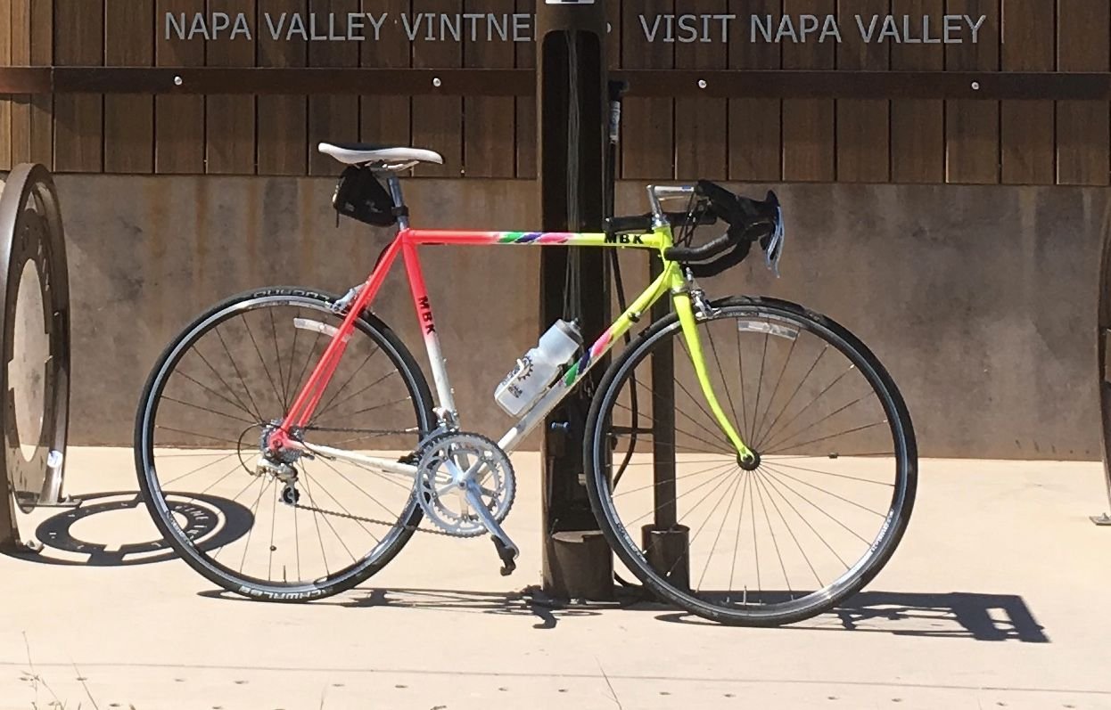

A picture of my first rebuild:
1992 Ochsner

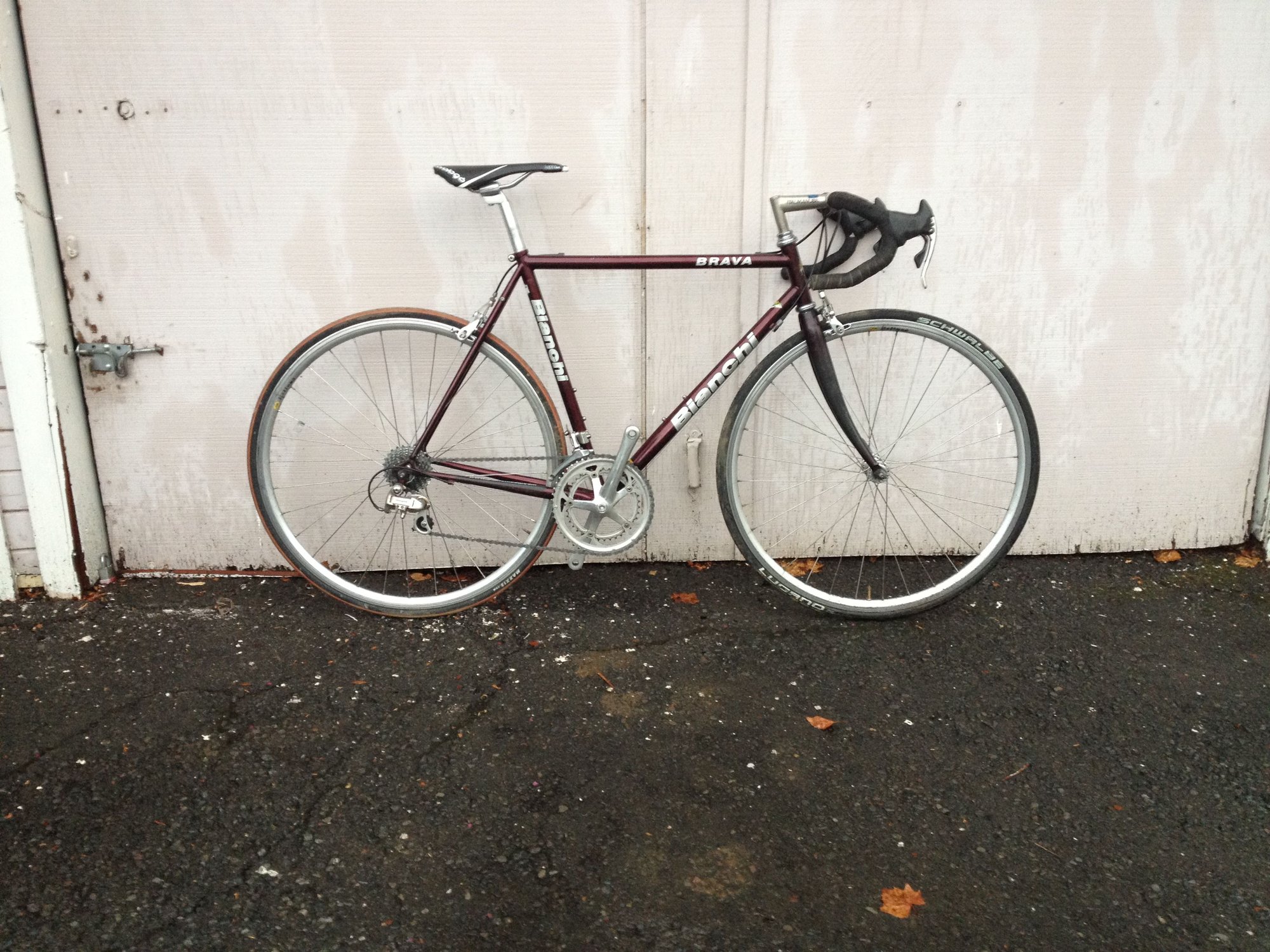

I built this bike up completely bought off eBay, amazon etc. Maybe couple of spare garage parts (the saddle), and I had to replace a couple of cables. 8 speed Mirage/Chorus blend.
I recently switched it all over to this frame. Faster and more fun, but the steel fork is definitely less compliant on a badly-paved descent. I have more plans for this one, including a future move to 11-speed Athena.
Neither build was done with complicated tools. I had a 10ish year old tool kit that I got from Performance Bike that had most of what I need. The only specialist items out of it that I used were the crank puller and the freewheel remover. And, separately, a big spanner to tighten the threaded headset. Almost everything else can be done with a good multi-tool if you're patient enough.
Nice work. I like that bike frame it looks very refreshing and exhilarating, and stylish. I like that crank arm..is that Chorus?
Itís very exhilarating, thanks.
The cranks are actually Mirage, from back when all Campag groups were pretty much identical.
The cranks are 170mm, which is a bit shorter than Iím used to on most bikes, but I actually like them. 172.5mm is the standard length for most guys my size (Iím 5í10 and ride bikes in the 54cm to 56cm size range), but Iíve had 175mm in the past.
Try not to get too hung up on upgrades, though. The bike you have, if looked after well, will ride beautifully year-on-year. If you take care of it, it will take care of you. Much like your health. I had my own issues with anxiety a few years back, and building and, most of all, riding that Bianchi was a big part of my recovery.
I hear what you say about how new Potenza will give you the motivation to go out and ride, but I find that the thing that motivates me most to go out and ride, is actually going out and riding today, which will make me want to go out and ride tomorrow.
