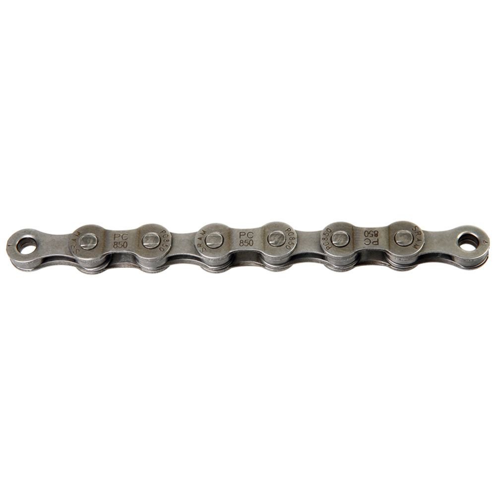

Originally Posted by icemilkcoffee View Post
Which brand 9+ speed chains have this flush rivet feature? Does KMC chains have this feature?
To my knowledge, all common 9 speed chains except Campagnolo plus all chains for 10 or more cogs are flush riveted including KMC.
It's needed to prevent contact with the adjacent cog as you fit more into the same space
E.g. KMC X9.93
vs. SRAM PG-850 7 speed chain
Some chains for fewer cogs have the pin ends peened over like the KMC Z72 7/8 speed chain
but many if not most do not.
I'd bet against against an inexpensive non-bike store model coming with one due to the higher production cost from the peening operation, although obviously nothing precludes retrofitting one.
