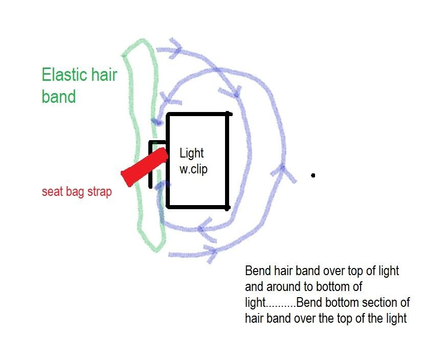

After losing a Cygolite red rear blinkie on a road ride few months ago, I needed a way to keep it on the strap. On my straight top tube bike, I can not fit the seat bag and the seat post mount on the post as there is not enough room for the two to fit.
So after buying another red tail light, I was searching around for ways to make sure it would not pop off again. I was pretty shocked that it popped off to start with as my strap is actually pretty tight. I even wonder if someone took it off my bike as I entered a sandwich shop. I doubt it but it is a possibility, one never knows. But either way, if one tried to take it off, it ain't going and if it wants to pop off on its own, it ain't going either.
The band I use is black and actually not very visible to the eye unless one inspects the connection. Even when I go to take it off, I have to look pretty hard to see the band. I usually need a screwdriver to get behind the band as well to remove it.
But I have found that using those elastic hair bands women use for pony tails are great for securing my red tail light. Grabbing a hold of it and trying to force it off has not worked yet as much as I have tried so I feel pretty secure with it.
The lights I use have the clip on the back so this locks them down
IF YOU HAVE ANY OTHER IDEAS, SHARE THEM AS I HAD 2 FRIENDS THE OTHER DAY MENTION THEY HAVE LOST MORE THAN ONE LIGHT ON THE ROAD VIBRATING OFF.
This is my technique. I place the light clip through the strap. Slide the elastic band through the clip behind the light clip so that it is fairly even high vs low. Then I pull the top section of the elastic band over the light and let is seat itself on the backside, under section of the light. Then I do the same with the lower section of the elastic band. Pull it up and around the top section of the light upper side and let it seat itself. Boom, nice and secure.
This is the method I use, if you have others, share them, Save us a few bucks maybe!

Would zip ties or wire ties be more secure?

And some men too. Be aware also that the elastic in them goes bad rather quickly and they tend to loosen up sooner rather than later. Best to keep some spares handy. Bonus points though if you can match your bike color.

I am sure they would but I take mine off and on. I'd go through a bucket of zipties in a month. Plus this is pretty easy to remove with the aid of a little screwdriver to pull up on the band (round tip object)

Yes, I have a new bunch recently purchased. I carry a couple extras just in case.

I do use the Topeak and it is very secure as their strap tolerance is pretty tight but I use the band anyway. FTR, I lost my rear light before I bought the Topeak and that is a big reason why I chose it for my new bag. The time I lost my light, I was using a bag with a much flimsier strap but didn't expect it to pop off the strap.
Yes, I only use it on my Topeak bag when I am doing longer rides. When I do shorter rides of 25 or less, I use a smaller bag with a strap not up to Topeak so I use the provided seat post mount when I have room.

I have my Varia radar mounted on my seat bag in the same manner that you have your light mounted. The only difference is that I used one of the O-Rings that came with the radar mount rather than hair bands. The O-Ring holds it much tighter than the hair bands because it doesn't have the stretch of the hair bands. The radar has been mounted on my saddle bag for over a year and is as tight as the first day I mounted it.

I'm having trouble getting this. My GF has a light with a metal clip that clips onto the seat bag strap. Is the problem that your seat bag doesn't have a strap at the back?

I use thin strips of old inner tubes---for everything. Much stronger and much more durable/ UV-resistant than any other elastic I have tried---including hair ties, which don't last too long but are convenient.
